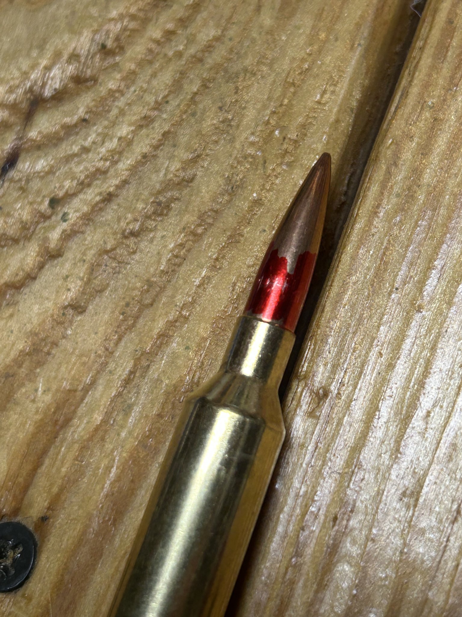

Neither of the firing pin tips are broke or chipped. I tried the old bolt and the pin will fall when ran hard. What are the chances I have something going on in my chamber? I have somewhere around 60-80 rounds through the barrel and I’m getting odd scratch marks on the olive of a loaded round. Hope my phone picks it up. Surely there isn’t a carbon ring there already?
Are thr marks all the way around? To me they look like where the bullet will drag on the chamber coming out if you don't hold enter with your finger while extracting it. If the bullets are jammed into the rifling you can get peirced primers. It will usually leave marks all the way around where the rifling contacts the bullet.
Reactions: Rob01
Doesn’t look like lands to me. I’ll find them when I load develop a new bullet and this doesn’t look like that. I did keep my finger on the round when chambering. I’ve done three and the all look the same.
