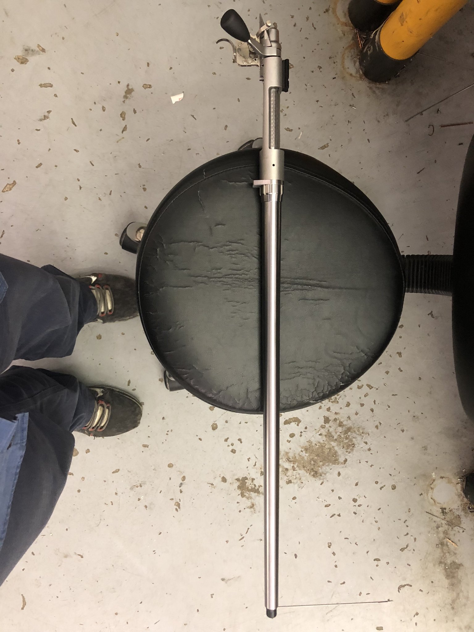

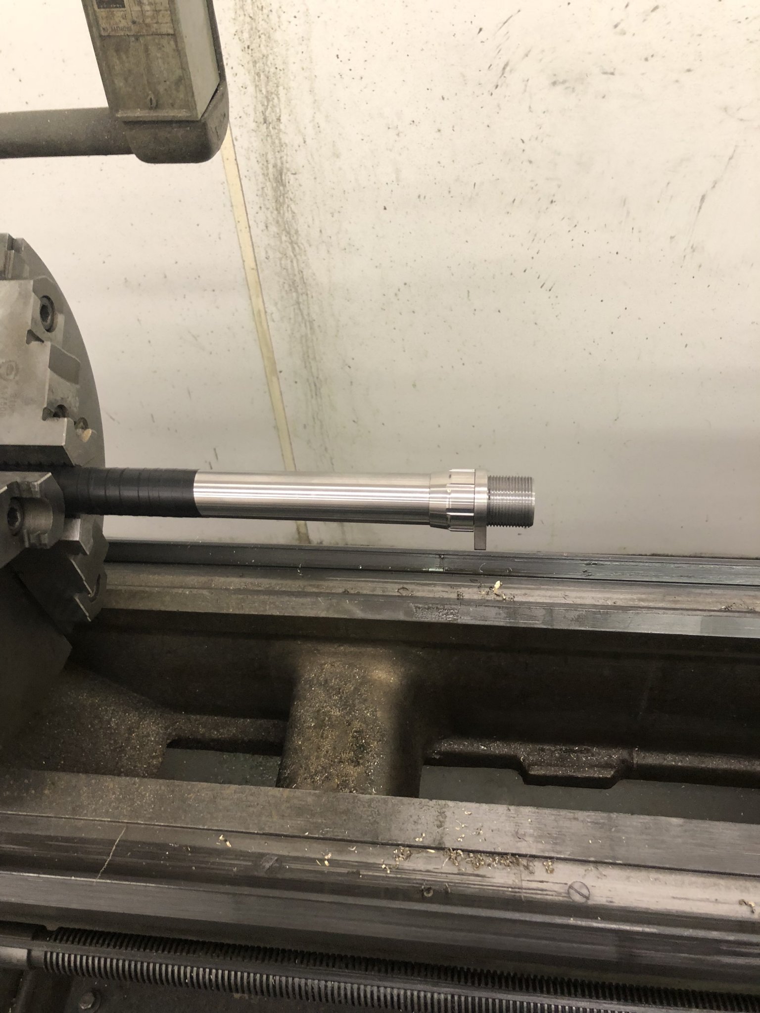

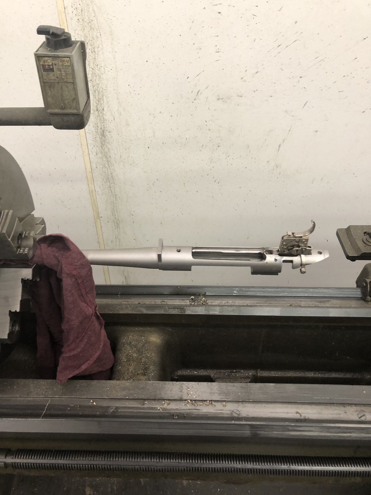

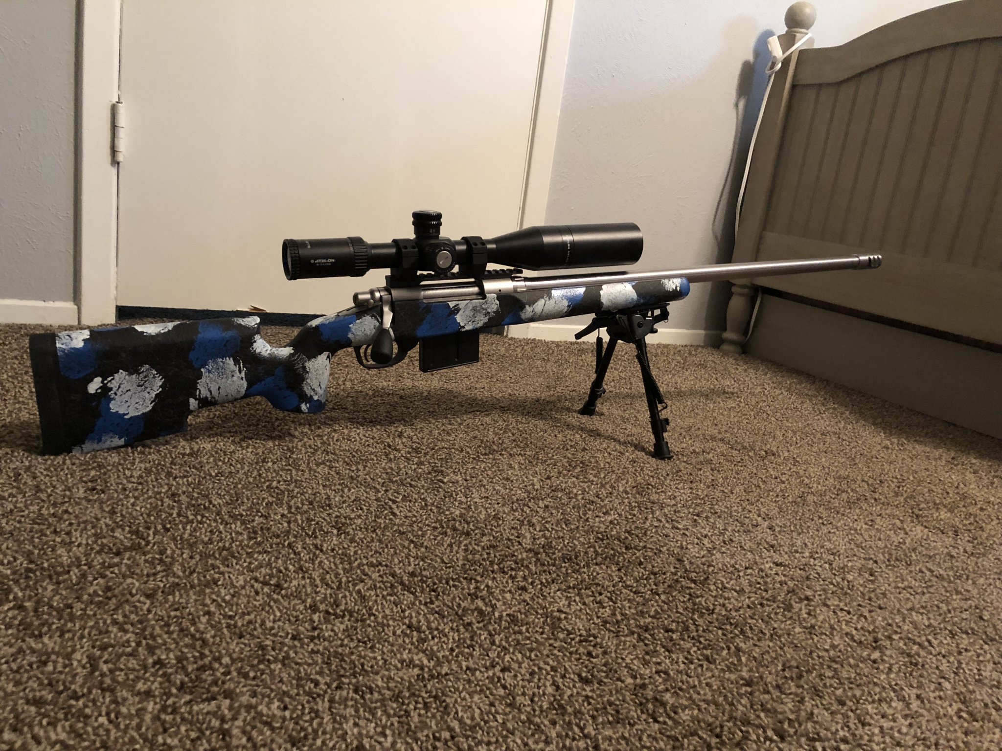

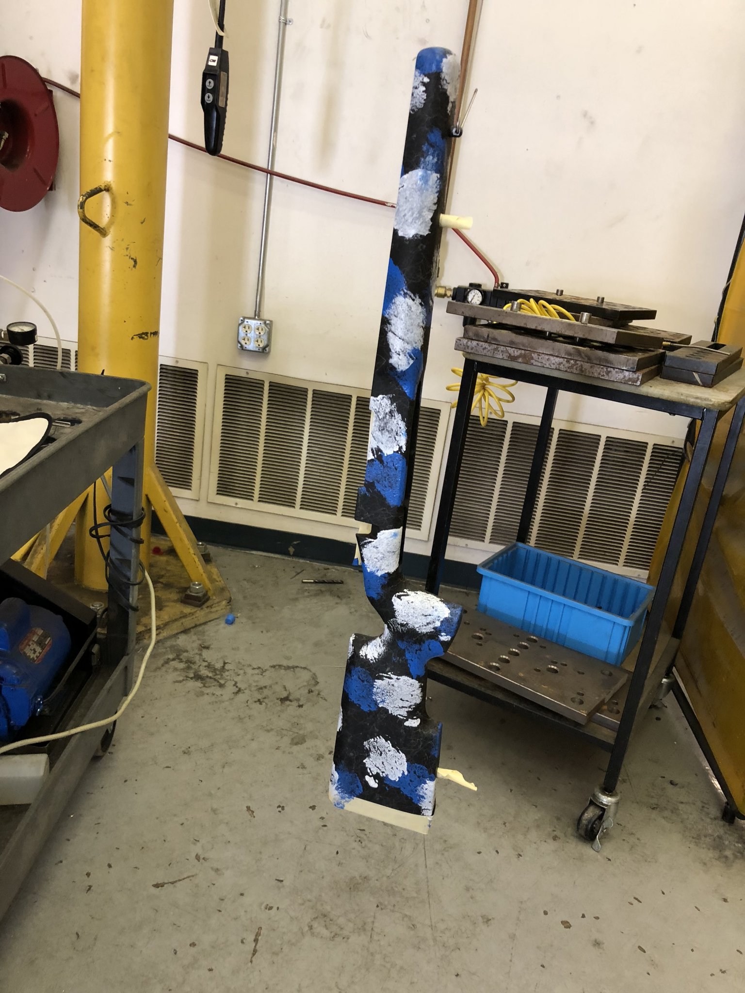

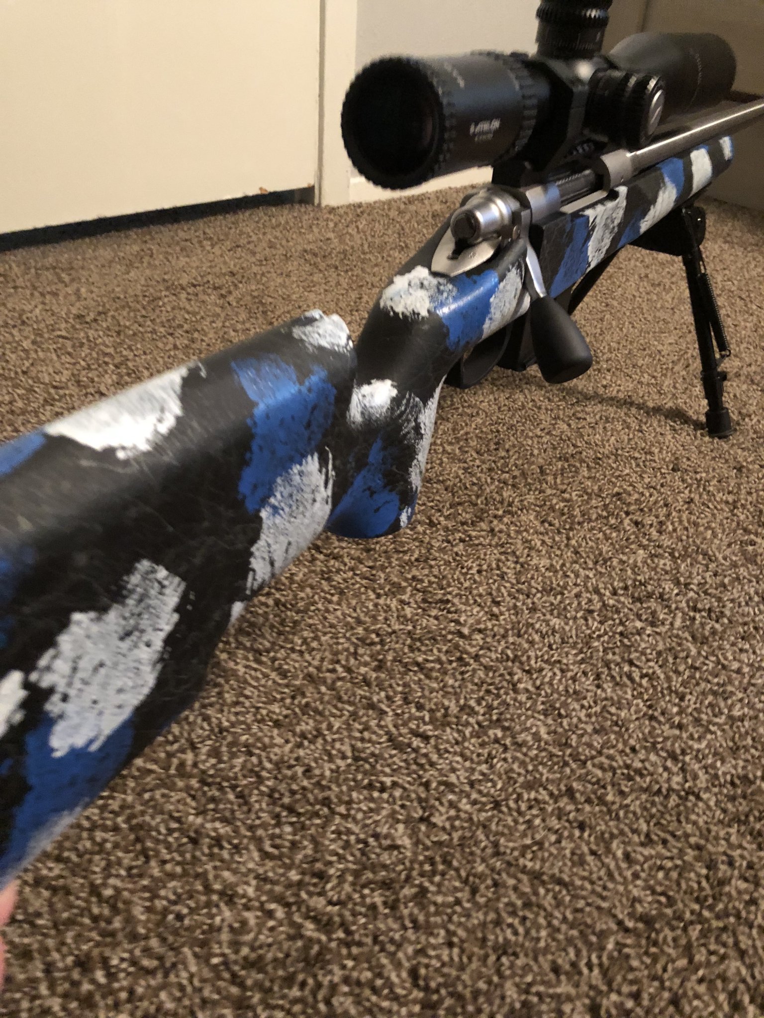

Just finished my remage project i started for fun. I had a Remington 700 adl in 270 sitting around that i never shot so i wanted to convert it to a remage that i could practice with and also because i like to tinker. I came across an xcaliber select match 26” in 6mm creedmoor for a steal so i grabbed that. Got it installed on the action. Put a badger knob on. It sits in a Grayboe Renegade that i painted and has badger ordnance m24a2 bottom metal for short action mags. I also have a long action bottom metal in case i want to switch it up. Has a piercision muscle brake, seekins 20 moa base. Still shopping around for a trigger.
This was my very first. I’m normally an ar guy. It was really really easy. The hardest part was getting the factory barrel off. I didn’t buy a barrel vise i was gonna make one in my shop but never did. Just used a vice. Other than that it was easy.

I have a rem 700 in a Renegade I’m thinking of doing this to, any issues with the barrel nut fitting? Doesn’t seem so.
I’m also curious, where did you get your remage barrel nut and did you use original recoil lug or get a new one of those as well?

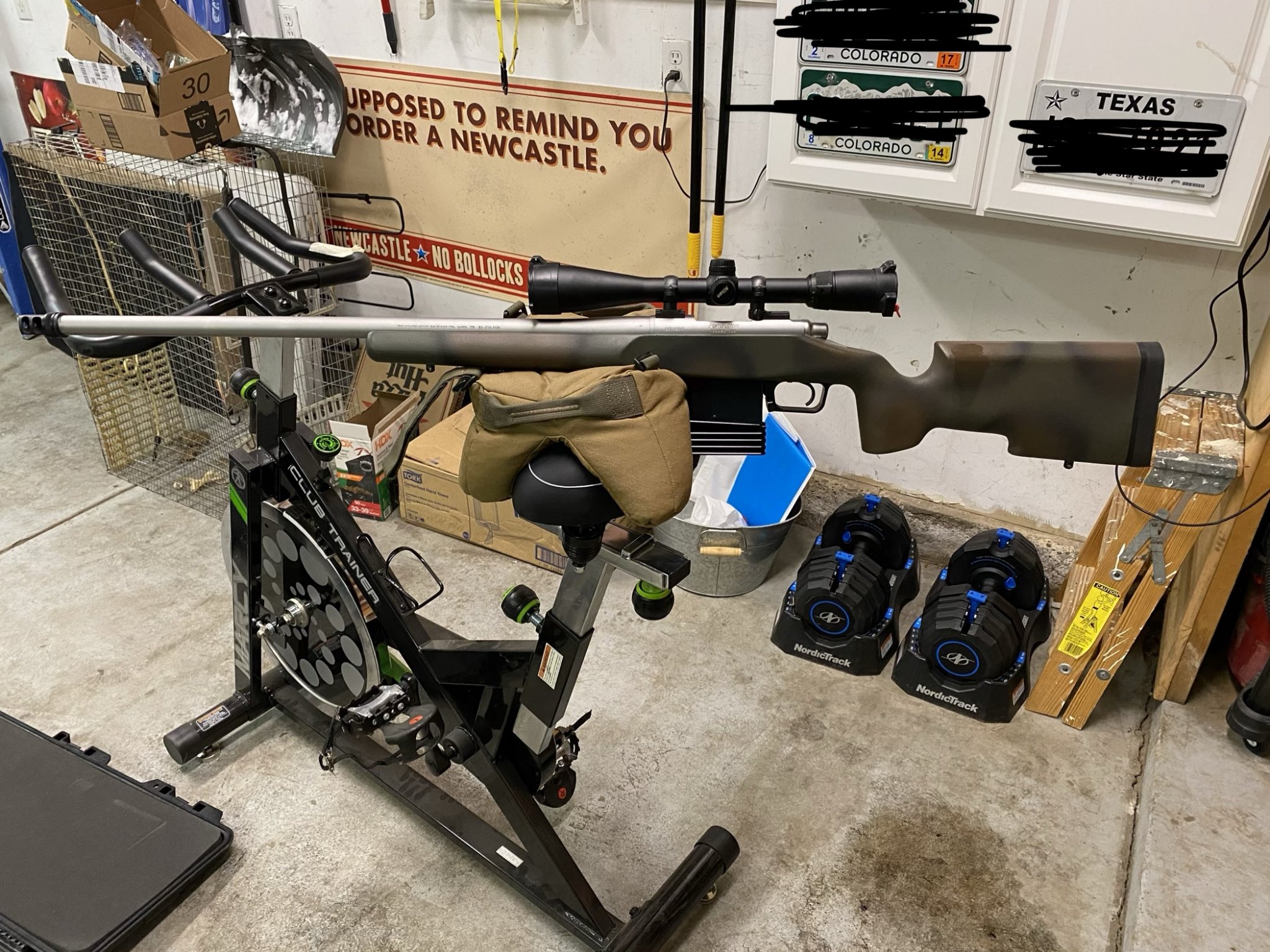

my rifle currently
Just finished my remage project i started for fun. I had a Remington 700 adl in 270 sitting around that i never shot so i wanted to convert it to a remage that i could practice with and also because i like to tinker. I came across an xcaliber select match 26” in 6mm creedmoor for a steal so i grabbed that. Got it installed on the action. Put a badger knob on. It sits in a Grayboe Renegade that i painted and has badger ordnance m24a2 bottom metal for short action mags. I also have a long action bottom metal in case i want to switch it up. Has a piercision muscle brake, seekins 20 moa base. Still shopping around for a trigger. View attachment 6918211View attachment 6918212View attachment 6918213View attachment 6918214View attachment 6918215View attachment 6918216

my rifle currently
Mine fit, it probably depends on what barrel nut you have.
Contact James at Northland shooters supply. The are experts for Savage and Remage rifles. They have barrels, tools, actions and all the little bits for a build. On top of that they can answer all questions.
