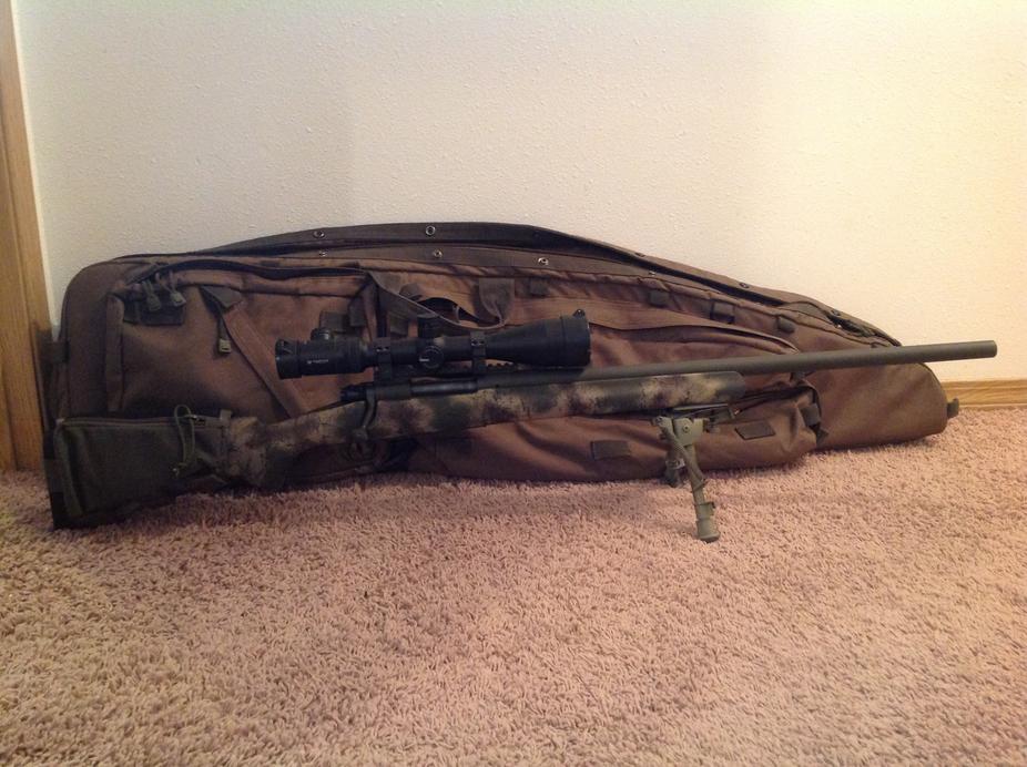

Here's mine...
I don't plan on using anything over 190 grains, may never get over 180...most of my shooting is done with Nosler 168 Ballistic Tips at a modest 2,850 fps...accurate, easy, and it works for my uses (deer hunting)
