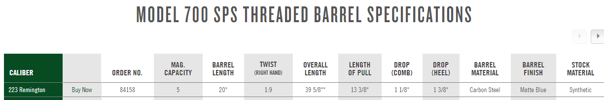

Just going by Remingtons website and what they have on the specs for my particular gun.
If you want specs for your particular gun, you will have to call remington with the serial number. Just because you bought it new, doesn't mean it hasn't been sitting in someones stock room for 10 years. New gun doesn't mean new production.

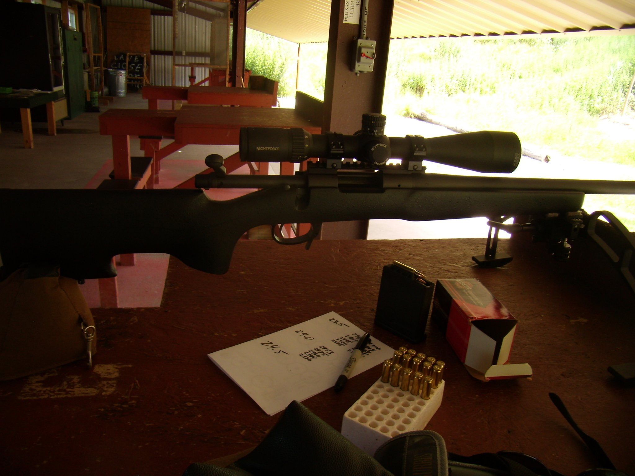

Sorry for the bad pic. Here is my Rem 700, 1/9 varmint barrel, it now rests in a Bell&Carlson stock with PT&G bottom metal. It is most likely to be a 1/9 twist barrel because my first load with 69g SMK shot a 3/4" group (5 shot), the second went about 1 1/4", the third went under 1/2", at 100y.
This is how the rifle came from Bud's
Mike

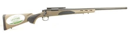

How about the models you guys bought??
Only models that offer 1/9 are the VTR, Tactical and 5r models. Even long ago I believe only the Tactical and 5r had a twist faster than 1/12.
NockHunder's looks like an SPS Varmint if that is the original configuration in the stock photo and it isnt offered in anything but 1/12.
If remington messed up they messed up but its sounding like just a mix up on what models you believe you bought.

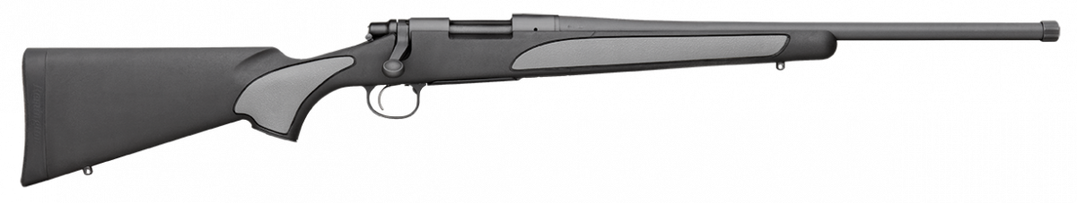

This is the one I bought that measured 1/12. I also had the same one that nockhunter posted a pic of. It shot 69-70's great and even 77s under an inch. It was marketed as 1/9 and measured 1/9.

The mistake was made by remington on their website where it says its 1/9. It wasn't made when they rifled the barrel. In other words, the webpage should say 1/12.

From a gun shop web site:
Our inventory changes rapidly. While we make every attempt to make sure the information on our website is correct, (XXXXXX) will not guarantee that titles, pictures, or descriptions on our site are error free. We reserve the right to cancel any order including but not limited to orders for items with errors in the price or description. In the event that an order is cancelled, we will not charge the customer and we will return funds in full if payment has been sent.
It happens......Otherwise the above would have NEVER been put on their website.
I doubt one person in 1000 who purchases a new, unfired factory rifle checks the twist prior to shooting it. I have never known anyone who did so. And like most here we know some very technical shooters.
Reactions: HeavyAssault
Exactly. Cause on that 1001th time we just believe we are getting exactly what we want....and time and time again we learn a lesson.
Just sayin'.....we double check OAL, grain loads, PSI, etc etc etc.....plenty of times yet a basic check for something we are VERY specific in needing just gets pushed aside in the glory of a new gun purchase.
For the record the weapon pictured above with the Order Number 84158 I cannot find pictured in any printed material until 2016. The 2016 print shows the weapon as posted above with the threaded barrel. I haven't even found/ cross referenced the 84158 in any other research. Even the 2016 printed catalogs doesn't give the Order Number 84158 specs. The only 20" barrel has a Houge Overmolded stock. EDIT: Nevermind...found it.
Have you checked the specs on your new rifle purchases? Land and grove diameter, twist rate, head space, LOP, drop at comb and heal, weight, barrel taper, locking lug engagement, primary and secondary cocking rates, bedding of recoil lug, receiver true to spec, firing pin protrusion, firing pin hole diameter, sear engagement, spring clearence inside bore of bolt etc. on every new rifle you have ever purchased? Prior to shooting? Wow, you must have time on your hands.
If so you are one unique man.
