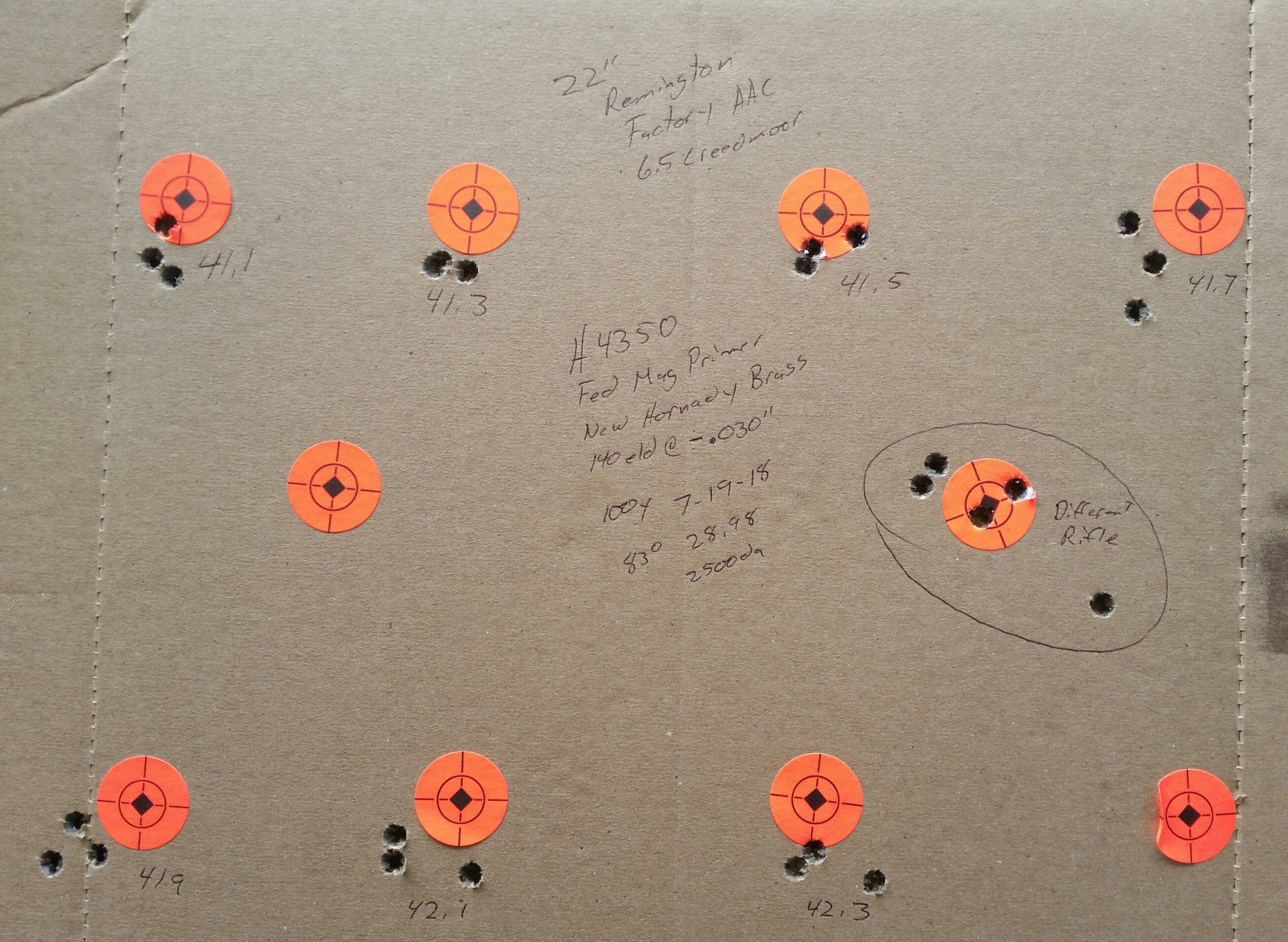

Mine shows promise... 100 yards and 1" dots.
Man, no disrespect, but that’s not what I’d call a shooter with hand loads. I get that you’re going to work seating next.
I’ve shot or been around plenty of older SPS in 308 that could shoot 1/2 and a few groups better with hand loads.
This is why Tikka and Ruger are so popular. Booth will shoot factor loads better than what the three of us are seeing and with hand loads even better.
Also, the best 3 round work up looks to be running very slow. Most people I know as well as myself are running around 42.5 H4350 in our 6.5s with 140s. Most want the speed to maximize the BC.

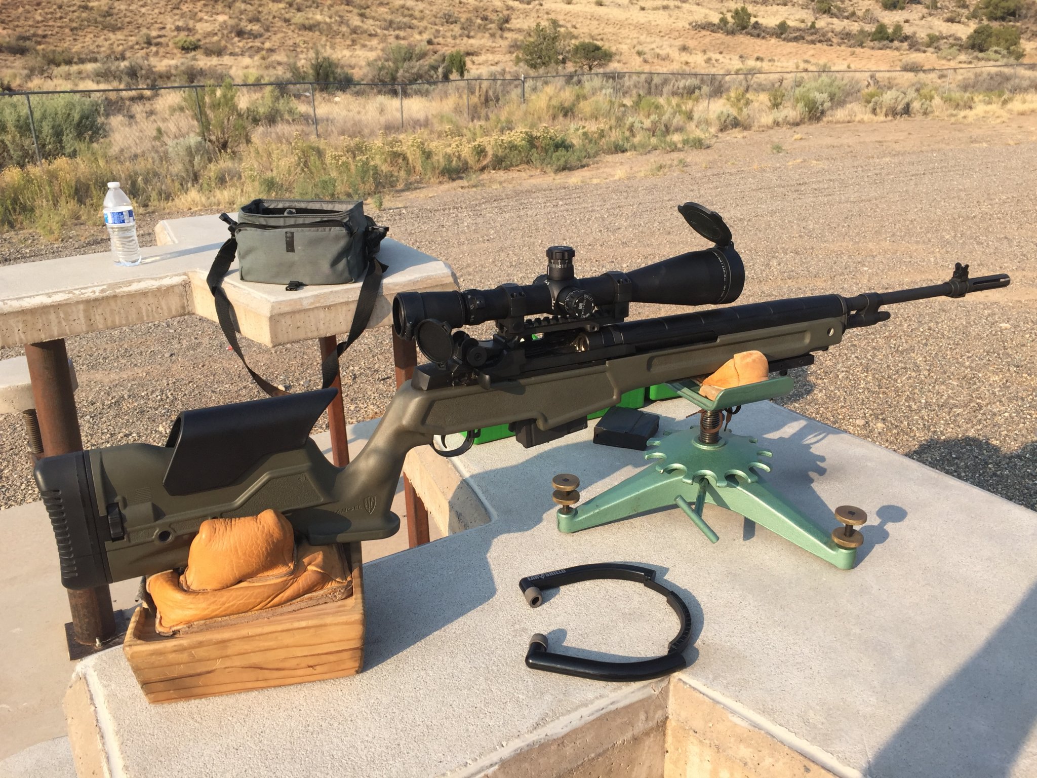

Restocked my m1a with an archangels stock last week and reservoir scope. Have been a 308 junky all my life. Wish know I would have bought a action and chambered in 308 with a 20 in barrel instead of the Creedmoor but I Will make a shooter out of it as long as I m above ground. Have fun and be safe around the mickys
