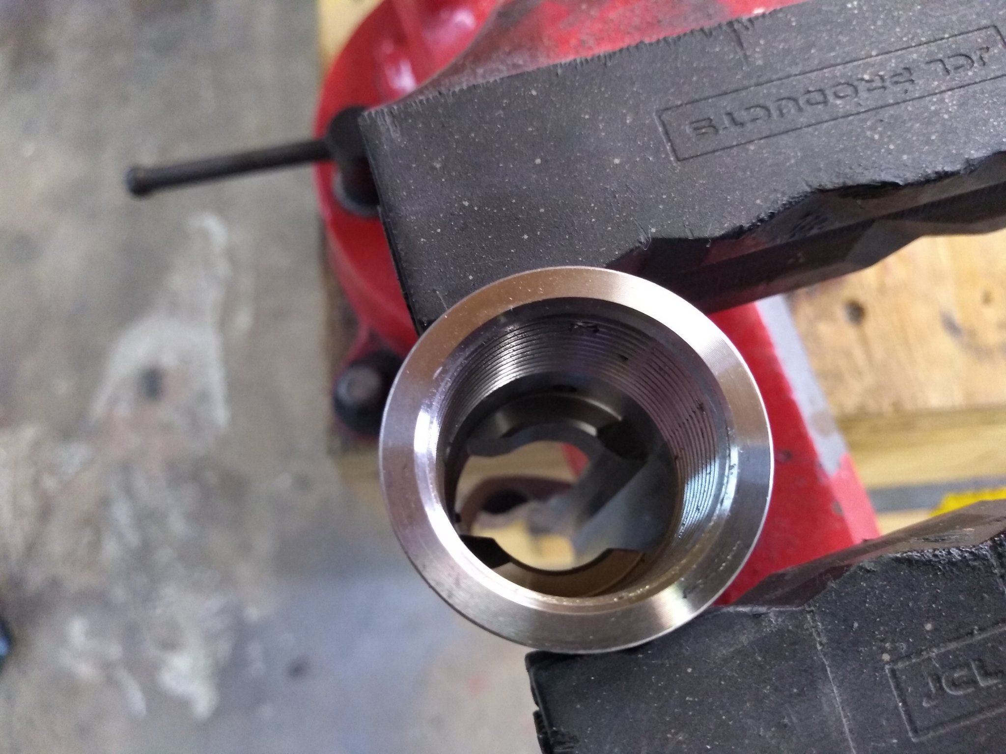

    It had been a couple years since I got a new Remington 700 action to do a build for a customer. I noticed a couple small changes on the action I have not observed on any previous generation Remington 700.
    One change is in the front of the mag well where they notched it farther forward to clear the tips of rounds fed from an AICS mag. This used to be a common modification that I have had to do to several actions when someone dropped it into a chassis or stock using AICS mags. Looks like they finally made the change. Nice to see.
    The second change is on the action face. I generally would see marks on the action face like it had been ground in a surface grinder to flatten it. Those action faces were almost never close to true and I'm guessing because their fixture in the surface grinder referenced off external dimensions rather than external. The change I noticed is radial turning marks on the face of this new action. This was like this straight out of the box from Remington (pictured). The picture is not the greatest, but if you zoom in and look close to the edges of the light glare you can clearly see turning marks. I have not checked to see if it is closer to true, but I find it interesting that a change was made in the manufacturing, hopefully for the better.

    Noticed this today the changes must have been pretty recent . With the action in the lathe the face and lugs were square I put the rod back in thinking it come outta square in the jig.

    Mordamer, I'm curios how square the face is on that one you pictured? Compared to the old ones anyway. I've seen what your talking about on the older actions I've used and they were consistently unsquare on the ones I've had.

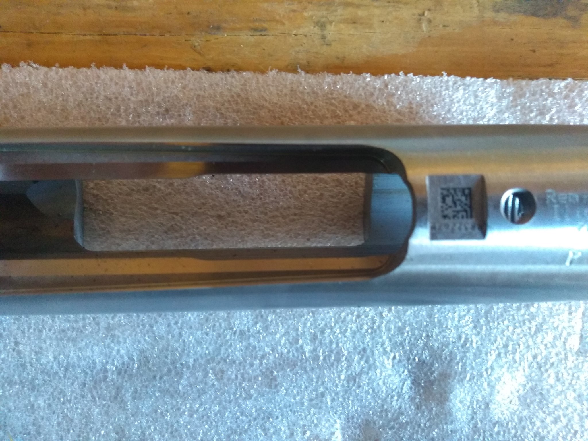

    The newer RR actions (with the barcode) are CNC'd with most of the operations (except threading) done in a single fixturing so most everything is pretty tight: the integral lugs, bolt raceway, face. Where they screw up is moving it to another fixture for thread-milling. I've seen them as much as 0.010 out of round from the other dimensions.

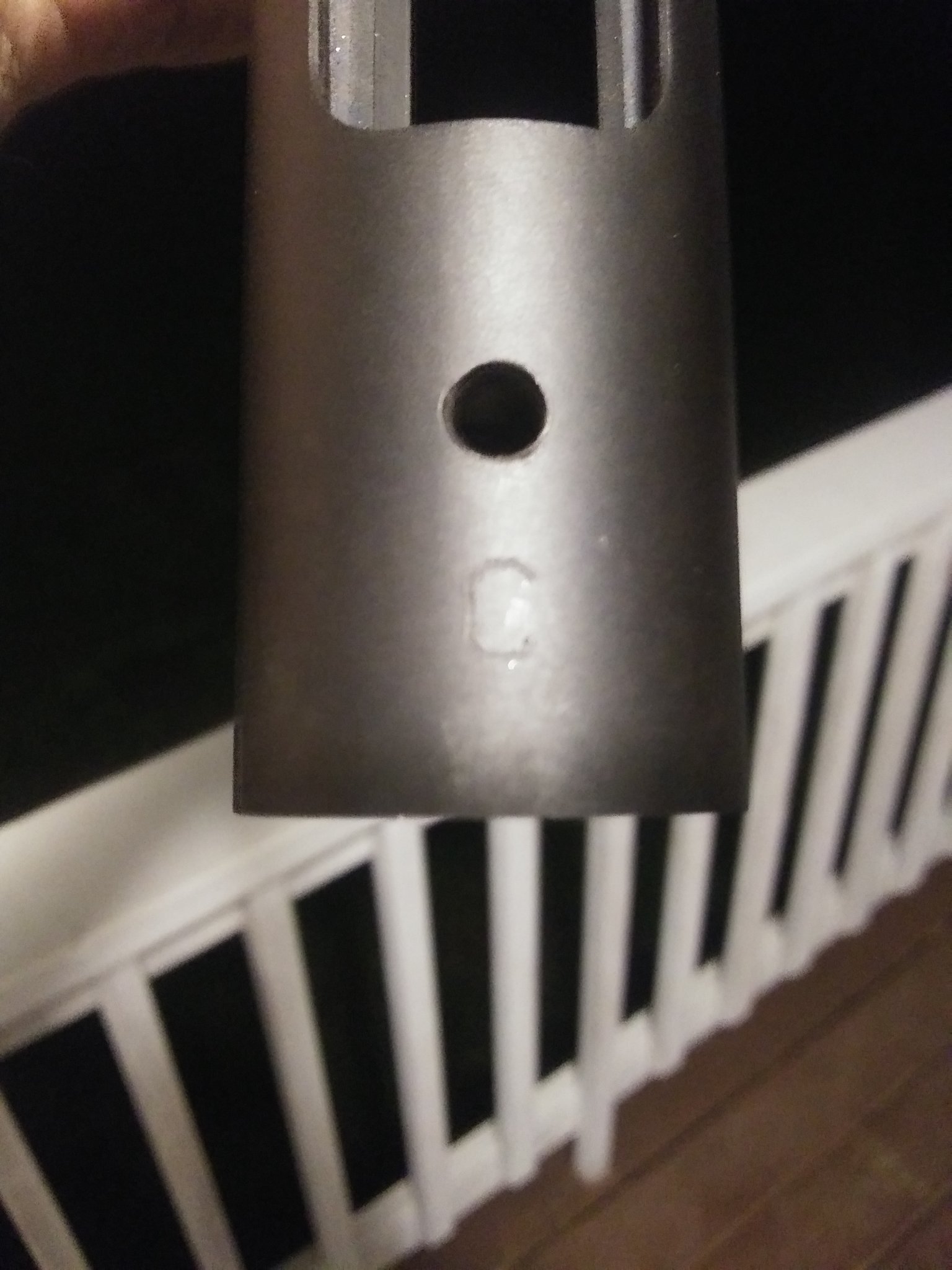

    I'm looking at my RR action I just got, it is a newer action. Beneath the front barrel trunnion area on the bottom of the receiver is an electropenciled "C" engraving.
    I was curious if this was possibly a revision mark or if it is even a significant marking?
    Years ago this signified "custom Shop", and was also on the bottom on the bolt handle. I've seen a few examples like this I've the years, but never in the configuration you are showing.
