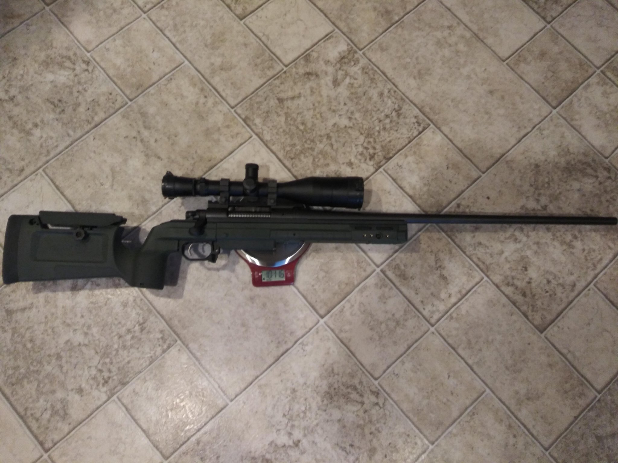

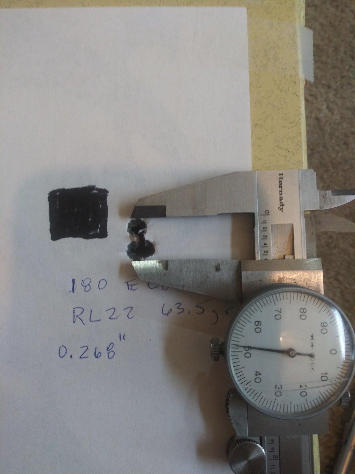

Not a varmint 700, but a new Remarms ADL 7mm RM I stuffed into a KRG Bravo. The Timney Impact non adjustable trigger breaks at 3lbs 12oz. I'm just fire forming the brass and had 32 rounds down the tube with the three round group.
View attachment 8377662View attachment 8377663

I have some Staball HD but wasn't too concerned about the velocities right now. I took that load out to 800 yards this winter at the range. But now BLM lands have ended their hunting seasons and so I'll be testing it out to a mile. I'm having too much fun shooting my 260 AI to get to my 7mm RM.
