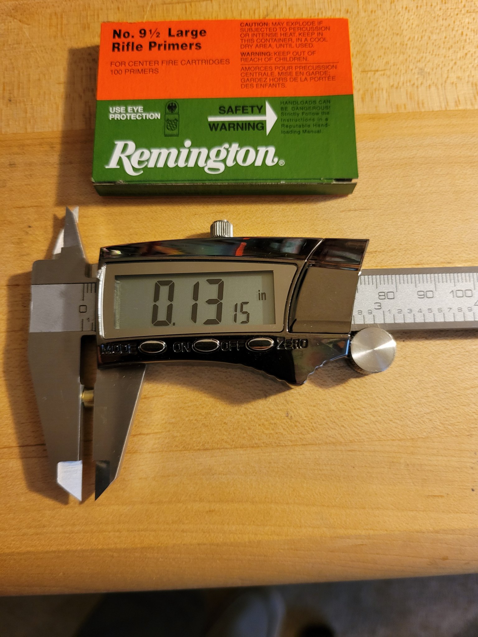

I just bought 1000 Rem 9 1/2 primers for my 22-250 brass. These things are fighting me like a broken zipper. They're very hard to insert. I've tried both Remington and Winchester brass fired through the same rifle. I've tried my old Lee hand primer tool and my RCBS single stage press primer inserter. These bastards are an absolute bear to insert. I've reloaded this same brass with CCI primers many times years ago with no problem whatsoever. I'm assuming it's me, so what the hell am I doing wrong over here???
Measure them.
I found some CCI 250's LRM primers that I didn't remember I had. The CCI's and the Rem 9 1/2 LR are identical diameter of .211
The height of the primer is where the problem is. CCI's are .125 and the Rem's are .127
What gives? I've never used Rem 9 1/2 LR primers before, but it seems their long rifle primers should fit their own brass in 22-250 but that is not the case.
I guess I'll have to uniform the primer pockets deeper for those Remington primers. I've never had to do that before but those primers were all I could find that weren't of the magnum variety.

Well the problem isn't the diameter, it's the depth. I measured the CCI's at .125 and the Remingtons are .127
CCI's pop right in there perfect, the Remington ones stick up above the base of the case even in their own brass, which I think is pretty stupid. LOL

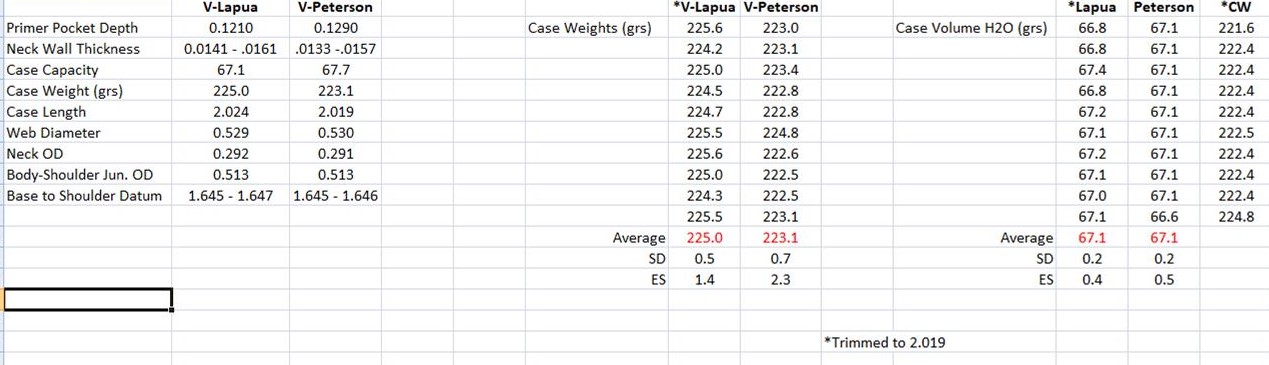

Here's examples of what I have where I measured some of my 6.5 PRC virgin Lapua and virgin Peterson cases and the difference was .008. My primer's heights were significantly different from CCI's .126" to Federal's .128" to Remington's .131".

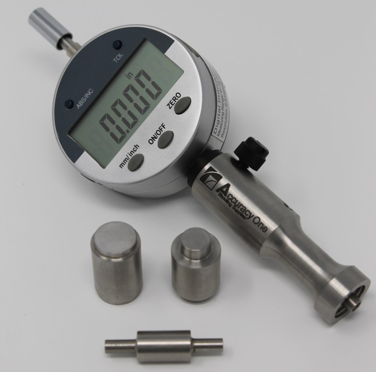

PS: The tool I use to measure pocket depths and primer seating depths is this:
That is some very useful information and thank you for sharing it. It's pretty eye opening. I did measure the CCI primers vs the Remington 9.5's and there was quite a large difference (I have it written down somewhere). There is no doubt that those Rem 9.5's are tall as I witnessed trying to seat those damned things. I run Peterson brass in my 7RM and their volume is definitely smaller than the Federal brass I used to run.

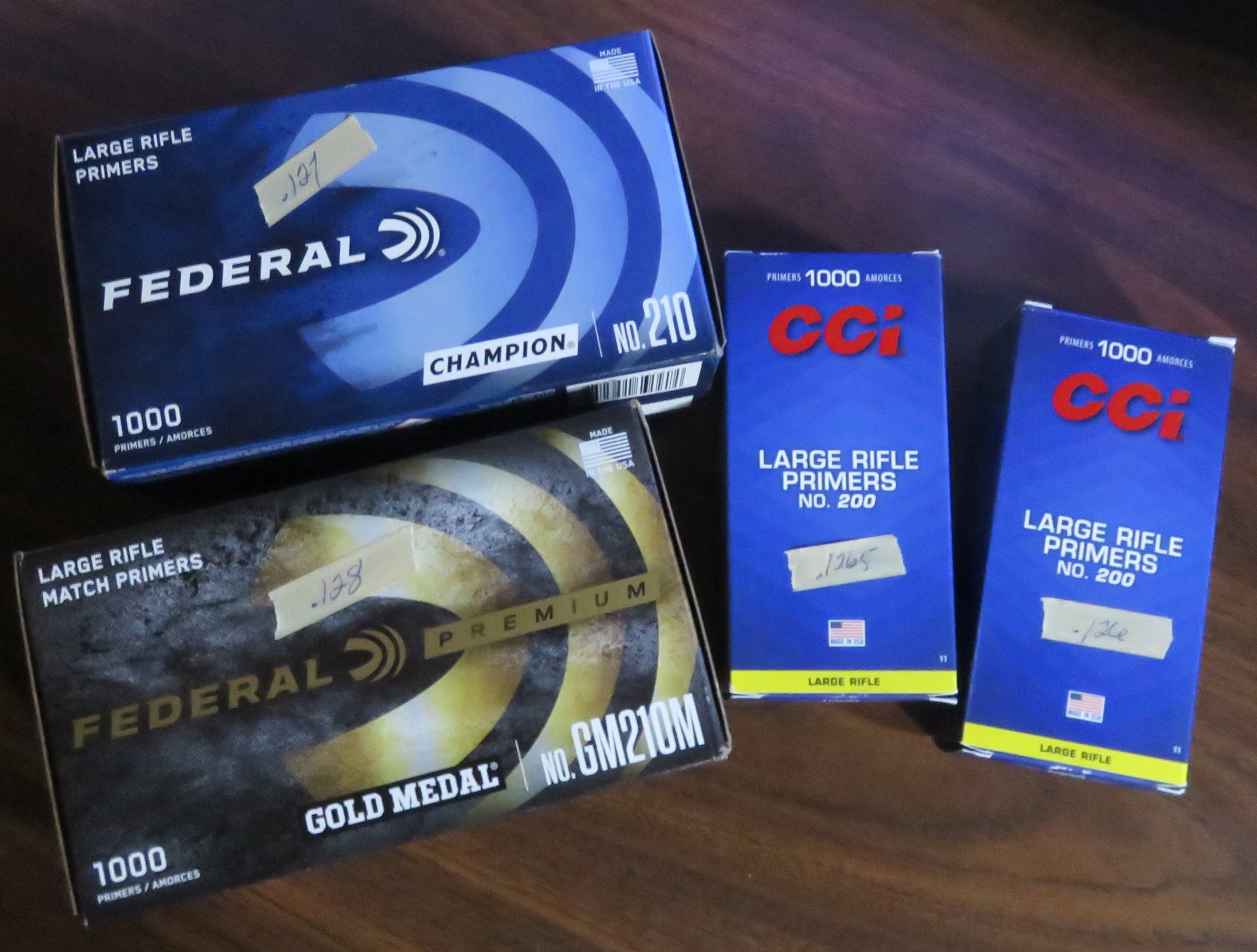

Since those measurements I've taken include how high the anvil is above the cup, you might find the cart below showing cup heights of some interest as it combined with those measurements helps me seat to where I feel I want to be:

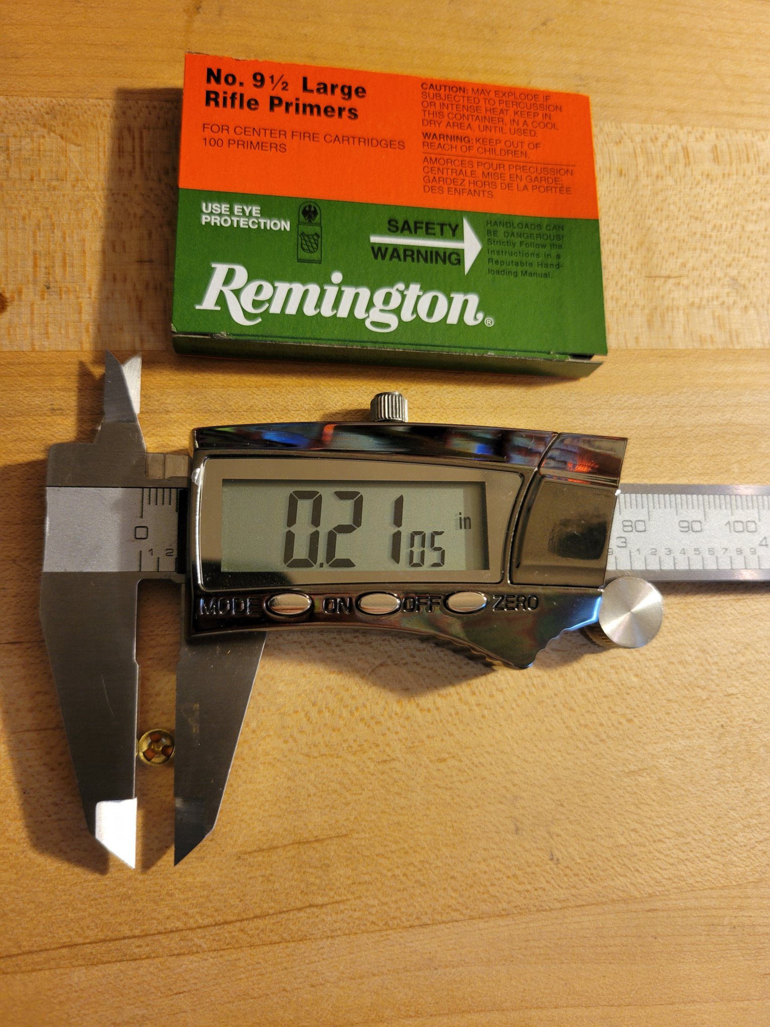

See, here's the problem I'm having with these crappy Remington Primers. I get the same diameter as you, but look at my primer height. See photos.

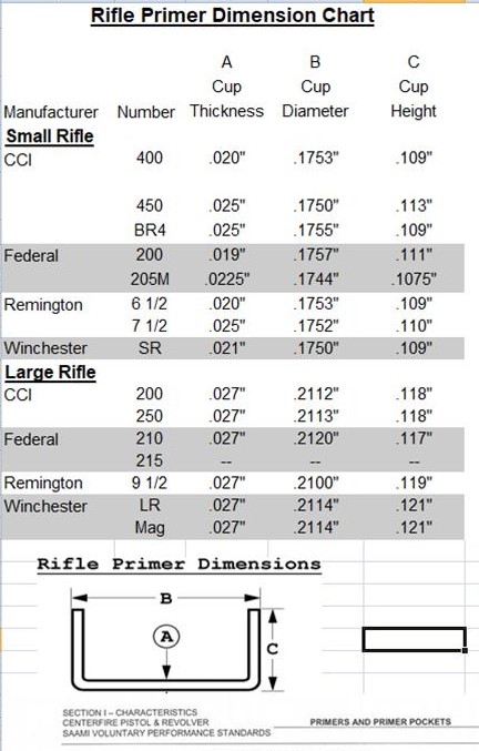

Yeah, your primer height is the same as mine too. Looking at the primer dimension chart, the Rem's primer height is .119 (a hair higher than CCI's and Federal's), which means the anvil is sitting at .012 above the cup. In my Lapua vs Peterson comparison, that .119 is only .002 below flush for Lapua and .010 below flush for the Peterson's. Though I haven't got around to loading any of the Rem 9.5's yet, I suspect and anticipate that it's gong to take a lot of pressure to compress that anvil that far and get them seating .002 below flush (typically, I like to get the cups to at least touching the bottom of the primer pockets).

According to the chart, these things (primers and brass) are just in spec.
