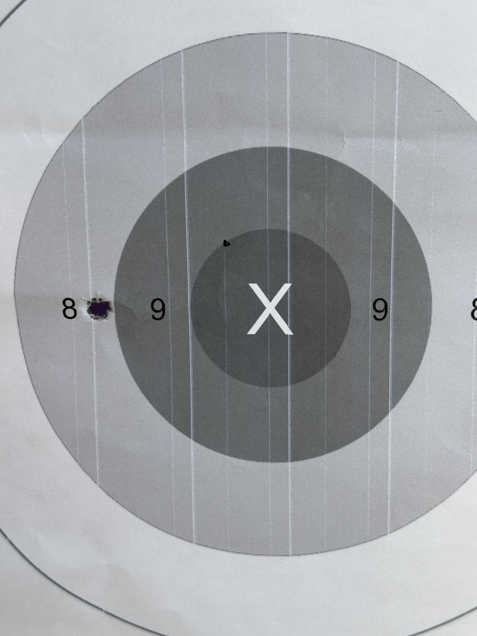

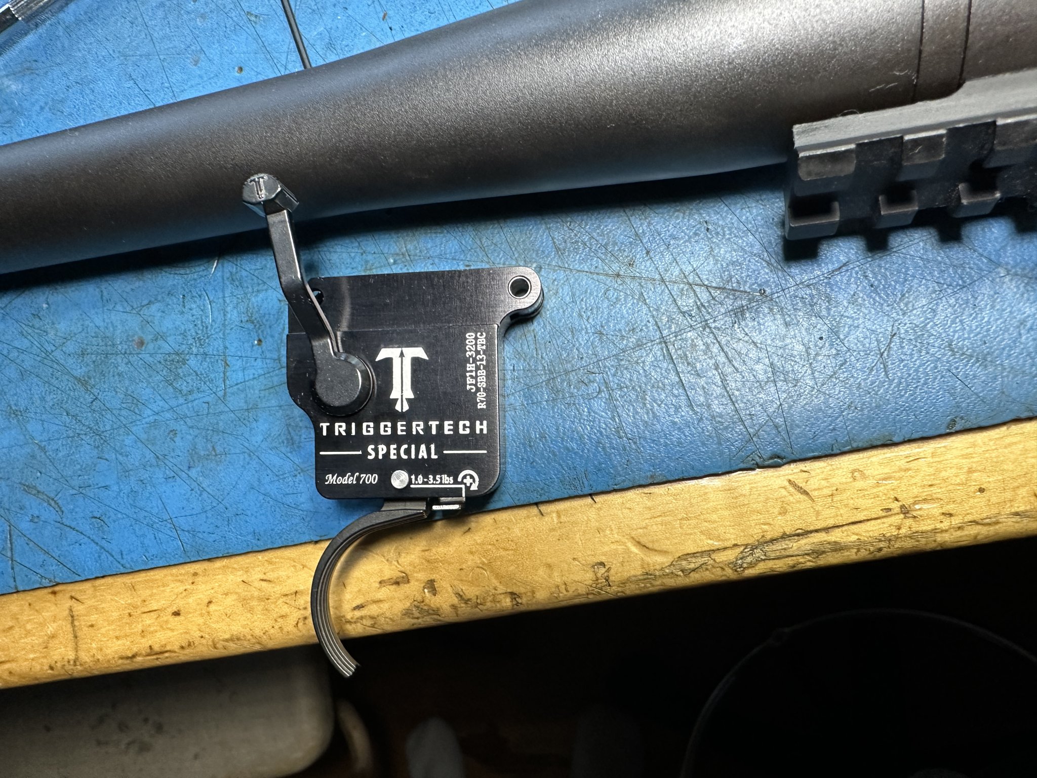

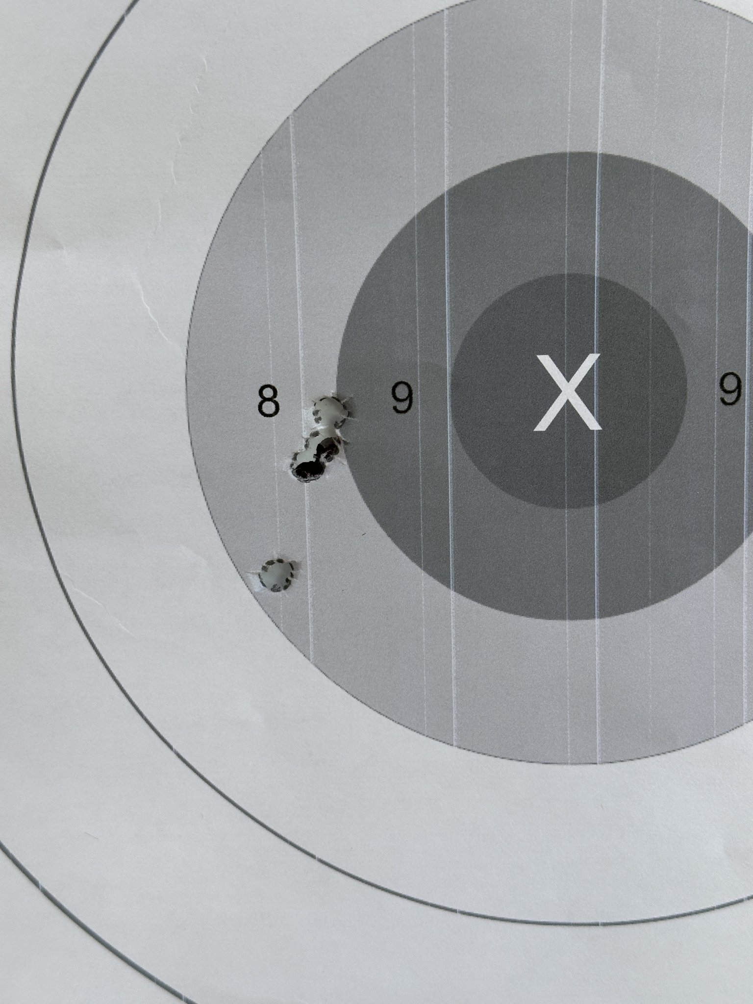

Made scope adjustments and switched to Hornady BLACK ammo 140 HPBT. I recall this ammo doing better in the vanguard as well, but not this well. Obviously I need to adjust back to right a bit. Low shot also went off prematurely. Need to adjust trigger, or just replace. Three shots touching measured 1/4”.
Reactions: Ranchhand
Lastly, my young 9 year old son shot it once. I think he did great! If you reference my last group shot placement, you will notice his shot would have landed right in there touching my three.
TT just arrived. Will install in a bit.

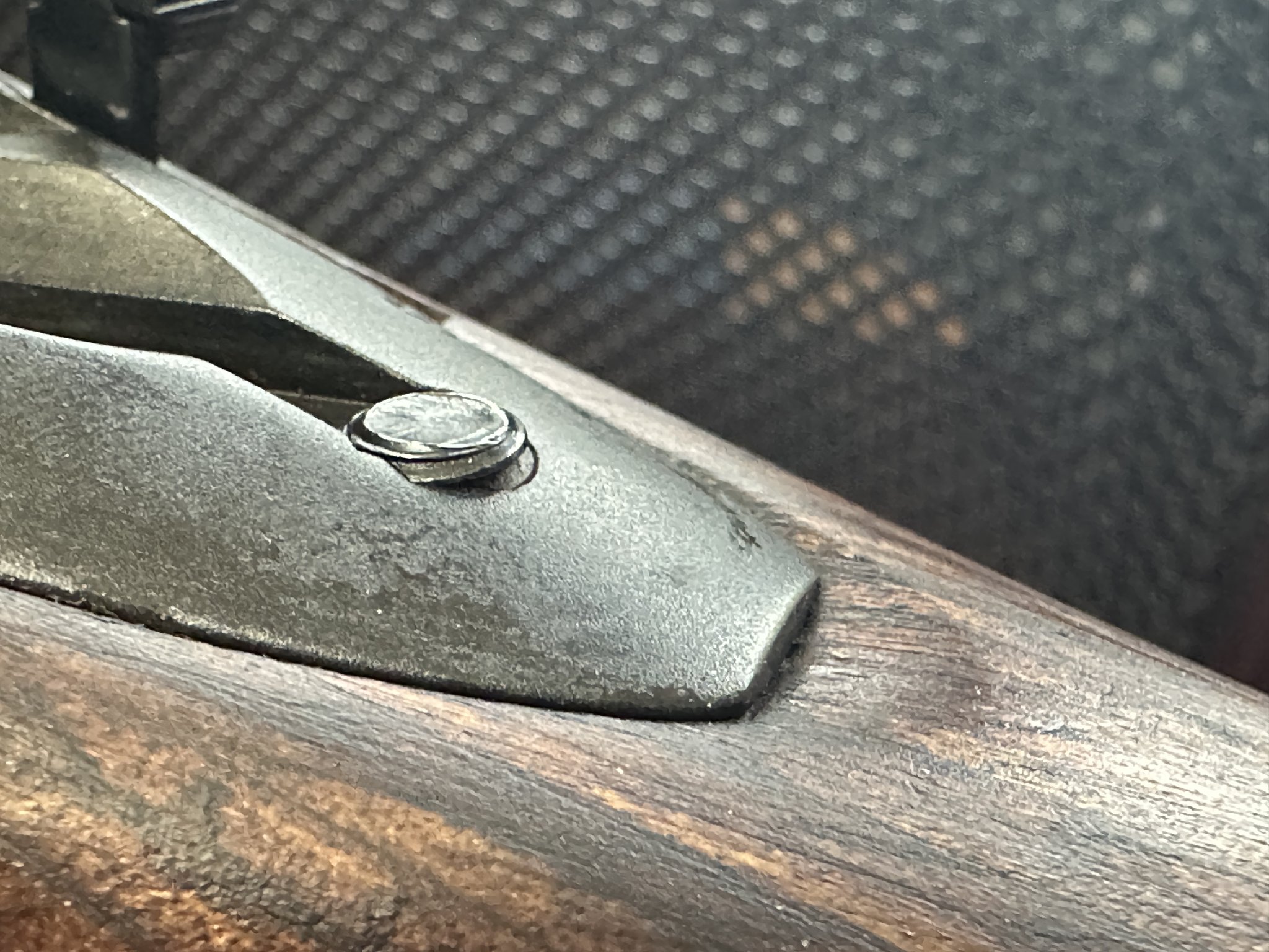

One concern I have is the rear action screw protruding enough to contact bottom of bolt slightly when the bolt is pulled open. This is when tightened to 45 in/lbs.

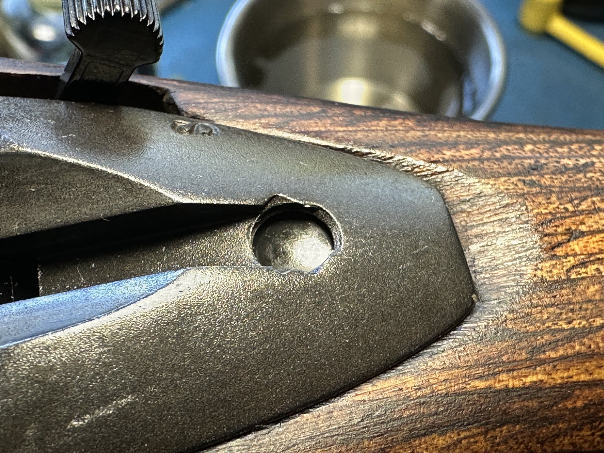

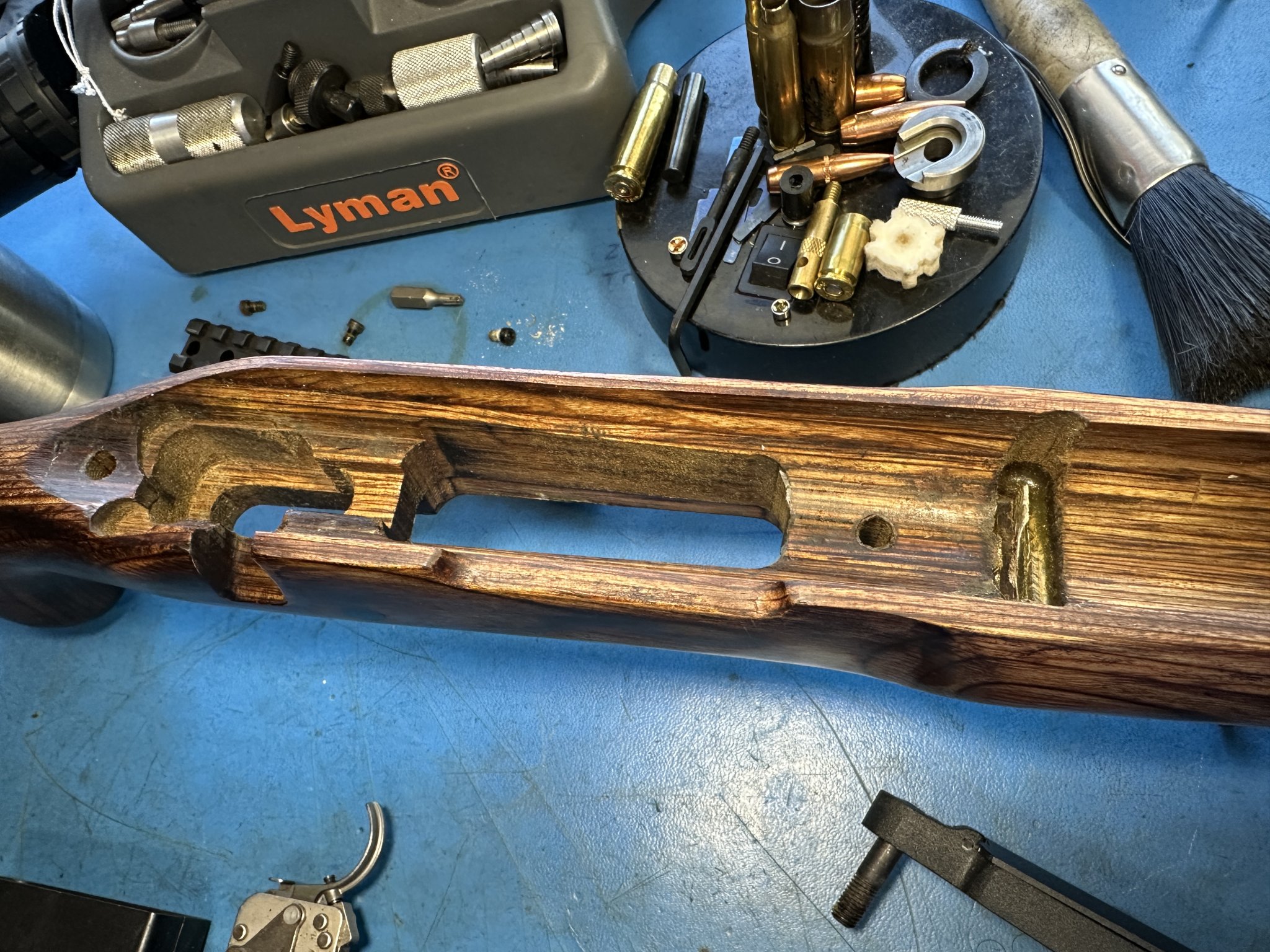

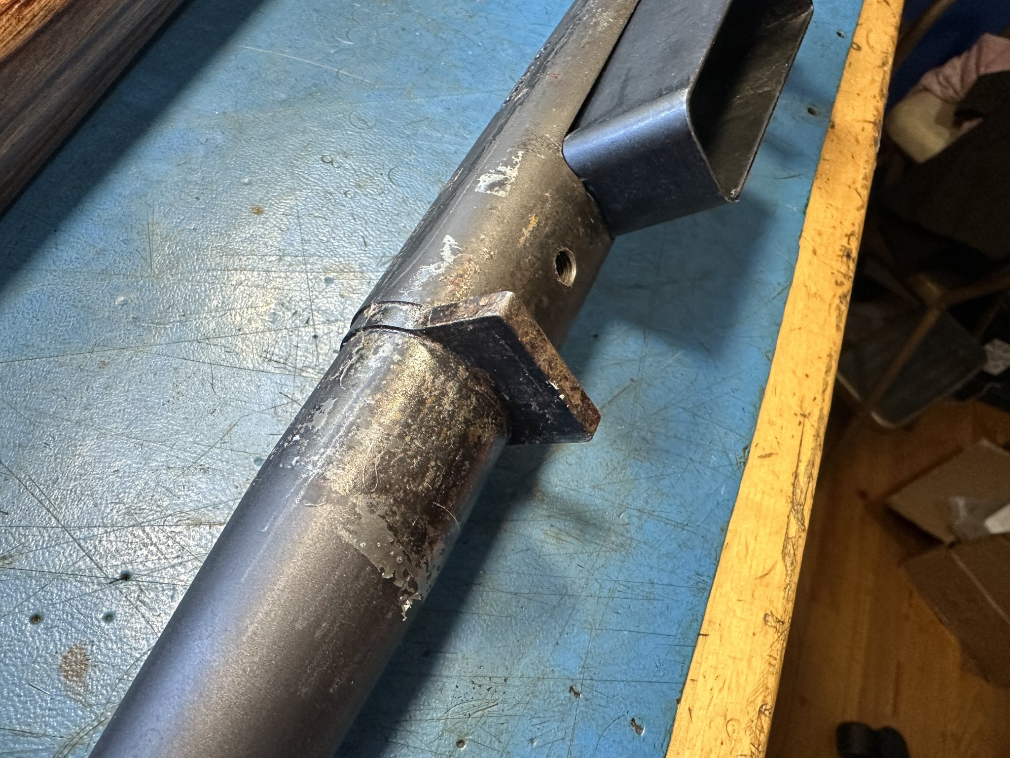

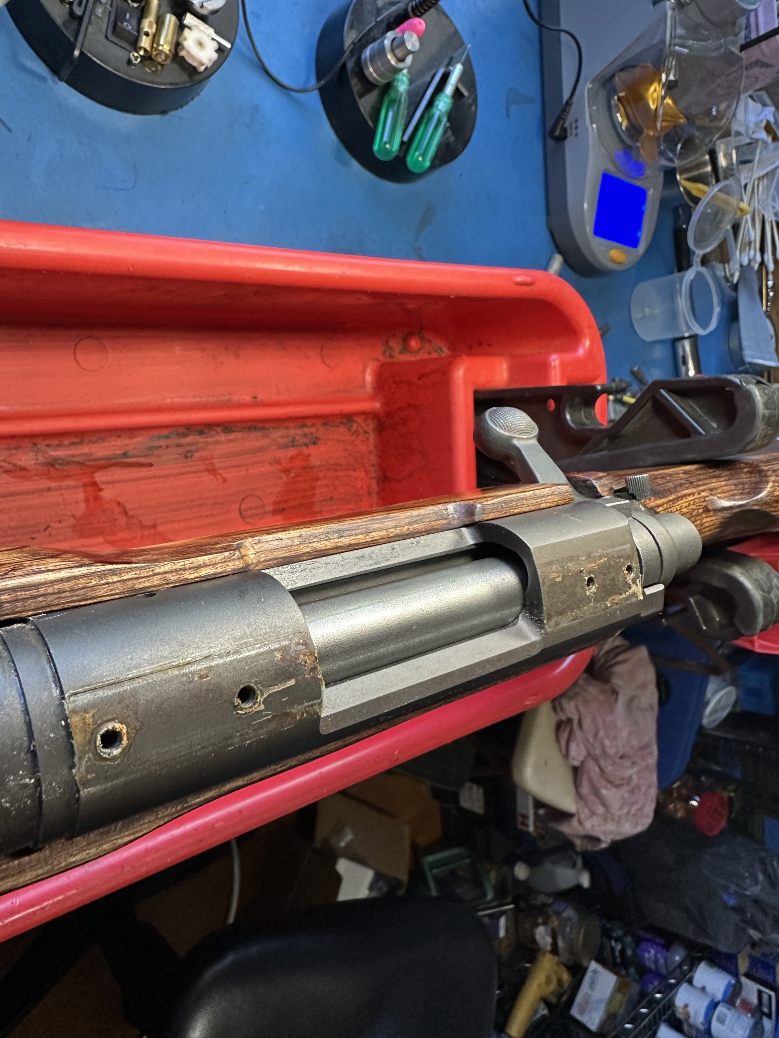

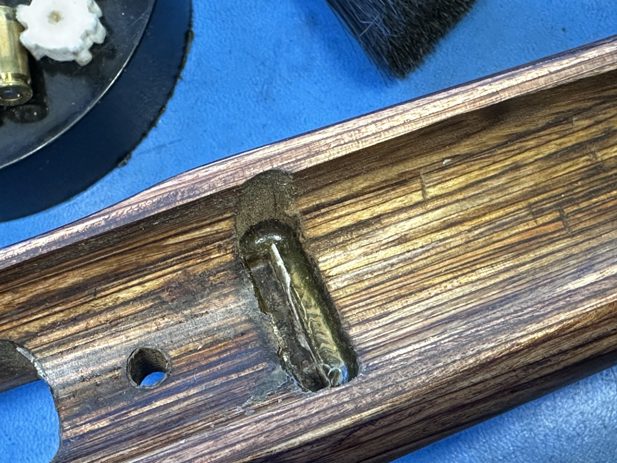

Pulled out of stock and removed top rail. Appears “they” did a pillar bedding. Lots of residue though. Don’t understand it. Even under top rail. Looks like crap but most of it cleaned off after the pictures.

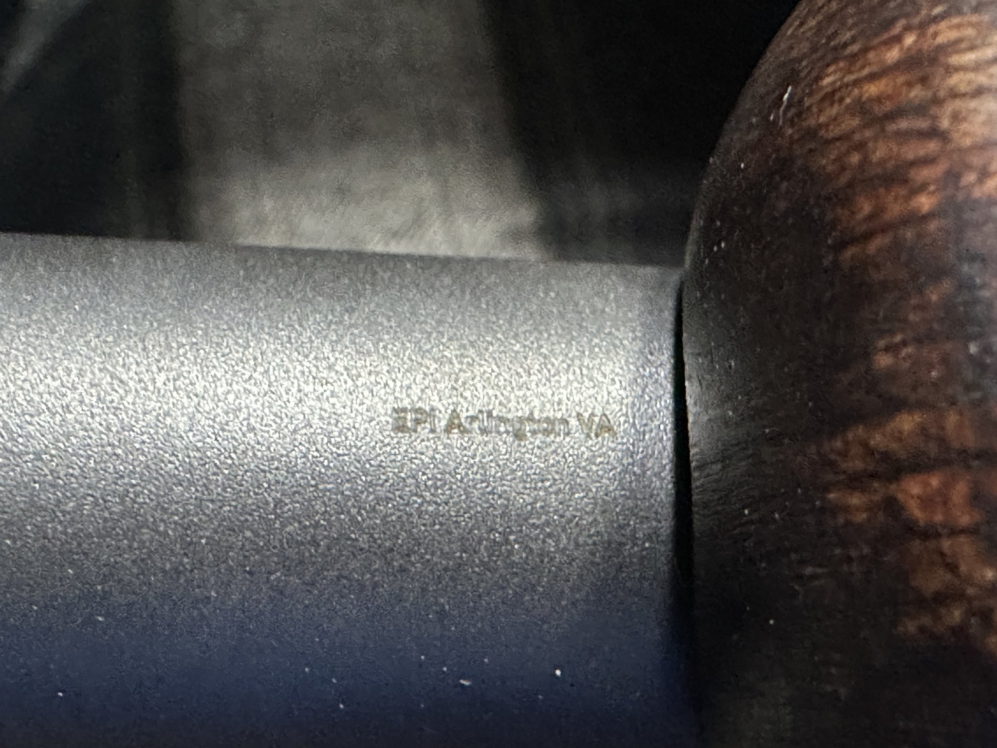

Closer shot of the British proofs.
Is EPI of Arlington VA the barrel maker? Who are they?
EPI is who imported the rifle from Great Britain.
Your rifle was either exported as new to the UK by Remington or imported in as used by a British individual. Either way it had to pass proof at a UK proof house before being sold at retail or released to its private importer.
It had to be reimported into the US and I believe the US importer is required by law to engrave their trade name on the firearm.
pretty obvious this was a gun built in the UK and was just imported by EPI. They did a good job of being minimal with their import mark but its not like this gun has any historical significance.
getting with remington i think will be futile. that action could have been bare or rebarreled. Remington has been sold re-orged so many times, i doubt you'd get any information on a gun built in 2019, but what for? Its not in its original configuration and it doesnt actually matter what it was before.
all that matters is if the gun was built well and it shoots good. I do think its kinda neat its got the british proofs, its not something you see often. but it explains why its been threaded, the Brits have been using moderators more widely than we have for longer. i would double check that barrel thread, highly likely its metric.
Wrong. It was manufactured by Remington and sold at retail in the UK, either as new or second hand.
As soon as the rifle arrived in the UK it went to one of their proof houses (Birmingham in this case). Firearms cannot be sold at retail in the UK unless they pass proof at one of the government proof houses. That applies to all domestic firearms before they leave the manufacturer and to all imported ones regardless if they're new or used.
I believe the only exception that exists is for imported firearms that have already passed proof at another CIP- registered proof house. No such proof houses exist in the US.

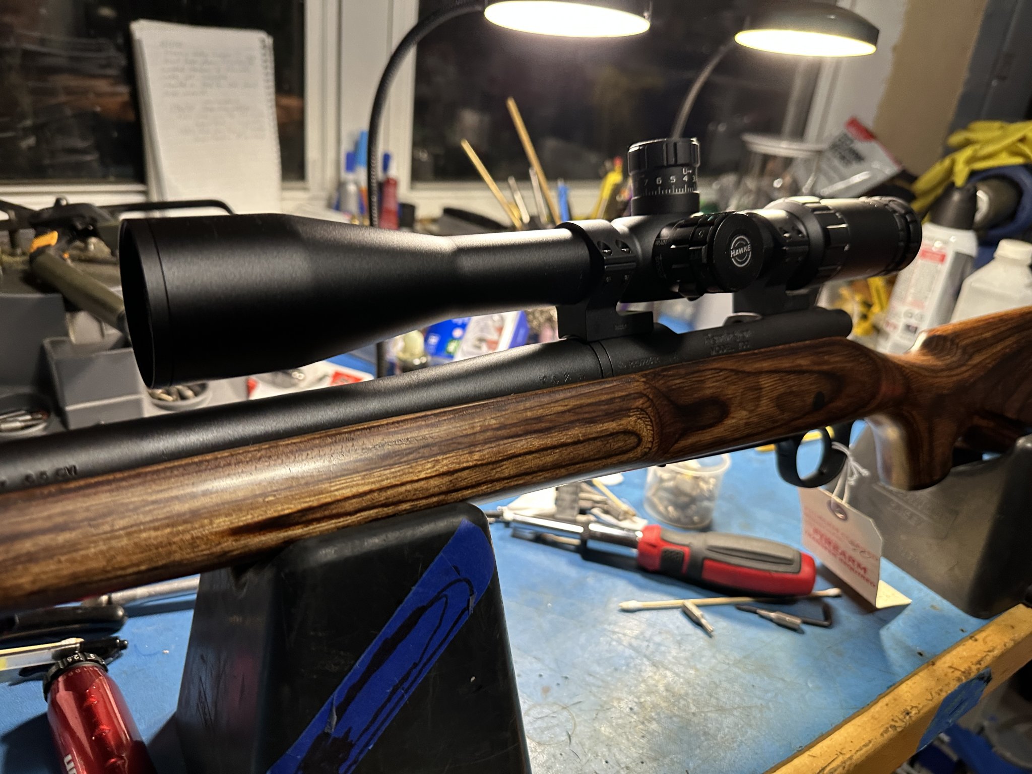

I verified with Tally I have 6-48 threads. I ordered a 20 MOA Medium height 30mm extended ring set. My current Hawke scope has only a 42mm objected, so I hope I didn’t get them too high. I hope to get a bigger better scope eventually and wanted to make sure I had room.
Went to range with an old 1” Simmons 6.5-20x44 mounted on medium high Tally’s. The objective bell is just a hair off the barrel, but it worked.

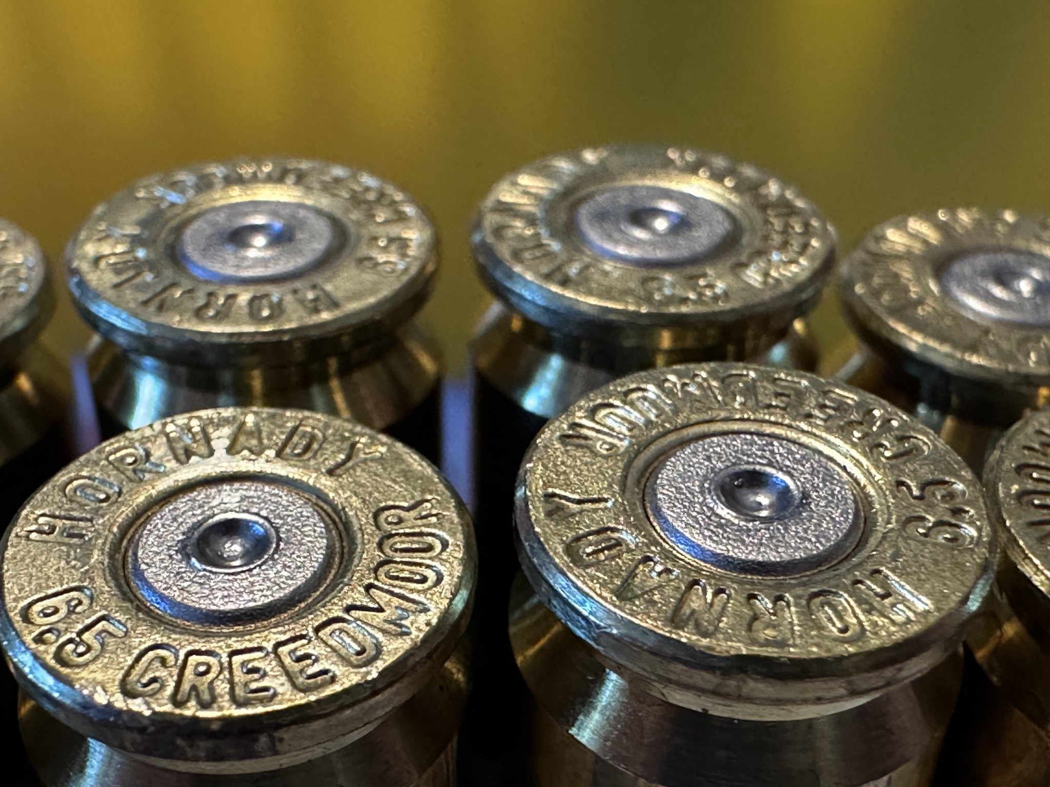

So it was good session. Only thing I noticed that caught my eye was ALL loads had primers that were very slightly cratered, although the primers look perfectly fine otherwise.
