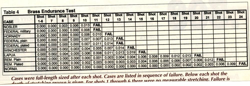

Between the two, Rem vs Win, I've almost always used Win. Then I found this.
As stated above, why not Lapua. And it's also a use what ya can get deal now ain't it.
The chart you posted doesn't specify the caliber. I know Norma makes Nosler in several different chamberings. The chart you posted doesn't show this. Also, in general, Norma/Nosler does not hold up well to hotter loads. The exception is Norma 300 WSM, which IMO is spectacular brass.
[MENTION=56108]1J04[/MENTION]
Could you please provide the source of that data you posted? I know I've come across that before, and seem to recall it came off as pretty legitimate, but I'd like to review the test process/methodology of it.
Pretty easy to skew the results if the test wasn't conducted *very* scientifically.
You bet, I'll try and track down the original article. I printed it out some time ago and have it at home.
Thanks!
I just spent the last ~10 minutes google hunting. Looks like it came from Handloader magazine in 2008 or 2009. I can't find the article on the interwebz, but I can swear I've read it on a computer screen before.
Go to damn near bottom of page. I believe the article was in Handloader #257, but I cannot find the site where you can open it up. Should beable to post it up tonight.
http://www.opticstalk.com/best-varget-loads-for-308-win_topic16874_page2.html
Handloader magazine, they were using a 308... gun used was a TRG, IIRC... and they were trying to duplicated the performance/accuracy of FGMM, again IIRC
great timing on this post since I am looking to get some new .308win brass. It would be invaluable if Handloader or some else was able to redo that testing based off current brass production. I am leaning towards Lapua but open to putting my $ in the right direction, my federal brass is not gonna last very long
