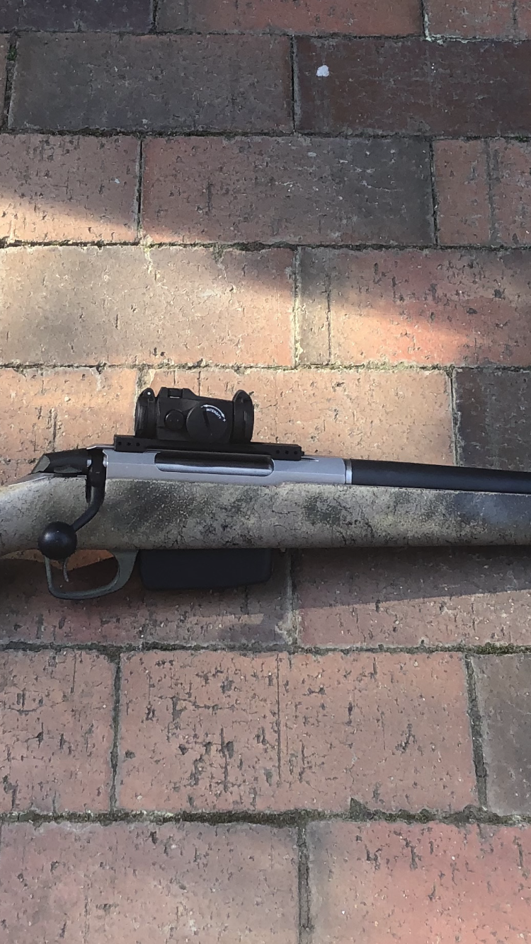

Remove Tikka T3X series rifle factory barrel?
thexman
Dec 24, 2018
331
96
I did some goolging, found couple of options or methods people did:
1. Some can simply use a barrel wise and a (action) wrench with torqued wrench to remove it without too much difficulty if lucky
2. Some would require to have a relief cut to release pressure, then remove it
As a newbie on remove barrel, wonder what gunsmith or I would require to get the job done?
What I can think of to remove the factory barrel:
1.Torque wrench
2.Barrel wise
3.Action wrench
4.Few spanners/wrenches
5.Some spacers
In addition to put new barrel on:
5.Go/no-go gauge
6.New barrel with barrel nut
7.Bespoke wrench

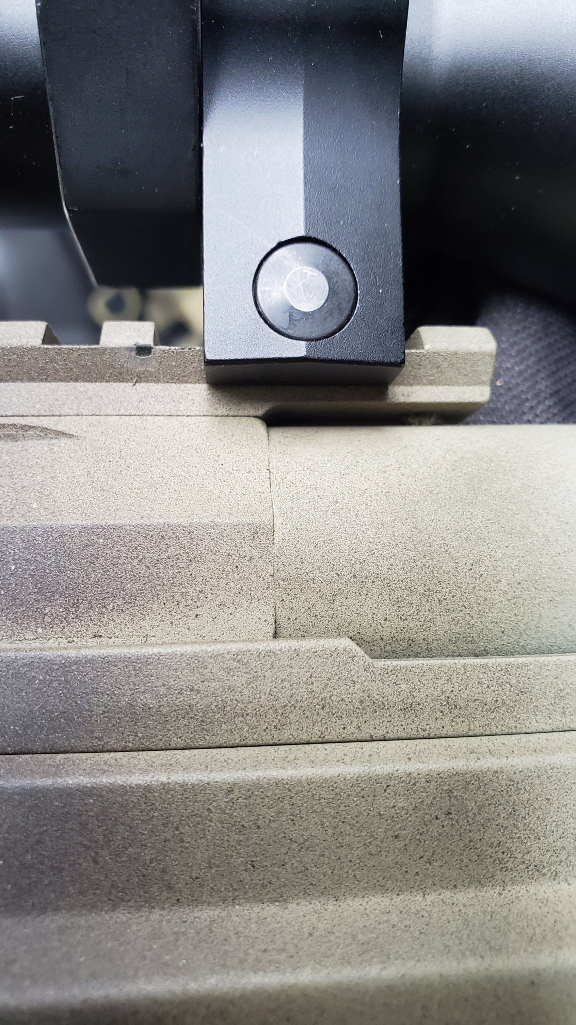

Few photos I took around barrel/action area. There is no barrel nut from factory barrel. Don't think the Bespoke wrench I got with the new barrel from PVA with the new barrel would be useful in this case as there is no barrel nut?
Thank you. Any input would be really appreciated.
7071435
7071436
7071437

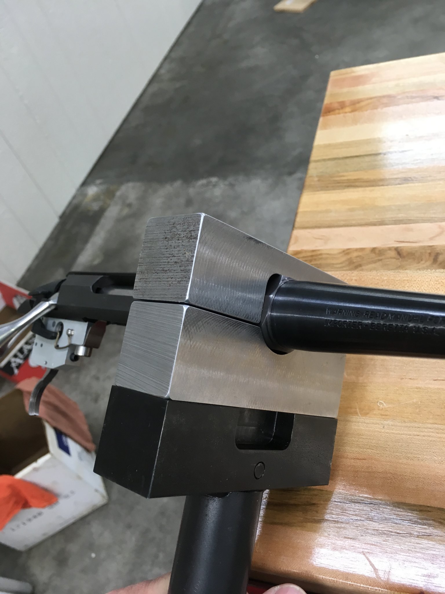

I say this with all of the experience of a person who has removed precisely one factory Tikka barrel... sumbitches are TIGHT. Not threadlocked or otherwise mechanically locked, but simply ridiculously tight.
I was able to remove mine with a barrel vise (Farrell) and a semi-generic action wrench (originally intended for Savage actions; from Northland Shooter's Supply) along with a 3 pound shop hammer and a fair amount of elbow grease and cussing. Something that I didn't do as well as I could have, though, is in regard to pre-treating the barreled action in preparation for barrel removal; what I did do is get the barreled action oriented vertically with the muzzle down, and sprayed some penetrating oil (Liquid Wrench) on the barrel/action interface inside the action. I did this and let it soak for a few days, spraying a little more penetrating oil probably every other day or so. What I could have done better is to use a heat gun to warm the action prior to spraying the penetrating oil. I think that multiple heating/cooling cycles coupled with good penetrating oil might have made it a bit easier.
I'll tell you, though, I wouldn't use a rear-entry action wrench for this task, as I think that you'd be likely to tear up either the action or the wrench (if not both).
If I had to do it again, I'd likely spend more time preparing the barreled action as described above (re: soaking in penetrating oil, heating/cooling cycles) for a couple of weeks in an attempt to get the penetrating oil worked as far down into the tenon threads as possible before clamping the barrel in the vise. Once it was clamped in, though, I think that I'd warm the action one last time (again, with a heat gun rather than a torch), clamp on the (external) action wrench, put on as much preload as I could, and start whacking the handle of the action wrench with that 3 pound shop hammer.

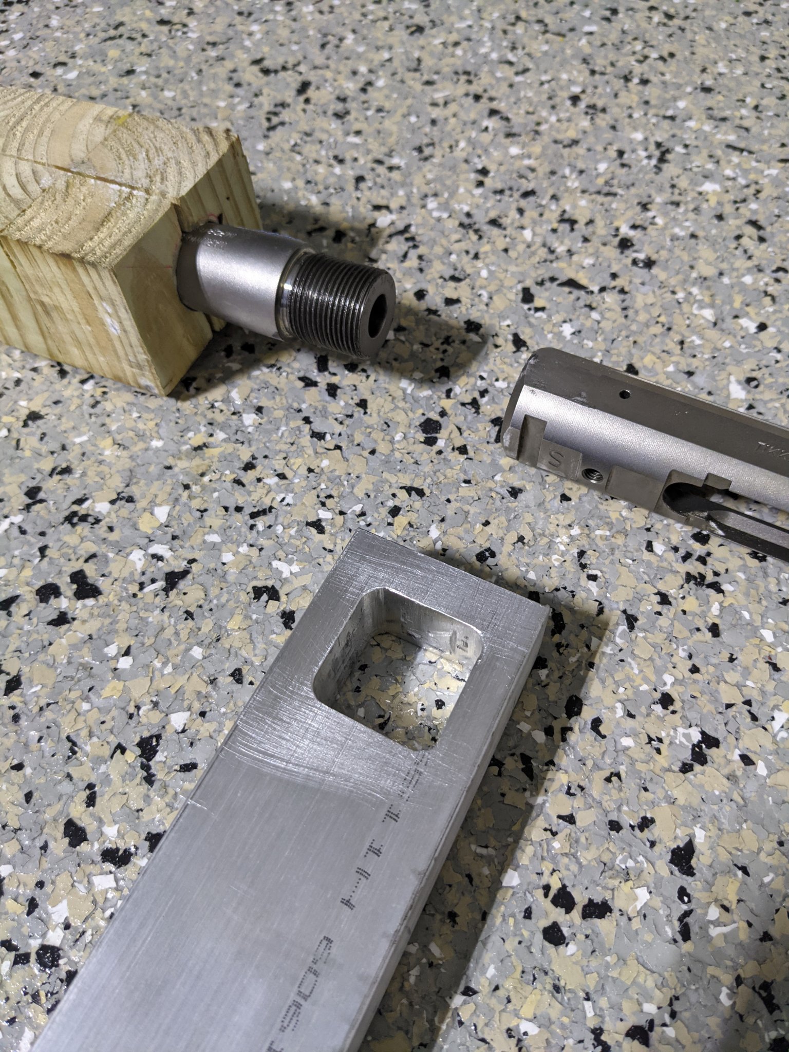

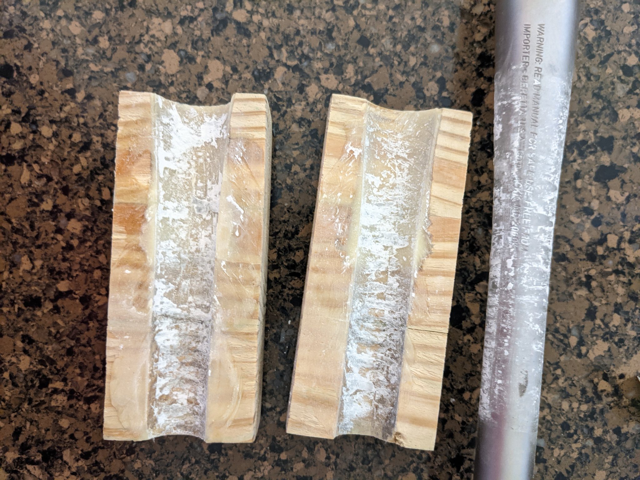

Just removed my Tikka barrel. Used a Brownells barrel vice and action wrench. It was a bitch. There were several points where I stopped and debated taking it to a smith and I probably should have. In the end it finally broke loose and luckily I didn't twist the action. Get a decent barrel vice and torque wrench to install your new barrel and take your current setup to a gunsmith or machinist to relief cut and remove. Not really worth the trouble or risk.

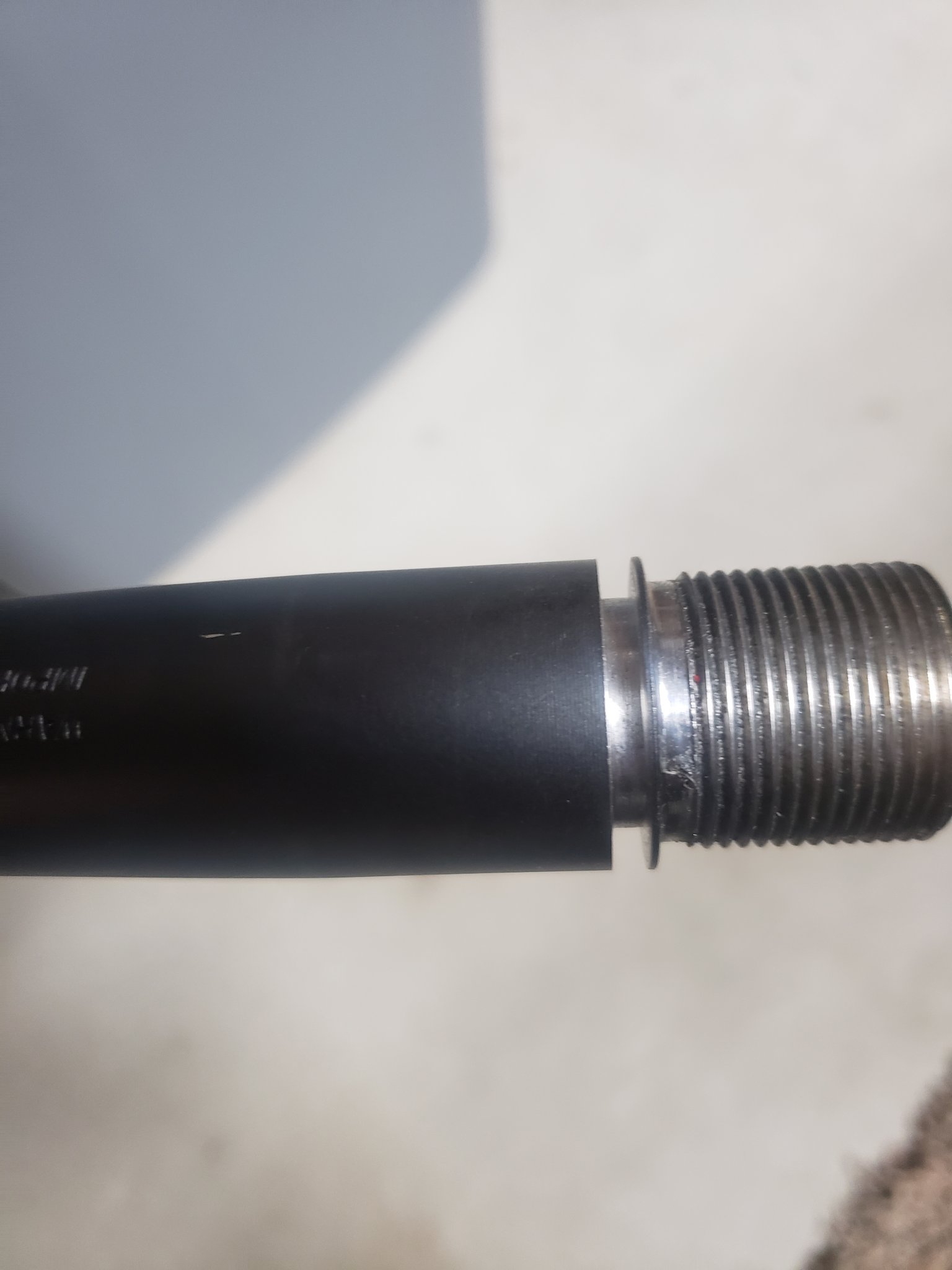

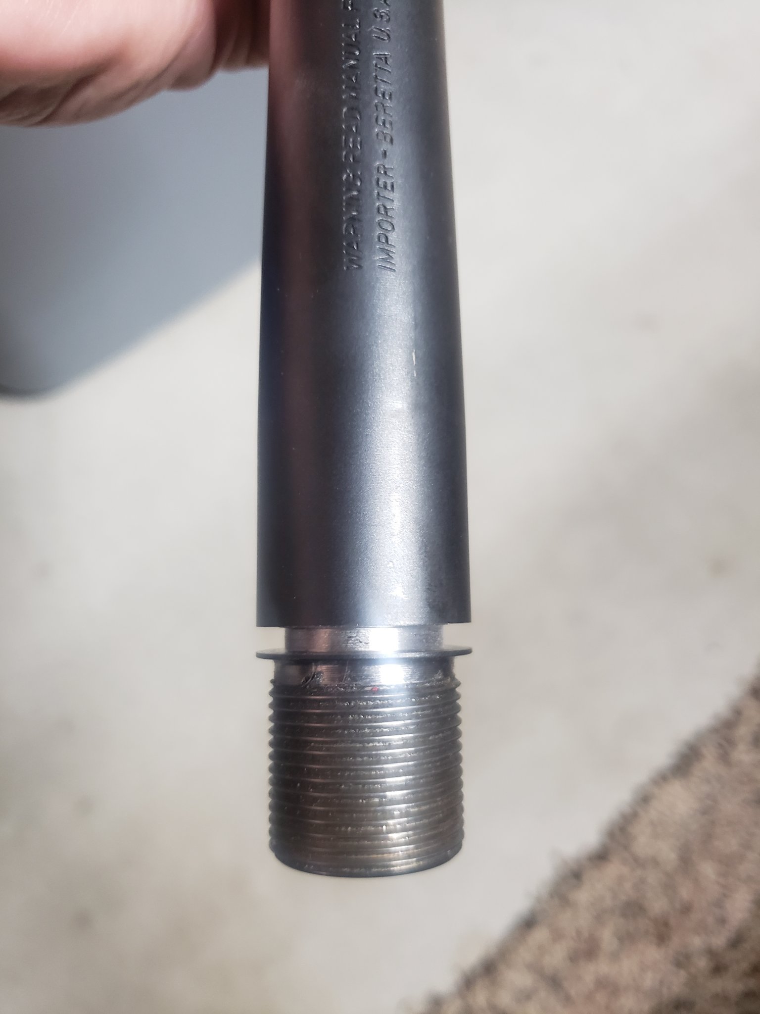

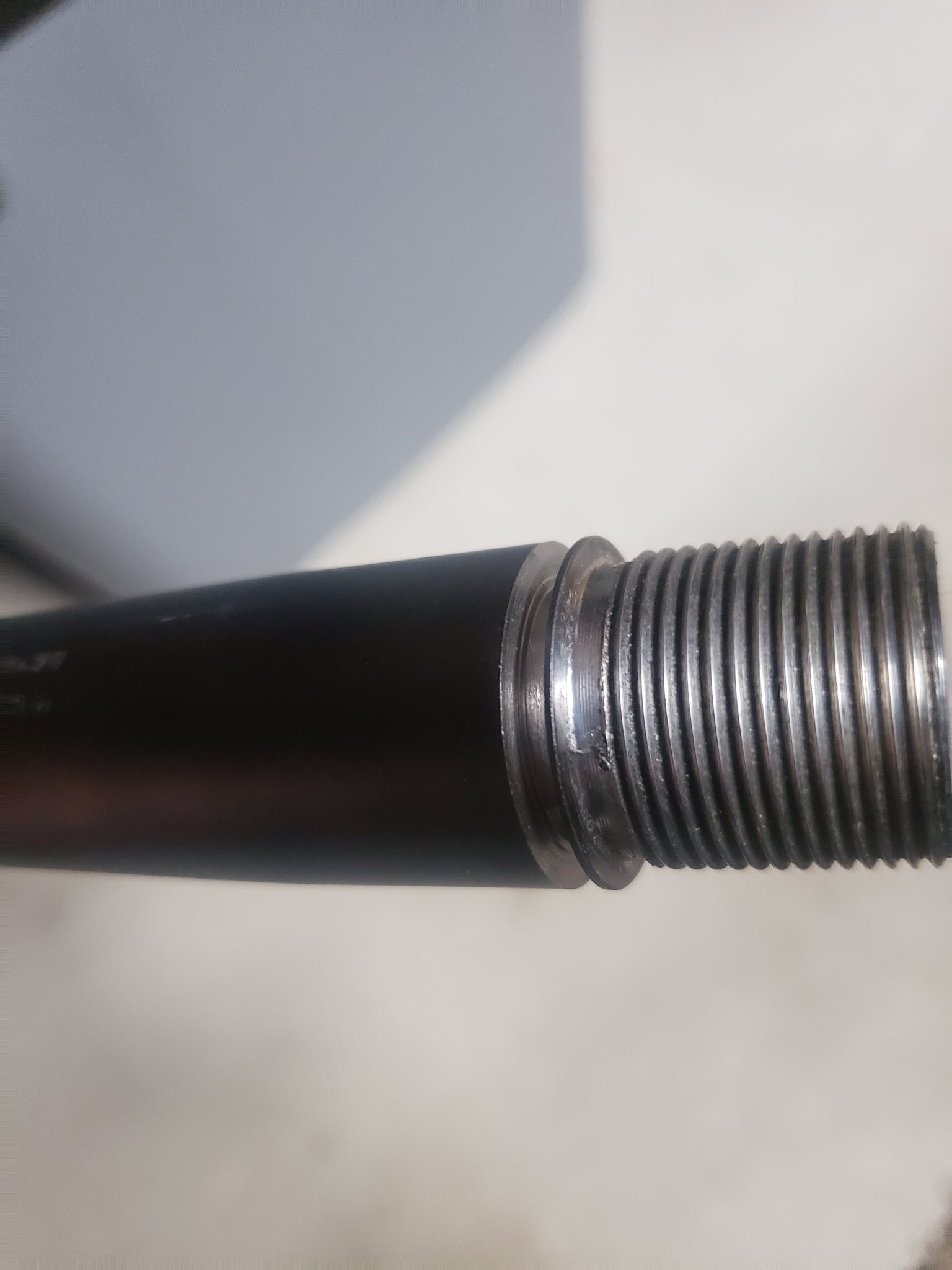

Anyone have a picture of this relief cut for the tikkas? Im assuming its running lengthwise of the barrel right in front of the action so that it can compress a bit to take force off of the threads?
From my experience (I think I posted it in the Tikka thread a few weeks ago) it's not the threads that are the issue, and I don't know how much penetrating lube would help, it's tension from the shoulder to the action face. My theory is that they're torquing them with the action heated and the barrel cooled, and that once they equalize they're cinched together there much tighter than the actual torque would let on.
I had mine with the stub of barrel lightly glowing, put copper antisieze on the threads and let it wick in (which it did amazingly well), and put a 2' chain wrench on the barrel with the action in a vise, didn't accomplish jack. Had a machine shop cut down the shoulder just in front of the action face, and they said they put a wrench on the flats I'd ground in the barrel and it came off with one half-decent whack with a hammer.
I unfortunately forgot to take my stub of barrel with me from the machine shop, but he stuck it in a lathe and cut down the circumference of the shoulder. It was about 3/16" wide, and juuuust in front of the face. I thought about trying to do lengthwise, but decided I'd rather not risk it.

Yes, my Smith made a 3/16" wide cut, about .030 in front of receiver face. Tenon size is 1" od, so relief cut should be as deep as tenon od. I believe the od of shoulder is 1.15". I had my Smith turn the receiver face down to the flats of receiver. This let's u put a 1.2" m24/LV contour barrel on it.

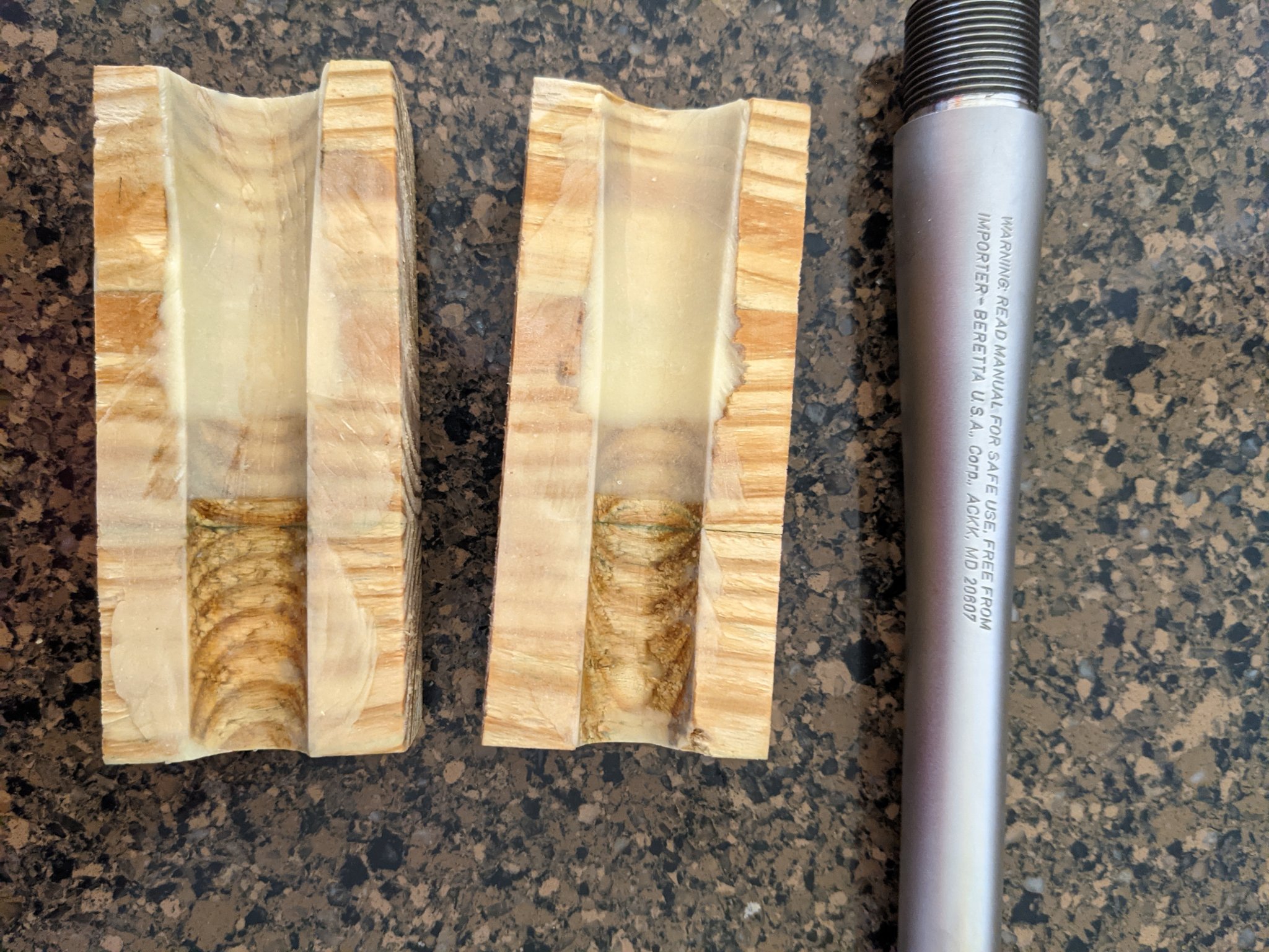

As for holding the barrel, there's a couple things at play. First, unless you have shims of the correct contour, you need to grip the barrel at a place where the contour is mostly flat. That happens to be 9 or 10 inches from the shoulder. In that case, the receiver is mostly likely hanging several inches beyond the end of your table and you have to get the flex out of the system so the force is properly transmitted and isolated. A simple wooden post/stud/whatever between the barrel shoulder and floor takes care of that.

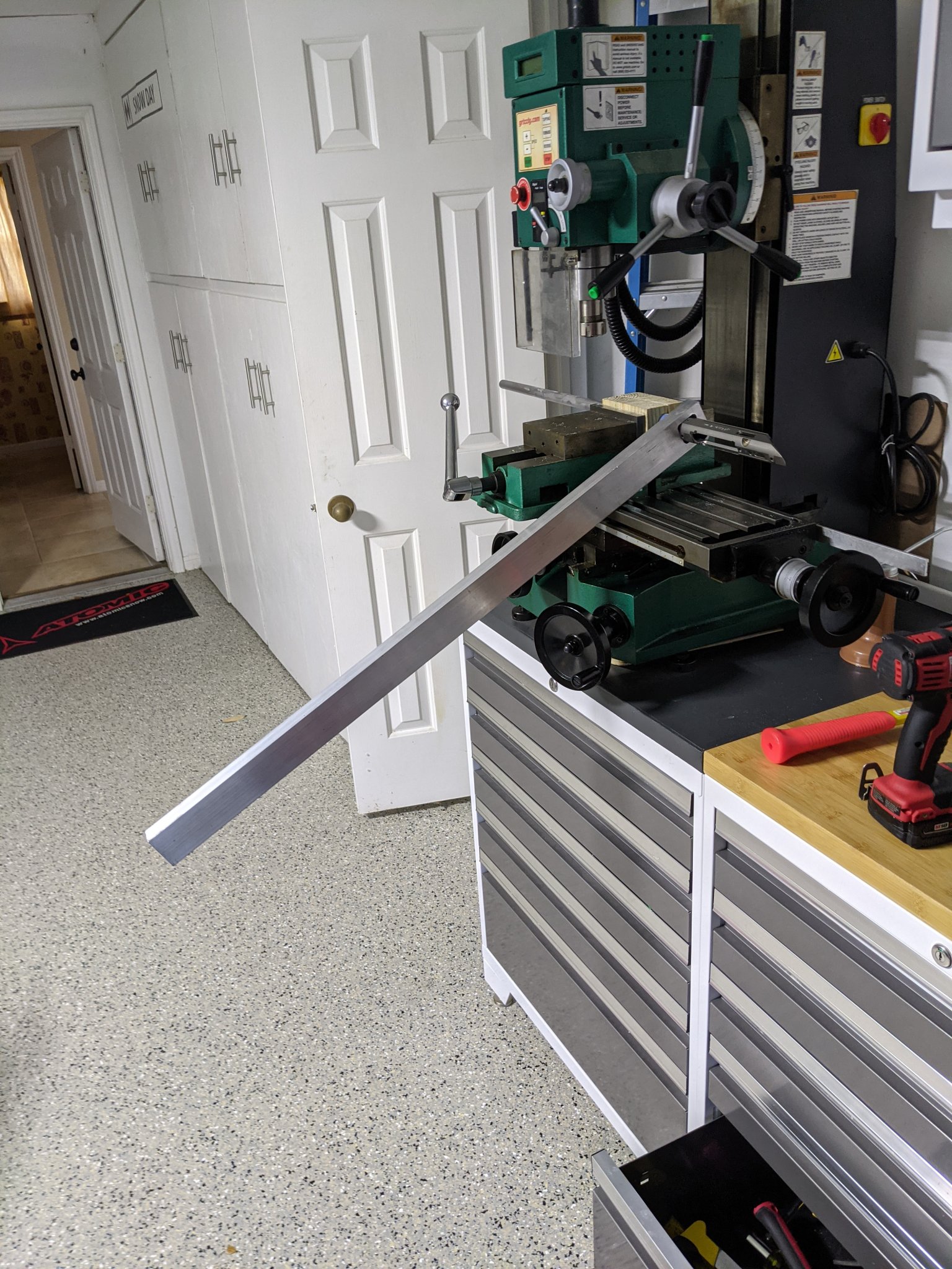

You can remove it yourself at home with the right tools.
- Barrel vise
- Brownells Universal Action Wrench
- Brown sugar
- hammer
- pipe to fit over action wrench handle for a cheater.
Clamp the barrel in vise with some brown sugar around it to get grip. Tighten Brownells wrench head. Slide cheater pipe over wrench handle. Whack handle with hammer. Make sure you’re hitting/turning in right direction. It’ll come loose.

I did mine at home. Soaked in Kroil. Put it in a Brownells barrel vice. Hit it with a good amount of heat then quickly cooled inside the chamber with canned air. I wanted to save the barrel so no relief cut made. My first attempt was with a PVA internal wrench for the Tikka. It twisted into 2 pieces under torque- it was designed to not to damage the receiver at maybe 100 ft/lbs.
I didnt want to spend much more for an action wrench so I measured the receiver flats- 31mm. Ordered a big honkin 31mm box wrench off Amazon for $20. Put a cheater on it and it spun the barrel off like butter with no damage to anything. It now has a PVA switch barrel setup on it.
Here are some pictures of the relief cut on my old 260 CTR barrel. Came off real easy after this was made.

After reading a few posts here, I milled out a 1.20x1.21 pocket in a aluminum bar (2x1) as the action wrench.
For the barrel vice, I did the following: cut a stepped hole in a pice of pressure treated wood which was made up of a few sections glued together to achieve a suitable size. I then step drilled the wood. Cut in half, and layer epoxy with substantial filler. The barrel was placed between the epoxy coated wood section with a saran wrap / plastic food wrap piece of barrier.
I did use powdered sugar in the mold between the barrel, it really helps. All in all worked great, didn't take much effort to get off after a few dead blow hits. No marking at all.
I hope these photos help for someone else who would want to do the same.

Allthewatts has a good and simple solution. These are cut to fit an existing action wrench. I've never had a Tikka factory barrel that wouldn't come off with this set-up and a couple hard wacks.

I think the key is some solid whacks with a head hammer. It can be the same getting off Savage barrel nuts. A cheater bar just isn't the same as a sharp whack with a heavy chunk of steel. A barrel vice and an external action wrench make short work of it as long as they are held well.
will be using an external action wrench to remove the barrel. is there a benefit (or the opposite) for leaving the bolt (or an internal action wrench) in the action, thinking maybe it would add a little structure to the action?
You better hope there's no advantage to leaving the bolt in place. That would mean the receiver is bending or caving.
I used an external action wrench on my Tikkas. The flat faces are a huge blessing. Use a sheet of paper between the wrench and the receiver and it will protect the finish (at least it did for me). It really didn't take all that much force in any part of the operation.
-Stooxie
ok i got it off! tried using a wheeler barrel vice with oak inserts but it kept spinning. so vised the barrel in my machine vise and that did the trick, at the expense of scratching/gouging the barrel, but i figured there wasn't a huge market for factory barrels anyways... used a wheeler external action wrench and just smacked it a few times with a small sledge and it finally broke free.
