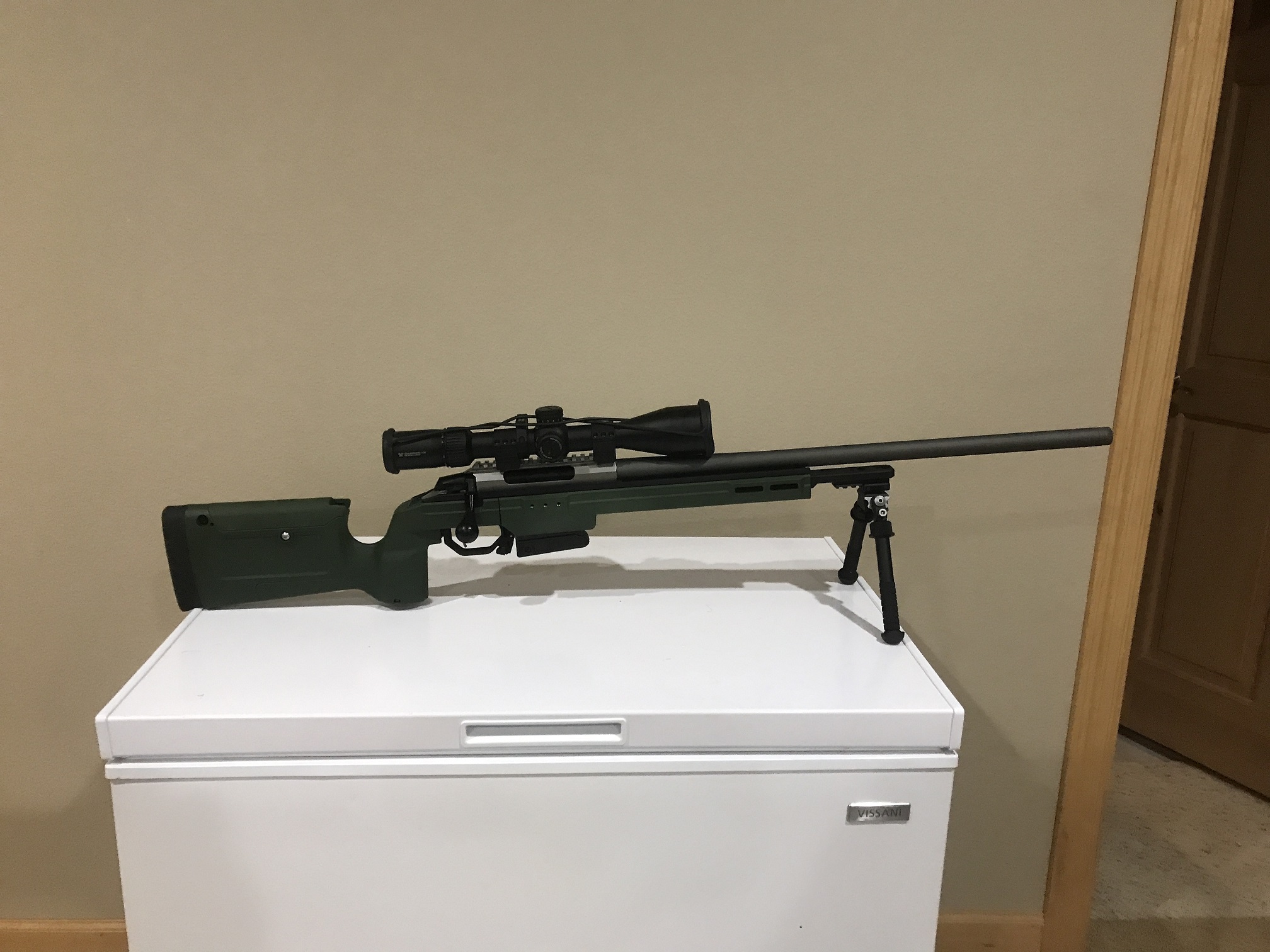

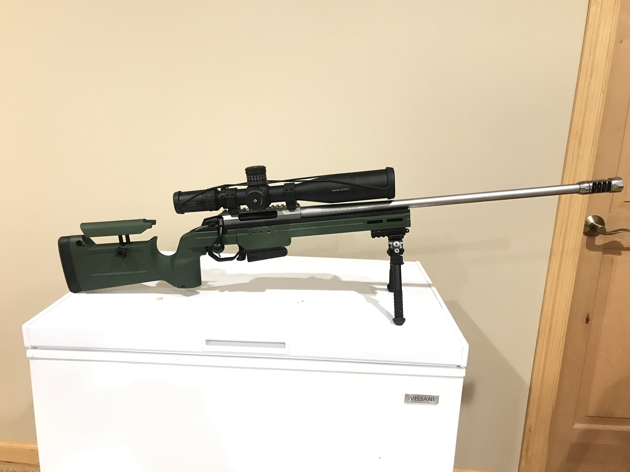

I was able to remove and replace a Tikka CTR barrel today. I used a viper vise and a Wheeler #1 wrench with the jaw reversed to the flats. I torqued the vise bolts down to 50 ft lbs. I was able to actually just use C-clamps to attach the vise to my work bench. I used drywall tape between the barrel and vise to protect the barrel finish and between the action wrench and action. The barrel didn't spin at all. With a few hits from a rubber mallet the barrel came free. I didn't mark up the barrel or action at all. I clamped the barrel as close as I could to the action. The first 1" of barrel is actually a constant diameter there. It made a very good place to clamp. I also clamped the action in the action wrench as close to the barrel vise as possible (at the very end of the receiver, i.e. where the barrel threads into the action). Having the barrel vise and action wrench as close to each other as possible will reduce stress on the action and reduce your chance of tweaking/twisting the action and/or bending the barrel you are removing.
P.S. I just wanted to add this information in case it helps someone. I replaced a Tikka CTR barrel with a take-off Super Varmint barrel. When I first made the replacement, I was very concerned because the text on the new barrel wasn't in the correct orientation. That said, I checked the headspace with go and no-go gauges and it was fine. I also read elsewhere that this often happens when installing takeoff barrels. So, just be aware that if you're swapping T3X barrels, the text orientation may be different between different receivers. It should go without saying you should check that headspace is correct after installing a new barrel.

Yeah, if I had access to a smith who I knew could do it, I probably would have just given it to them (especially since this is the first time the barrel has been taken off). That said, I live in the middle of nowhere (the local smith can only change AR barrels) and I know for a fact I will probably be replacing this barrel in a couple years (I shoot 1,500-2,000 rounds down this rifle per year), so I'd rather buy the tools ($75 barrel vise and $55 action wrench) and figure out how to do it. It was a lot easier than I thought it would be. I literally had the thing off in 30 minutes from when I started setting up. It was so easy I'm thinking of getting a 308 barrel and swapping calibers between 6.5 and 308.

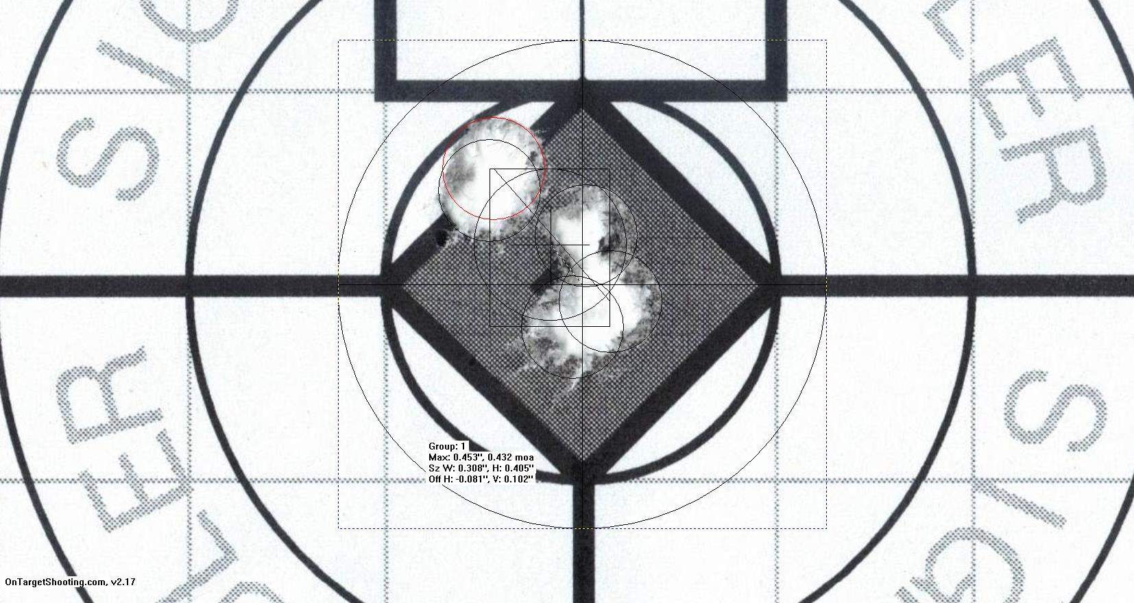

I hope you get to wear out many more barrels, Sir. I took the rifle for a spin this morning. Below is the first group out of the gun (5 shots at 100 yards). It looks like I didn't tweak anything replacing the barrel. She's shooting good.
