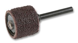

I inherited two H-S Stocks. Both aluminum blocks have been skim bedded with Marine Tex. What is the preferred method for removing this stuff? I don't have access to a mill, but do have a media blaster, dremel, sandpaper, and the usual chemicals (denatured alcohol, acetone, and MEK).
Any suggestions will be greatly appreciated. I hate have two stocks I can't use.
I don't know what's preferred, but if it were me, I'd just dremel it out then re-bed them onto the actions you want to use.

yep...
