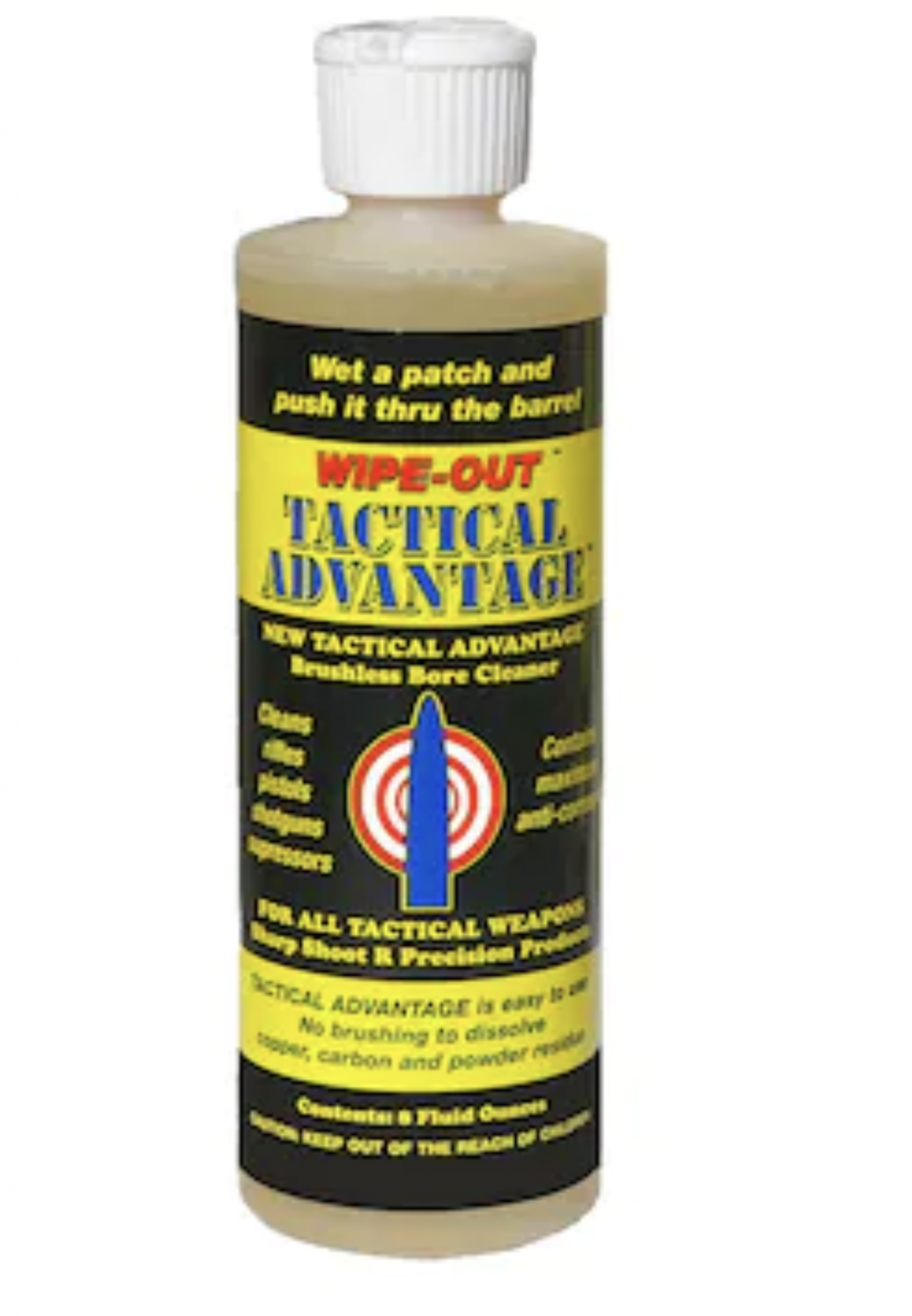

Tactical Advantage will solve your problem.

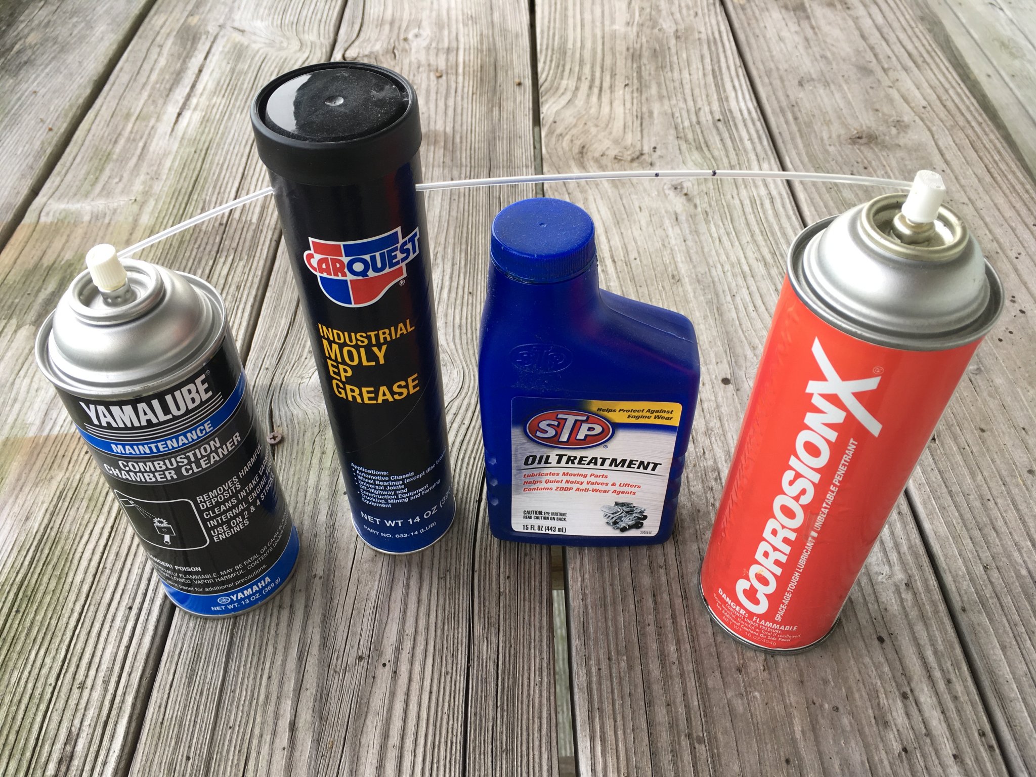

Yamaha Combustion Chamber Cleaner for bore cleaning. It has a very low evaporation rate, and does the job without scrubbing.
Not safe for painted surfaces, stock finishes or some plastics.
