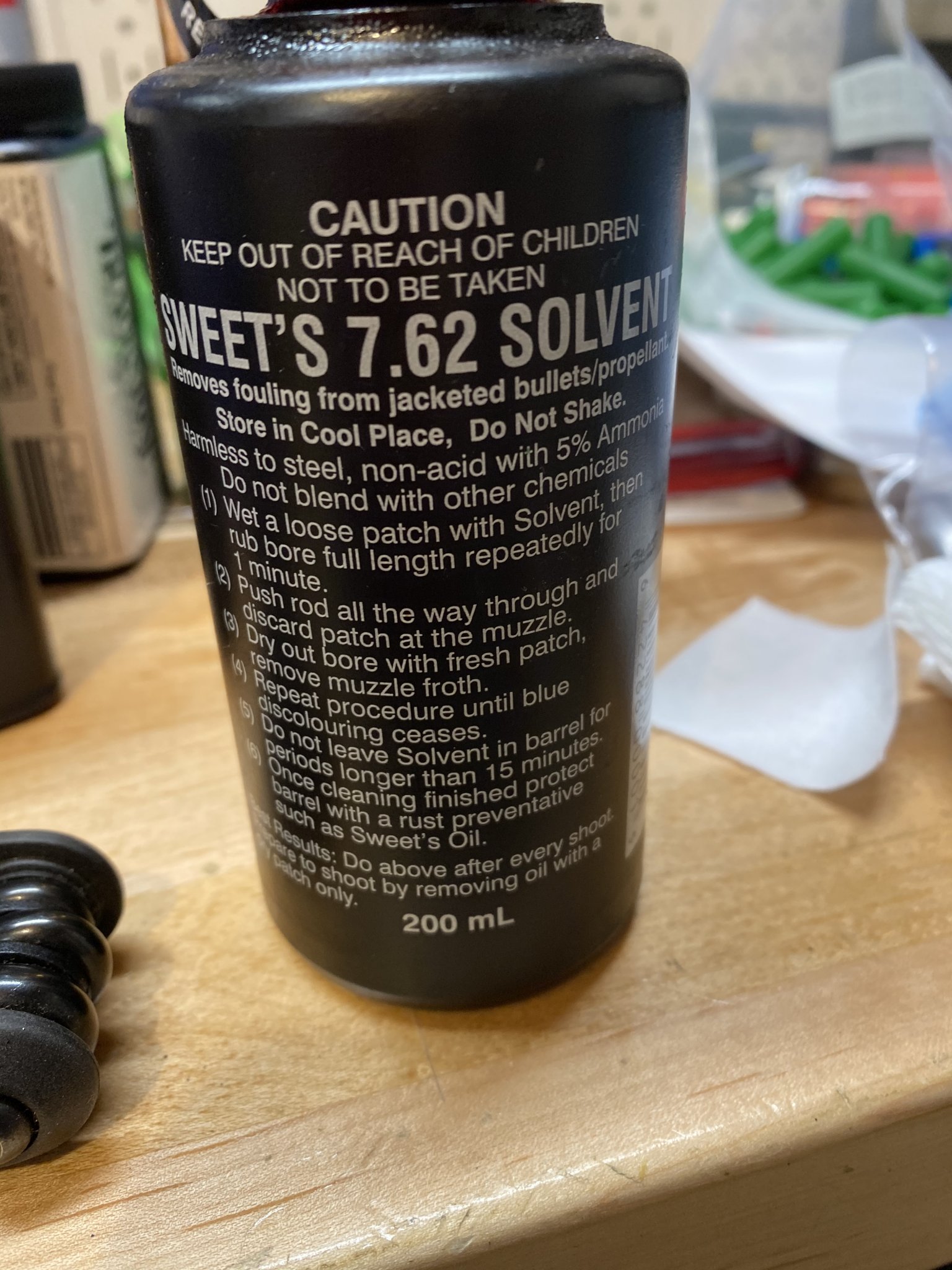

Sweets will work but will rust and pit bore if left for a long time. Wipeout will not do that. Terry Paul (owner of SharpShooter products) has sections of barrel soaking in Wipeout for 20-30 years and no microscopic changes have occurred.

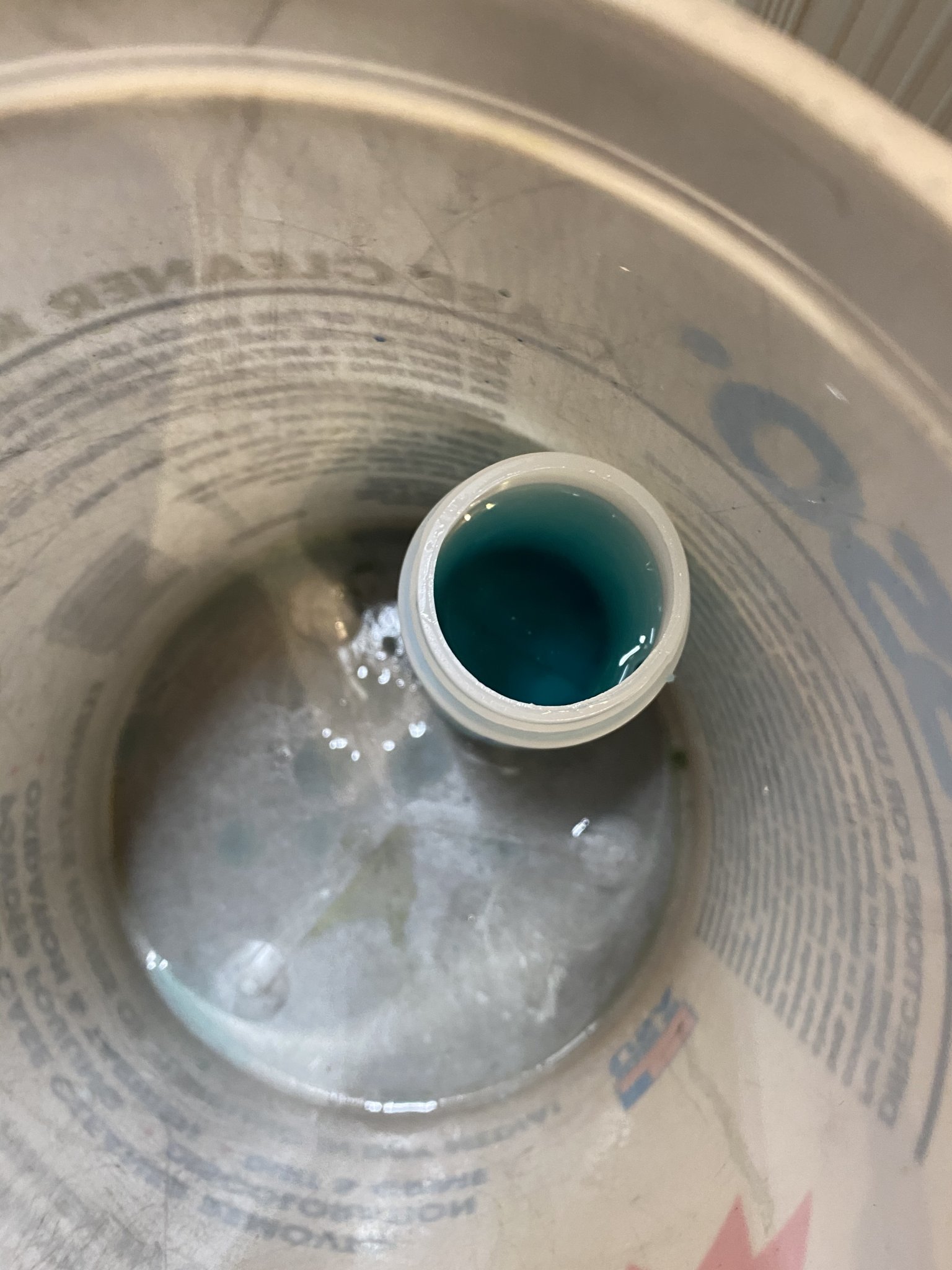

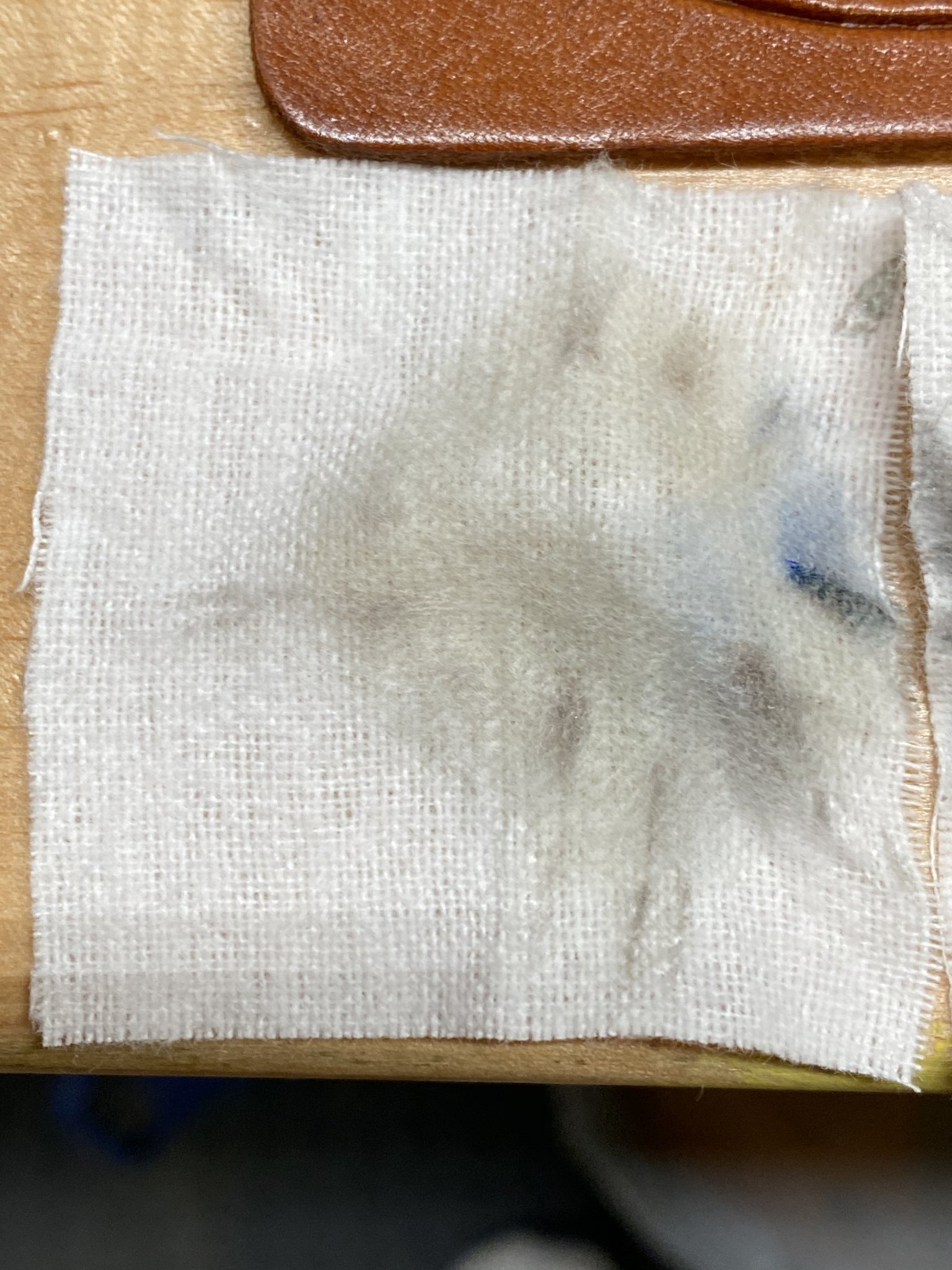

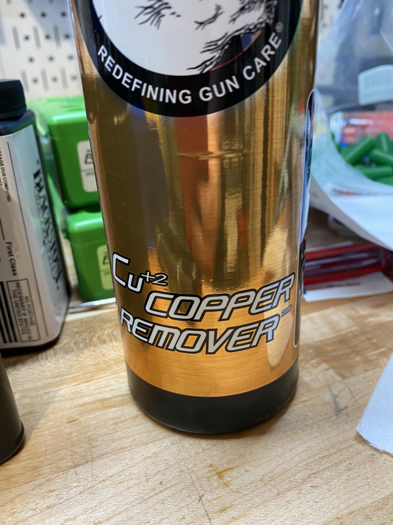

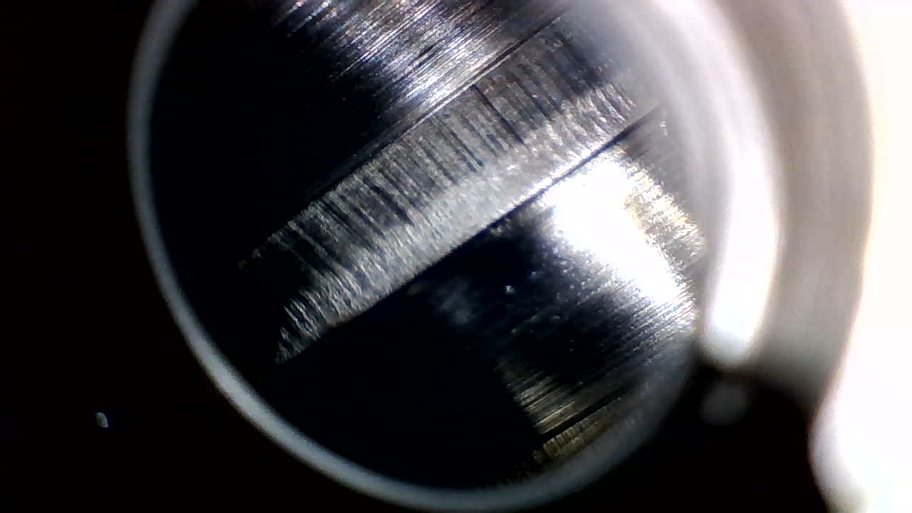

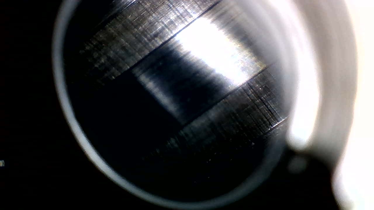

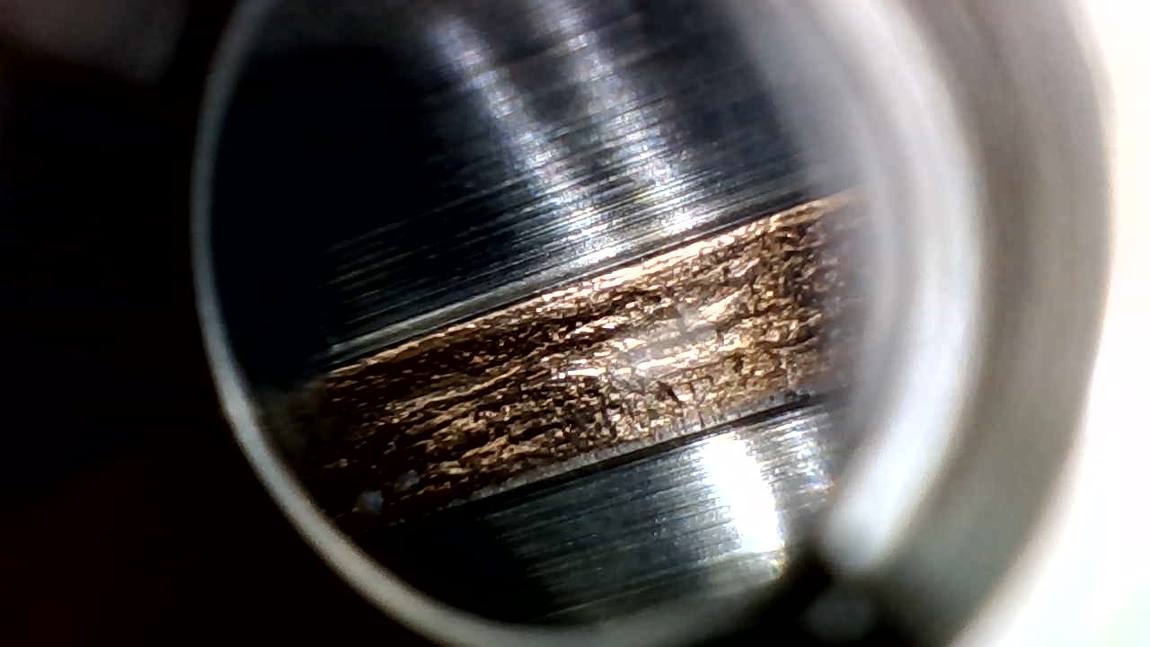

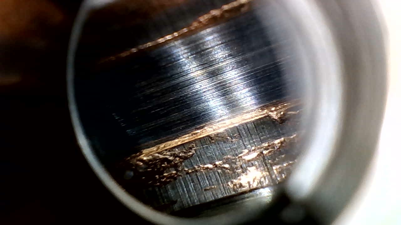

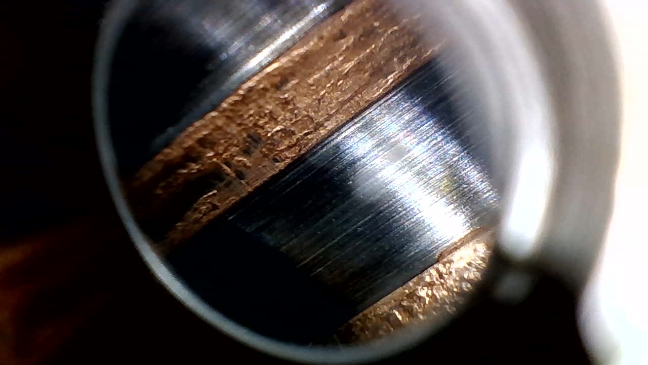

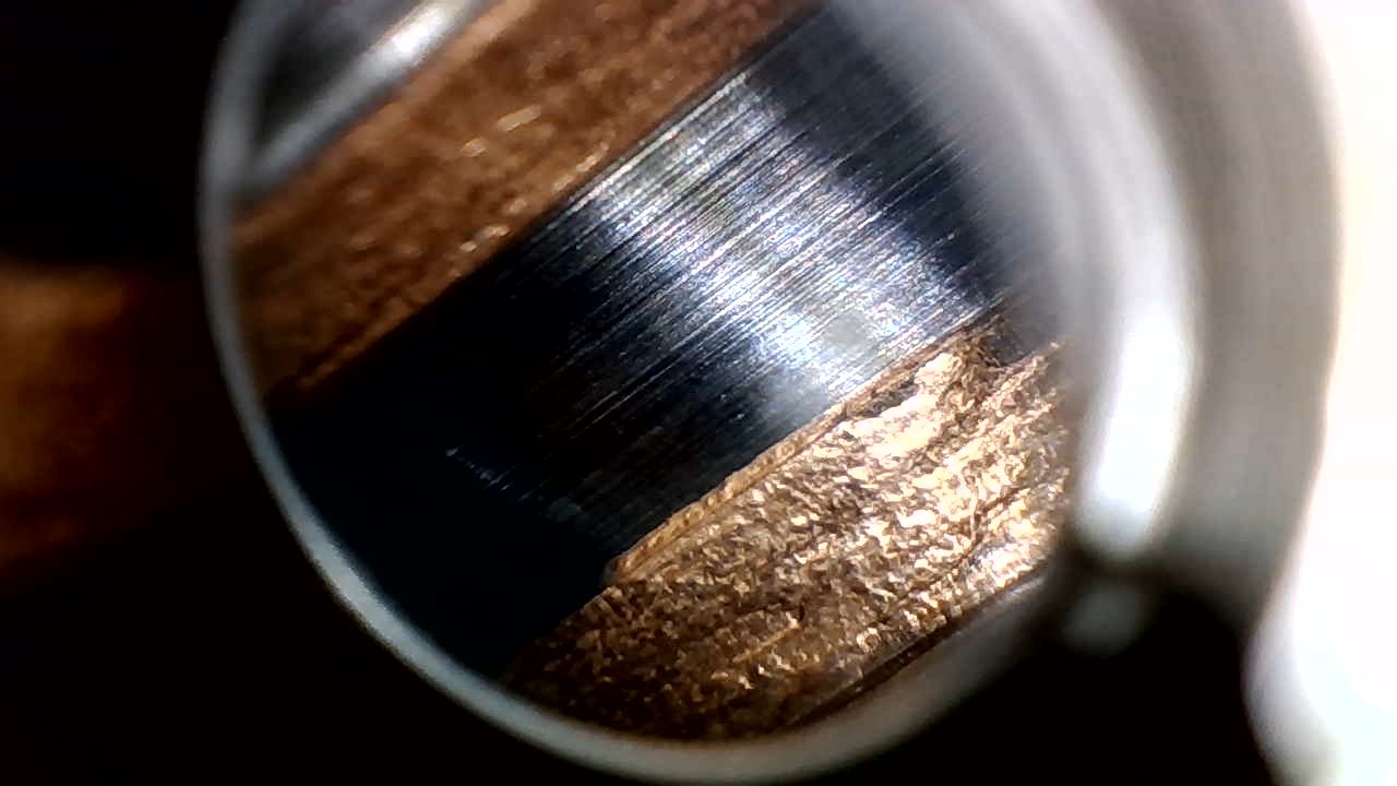

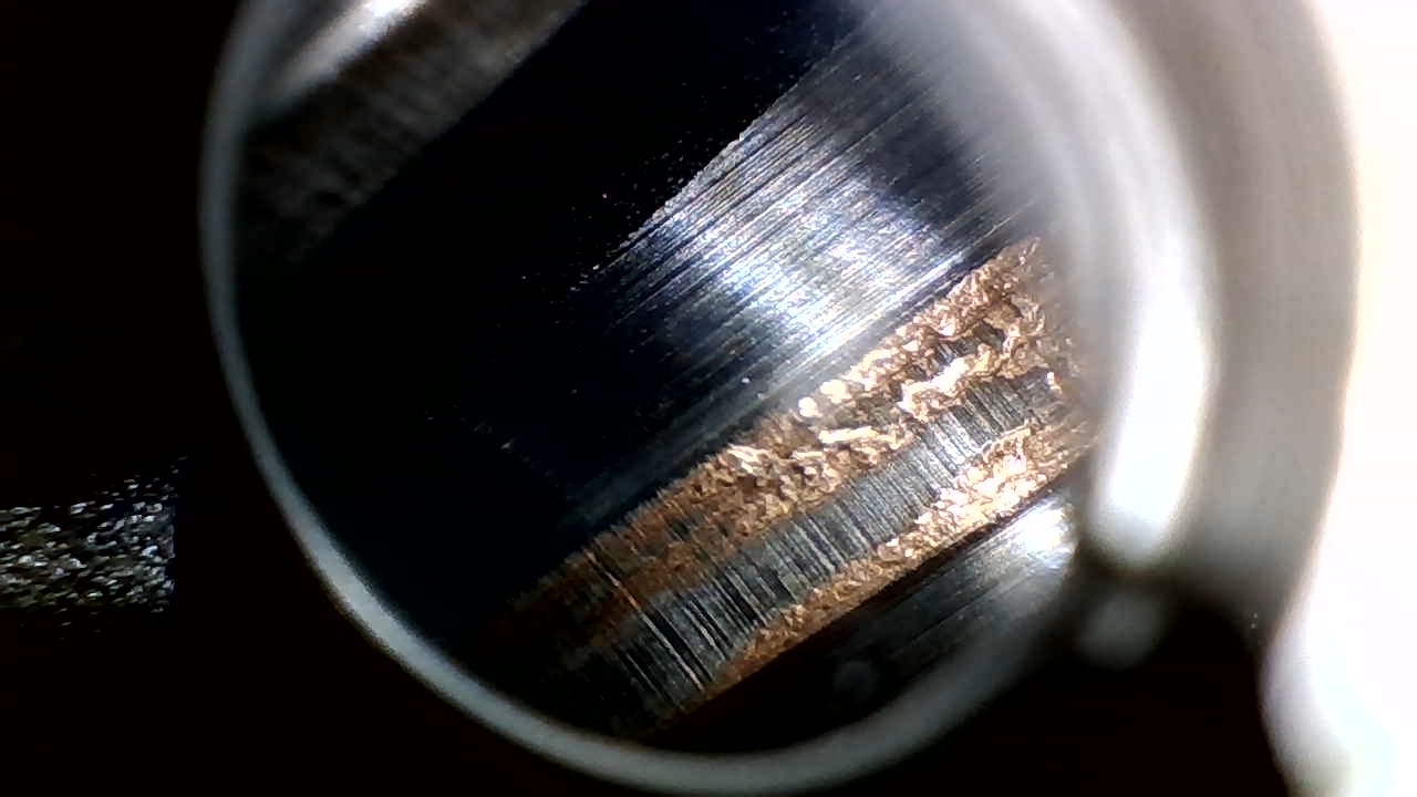

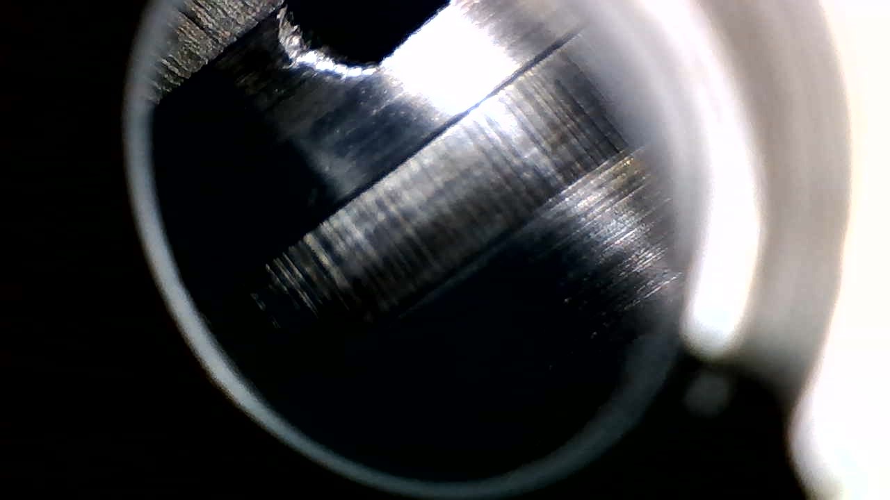

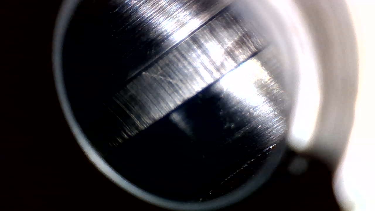

24 hrs of soaking in Hoppes copper remover didn’t do a whole lot...
but that end of the barrel is pretty damn clean...
Seems like it go the light stuff in the grooves well...
TIME TO TRY THE SOAK IN SWEETS!!! WOOOOOOT

I've used sweets a couple of times. The rifles were taken down to just barreled actions. I used boiling hot water to flush the sweets out. Then sprayed with wd40. Then patched and wiped dry. Then coated with remoil. Then patched and wiped dry. Then lightly coated with remoil.

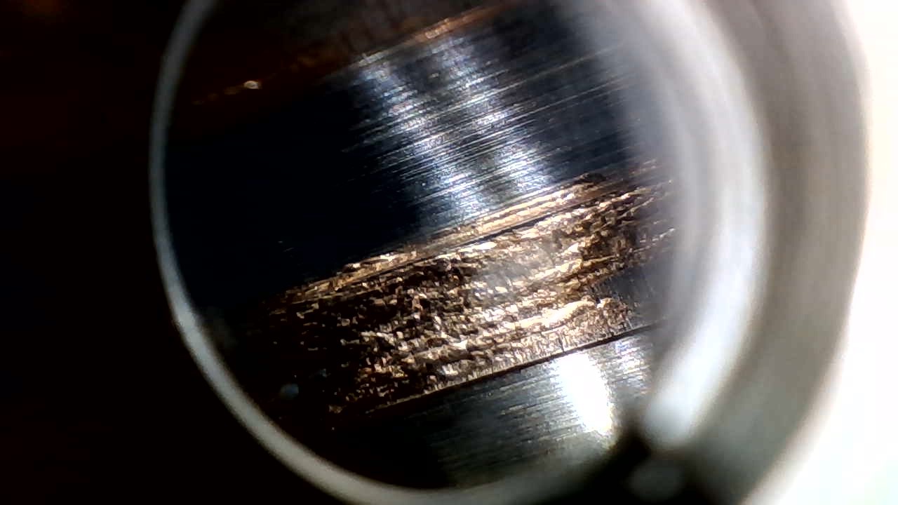

I attended one of Bryan Litz's seminar last year. He gave an excellent presentation on cleaning a rifle barrel.
Using a borescope and possibly other equipment, he and his team discovered that using a mechanical means to get copper fouling out of a barrel exceeded that of the chemical variety.
If I recall correctly, that surprised Bryan. It surprised some of us listening to his presentation.

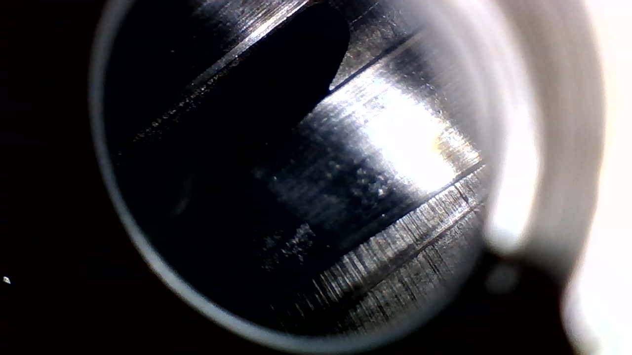

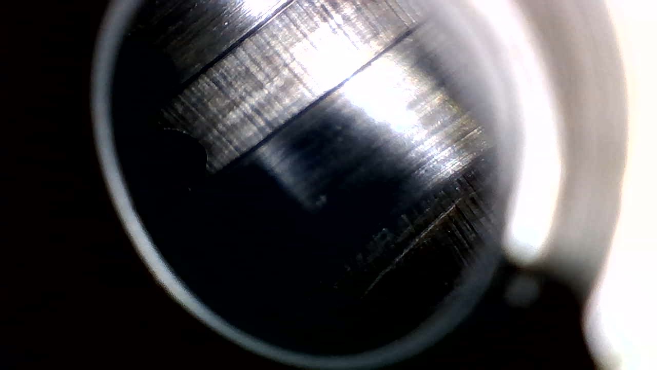

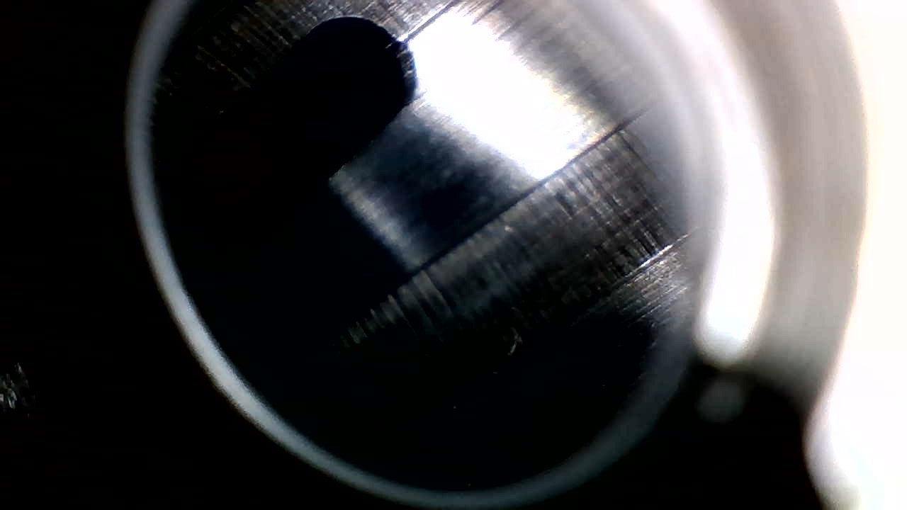

I think you're going to trash that barrel with solvent. Would Not do a soak in sweets. Might use a sweets soaked patch with a little jb paste wiped on it and work it back and forth 10 or so strokes. Then clean it well (several patches) with plain old hoppes 9 (not benchrest).
I don't see what you're gaining by removing every bit of the copper at this point.
Boretech Eliminator or some Iosso bore cleaner. I’ve had some bad carbon / copper build up that Wipe Out, Butches, Sweets wouldn’t touch. Boretech Eliminator for the most part has replaced my other solvents. I go to Iosso for the stubborn stuff.

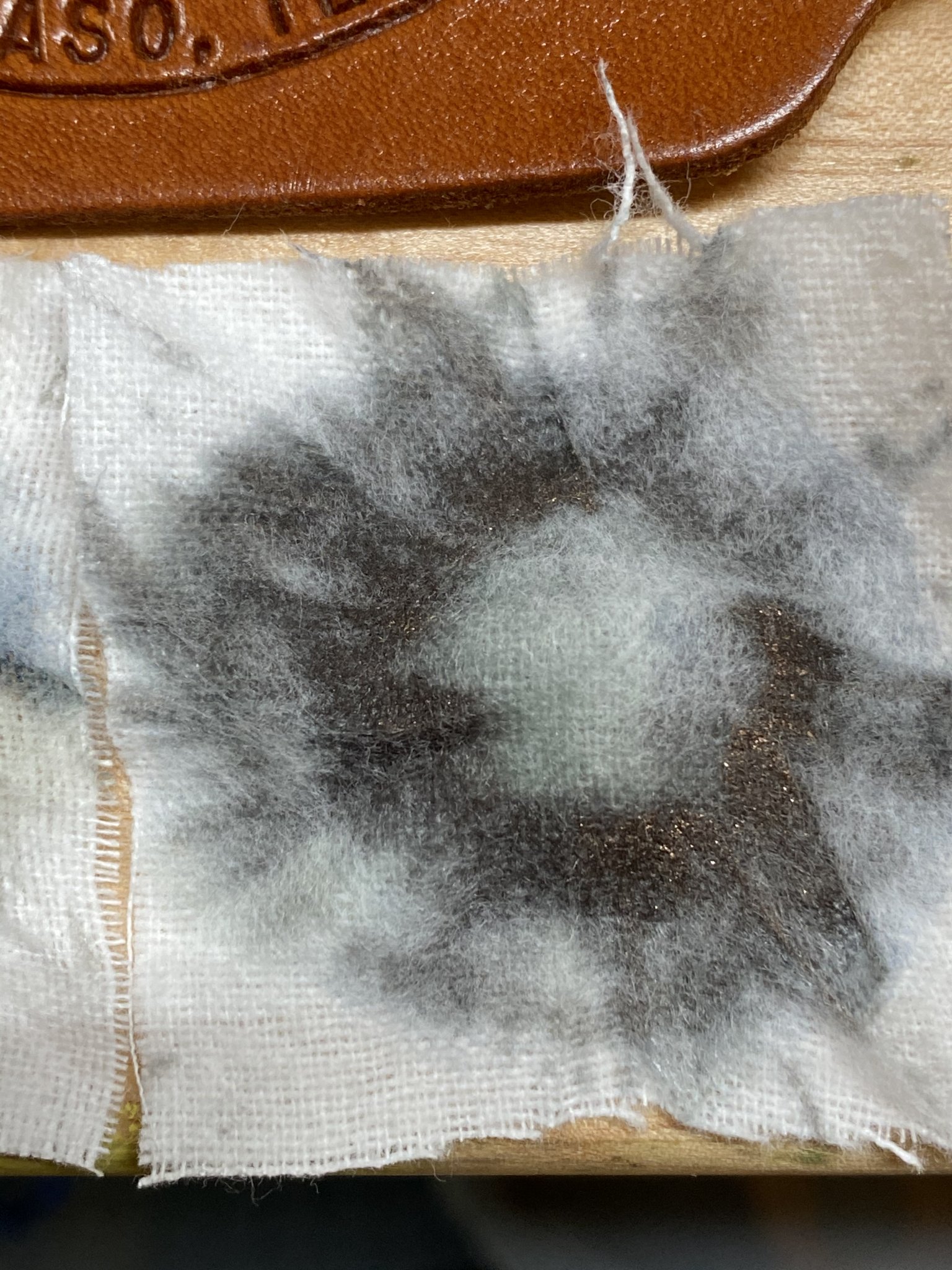

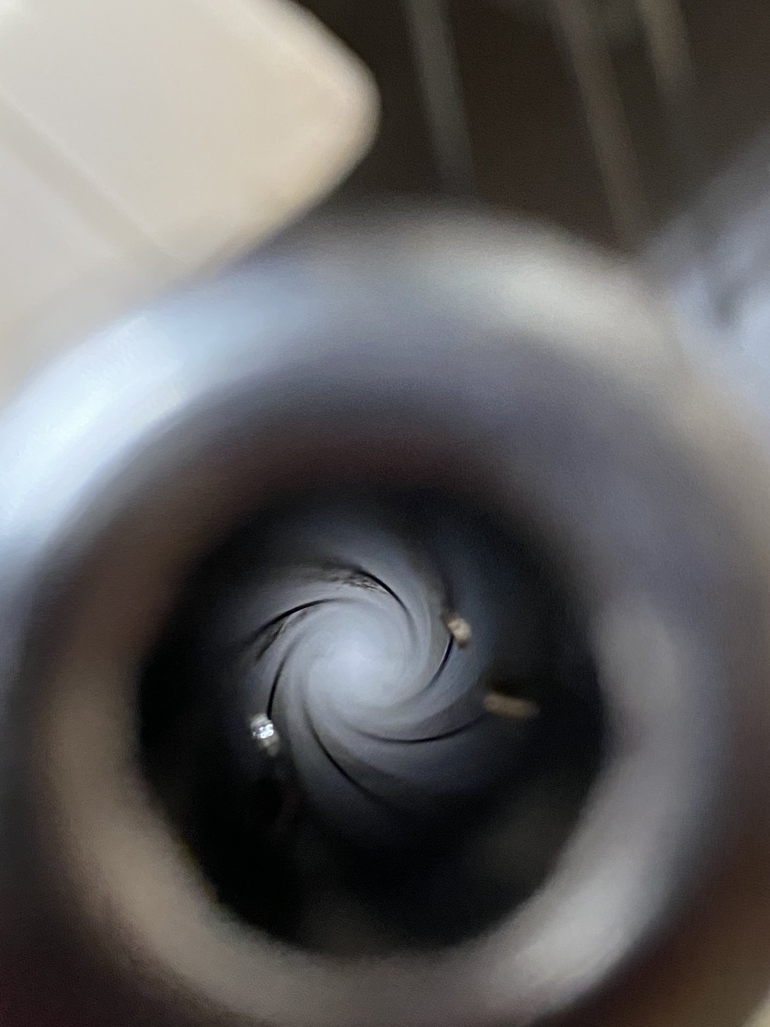

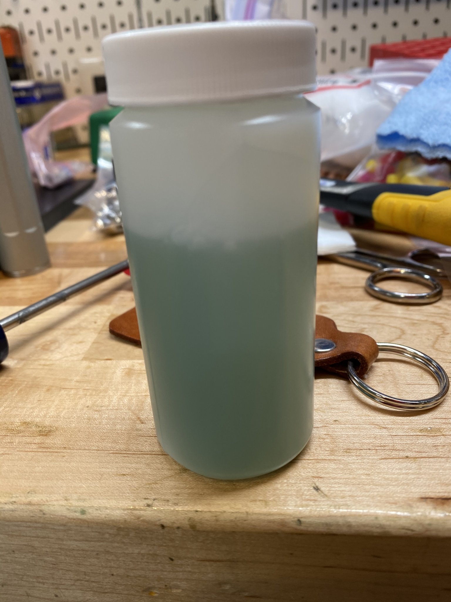

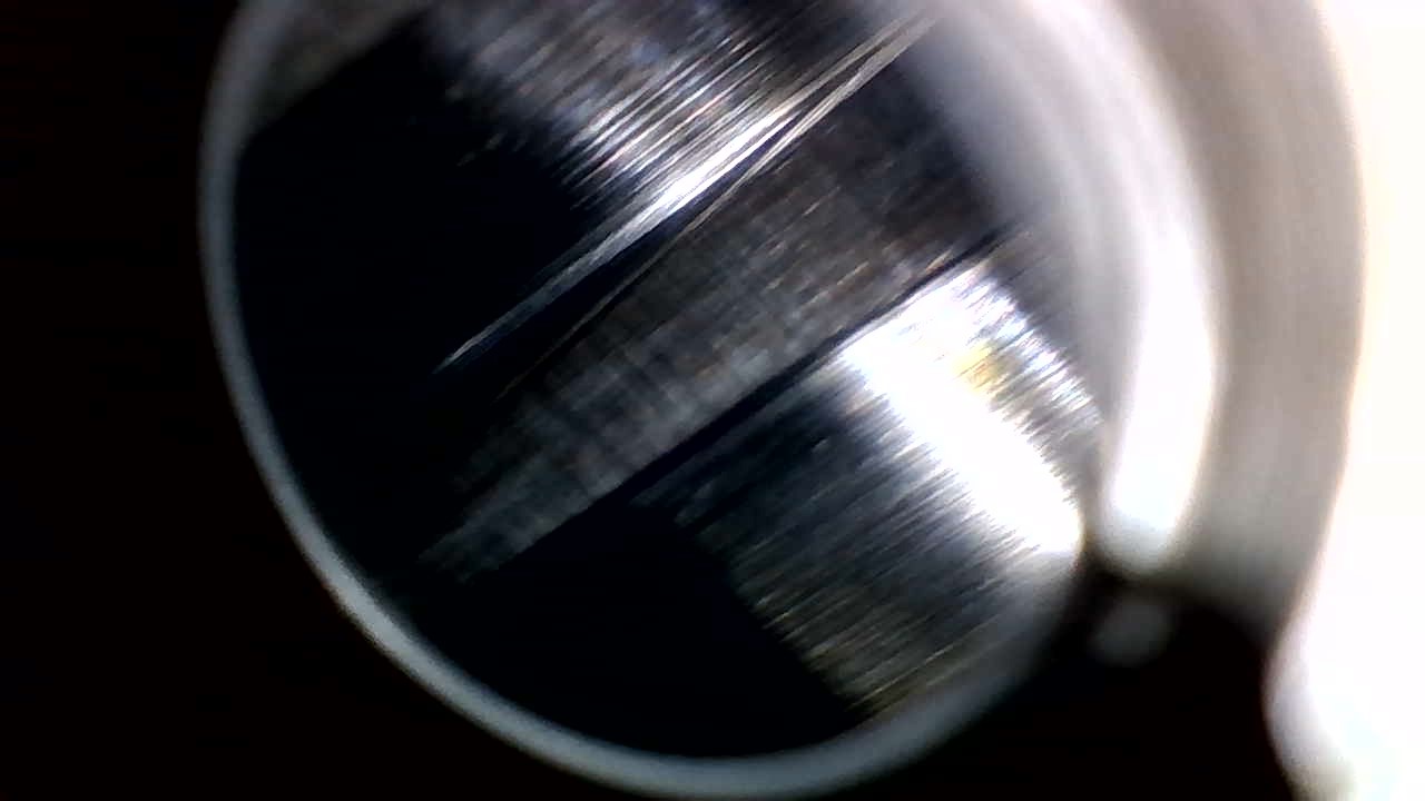

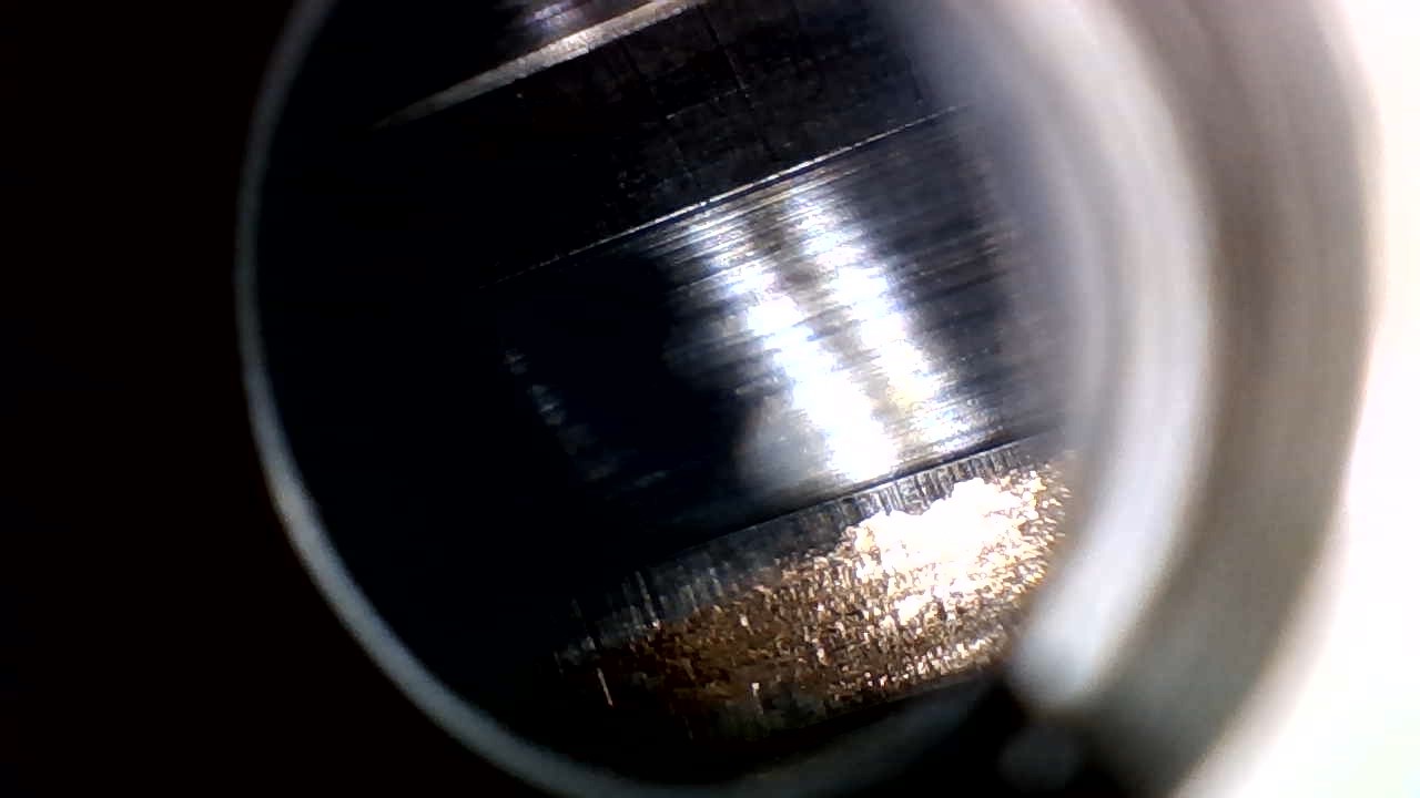

So I let it sit in boretech copper remover overnight... primarily because sweets is a very small container and I didn’t want to waste an entire container of it just to see if this is gonna work right (Bore tech is a clear solution by the way):
That's twelve hours... I'll try sweeties if the next experiment doens't work.

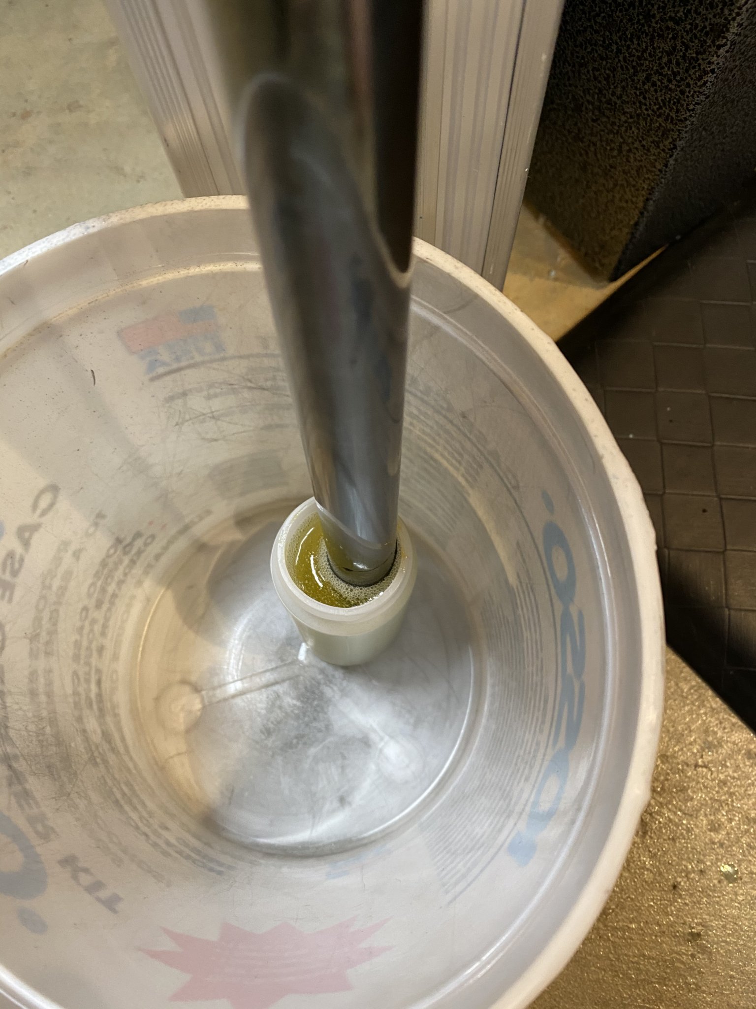

So I found on Amazon some silicon plugs that are varied in size that will plug the barrel perfectly... whereas Midway is charging like 30 bucks for a few of them it’s like $20 for a bag full of these things on Amazon.

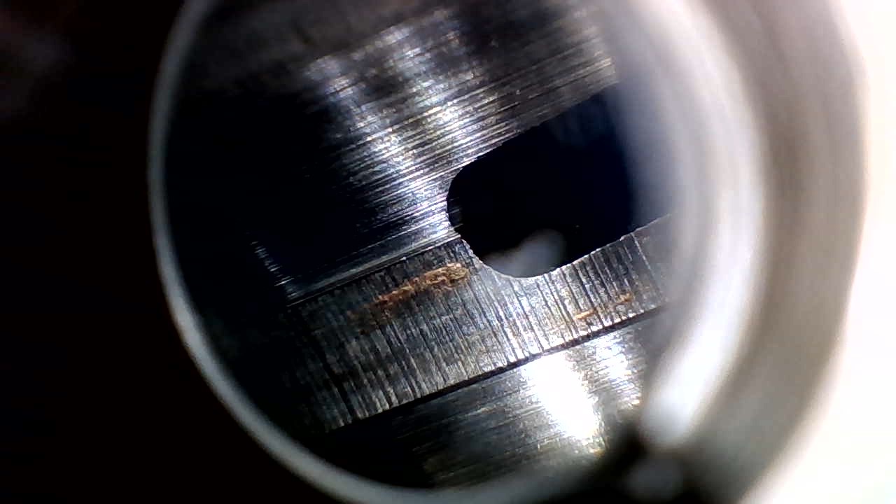

I did the lower part of the barrel underneath the magna porting using Butch's Boreshine which actually got all the copper out of that part of the barrel.
On the flipside you can’t plug the magna ported end of the barrel because it’s got holes in it where the magna porting is... so you have to immerse in the entire last 4 inches of the barrel like you see in the picture above.
I've tried that with three different chemicals so far and that amazing amount of copper in that last 4 inches of the barrel just doesn’t dissolve easily it’s gonna take a long time.
i’m surprise the barrel's actually in as good a shape as it is and it’s really more a matter of removing that copper as a test....

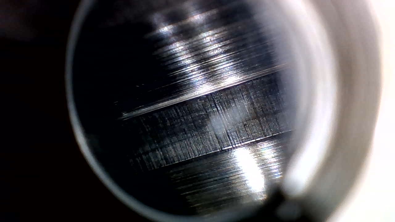

That’s clean. I’m sure it’ll need to be fouled back up a good bit before accuracy is returned to normal but clearly long soaks and letting the chemicals do the work is an easy route to go
I really just wanted to see that it would take to get a barrel THAT fouled at the end clean.
My TRG-42 had a lesser extent of an issue... and I was able clean that with bore shine. ...and it got VERY clean. So, yeah, that one will require some foulding.
This barrel is just hanging out. I no longer have the action that went with it... Just a good experiment...

Like @Strykervet said, my units used too use sweets on mg barrels too. We also used it every couple hundred rounds on our sniper rifles and it always did a nice job. As others have said just patch it dry and get some oil in there after the sweets to protect the metal and you should be good whether you use the Makita powerdrill or rod and elbow grease methods of scrubbing lol
What really did it at the end was that I got sick and tired of waiting to see how long it would take.
I warmed the barrel up to about 200° and I took the risk of microwaving the sweets until it was around 200° (The thermometer said 189 when I took it out.)
I then let it sit for about 30 minutes and amazingly all the copper was gone.
The actual problem with doing this is that the ammonia becomes highly volatile to the point where you need to wear an ammonia mask. (That would be a full face respirator with ammonia cartridges…)
Increase temperature increase reactivity....

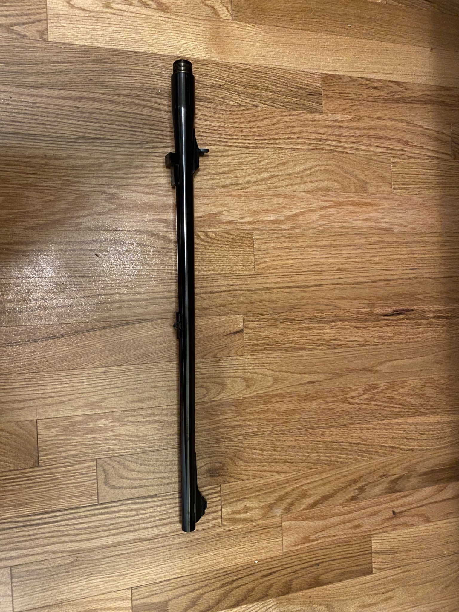

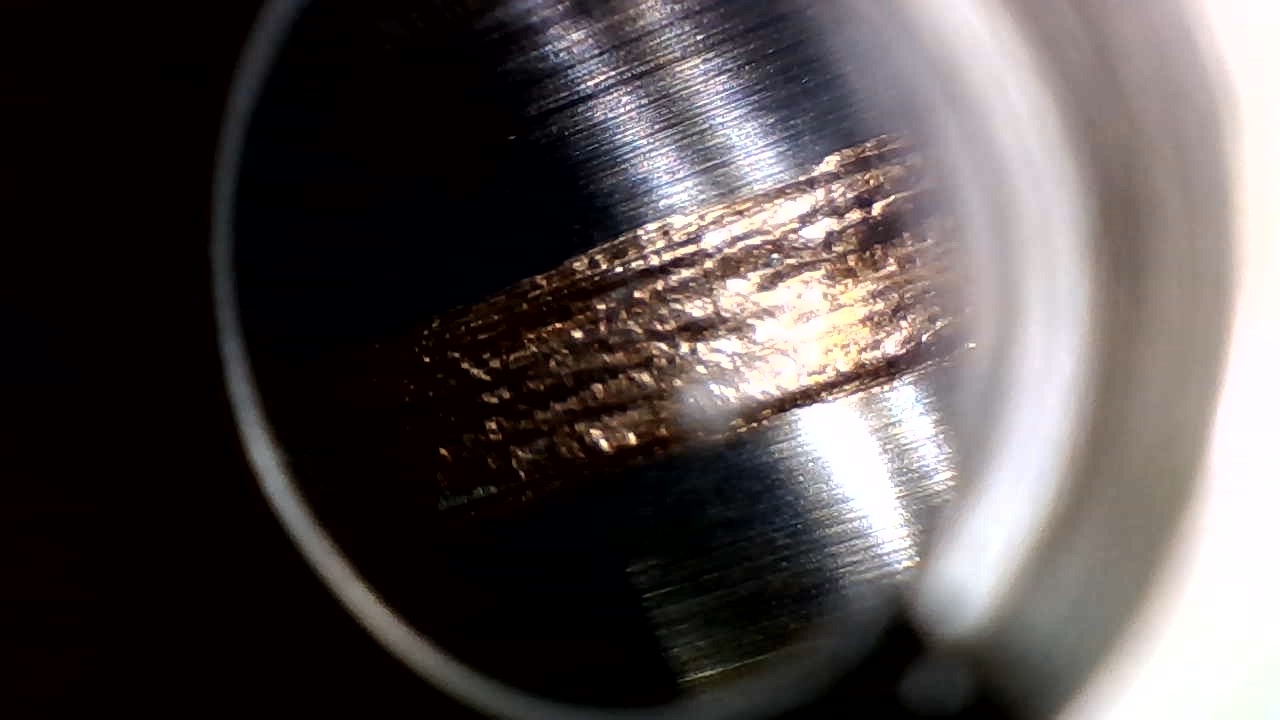

I have this old 375 H&H M70 barrel, and I scoped it for giggles several months ago.
I was astonished to see just how much copper was in the barrel, I mean like bad... and all throughout the barrel - the full length.
Basically, like this:
I let the barrel sit overnight... for two days, and 90% of it now looks like this:
I'm shocked...
I course, now I'm wondering how to get that last huge amount out!
Thoughts?
Are you using a copper solvent ? Or regular solvent ?
