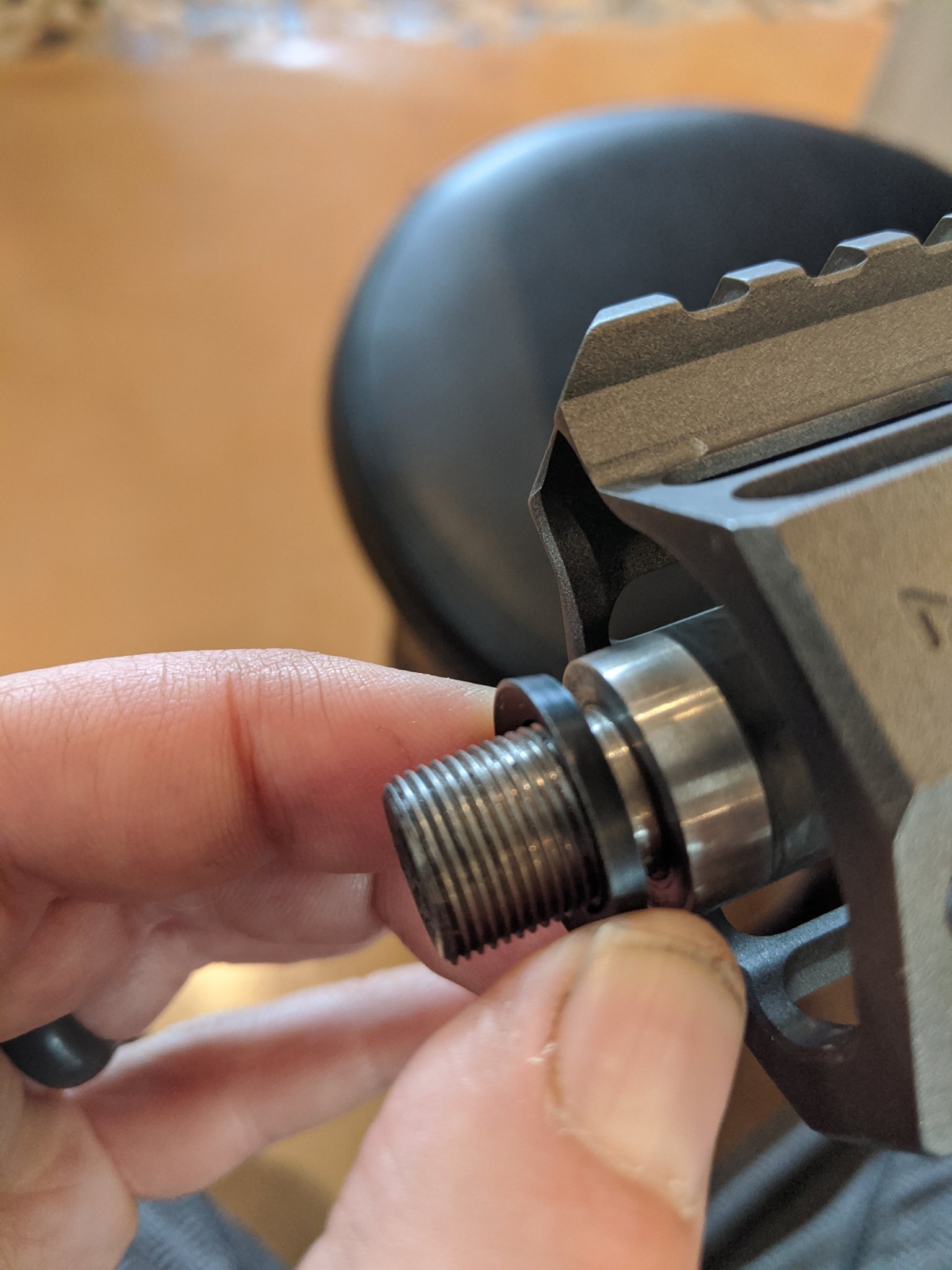

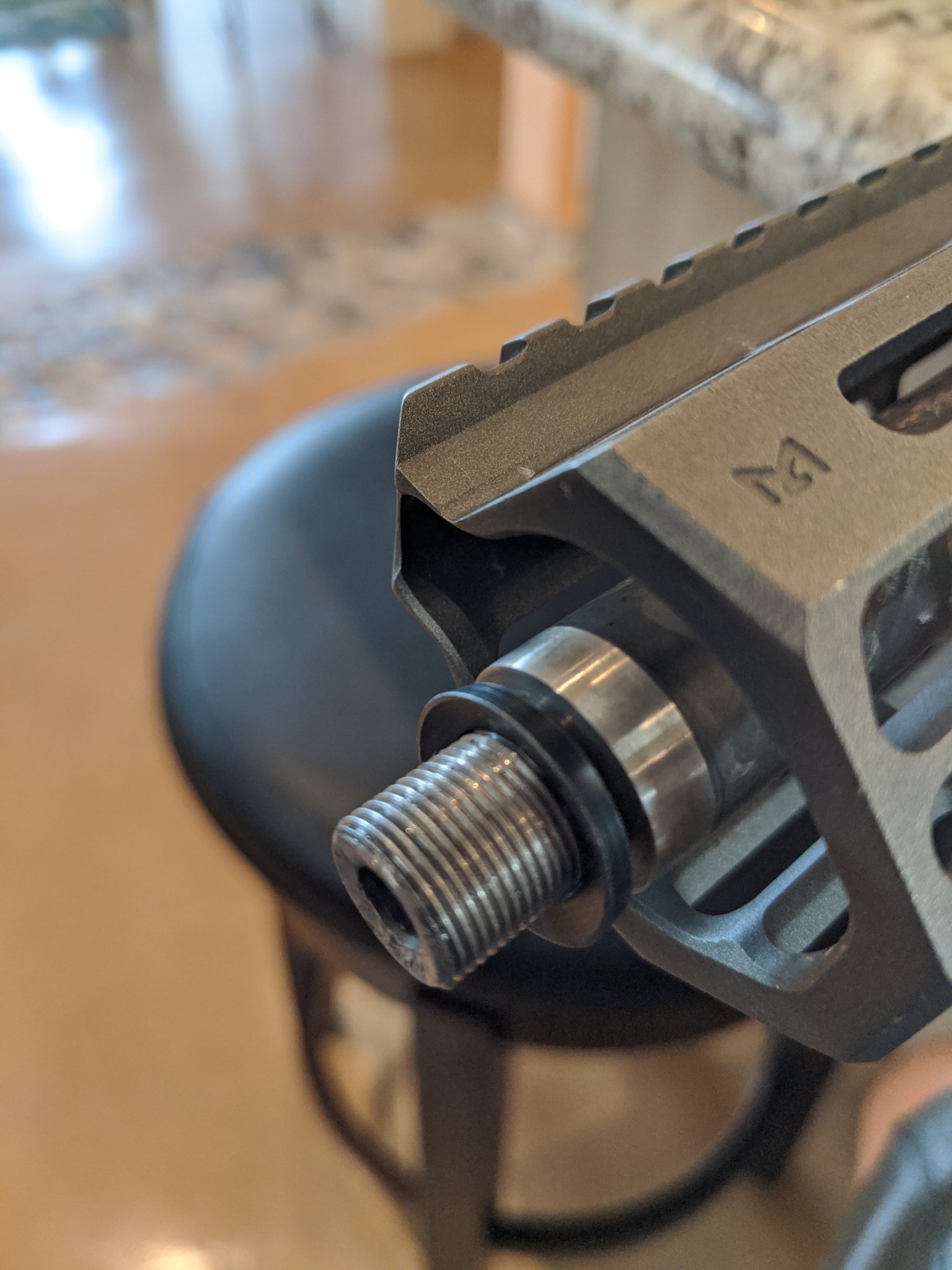

I'm trying to change out the muzzle device on my wife's ar15, and it has a big metal shim, that oddly seems to have the same ID as the OD of the threads. I'm not familiar with these types of shims, and I'm not sure if there's any tricks besides cutting it to get it off (maybe heat it up to expand it?).
Here is what I'm talking about:
This is about as far as I can get it:
That’s a standard 1/2” crush washer.
When they get crushed more than half a turn or so they can be difficult to remove.
I’ve used a Dremel and cutting wheel, but usually you can grab them with vise grips and thread them off
