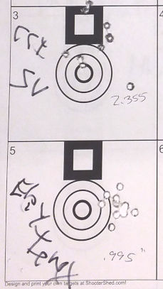

We shot guns yesterday. Like any .22s, lot numbers dictate accuracy. I sold the Tikka to my buddy since the RimX came available. Truthfully, using the cheap ammo that we had, I'd say the LW shot pretty well, matching my PROOF stainless barrel on my RimX. I had ran out of my SK plus but not before I shot a 10 shot group at 75 yds, and it shot damn good, enough that I bought another brick to test myself.
Back to the LW, I observed some pretty good groups with the better ammo, but the factory Tikka barrels ran CCI SV pretty well and for the price vs accuracy, the factory Tikka barrels are pretty good.

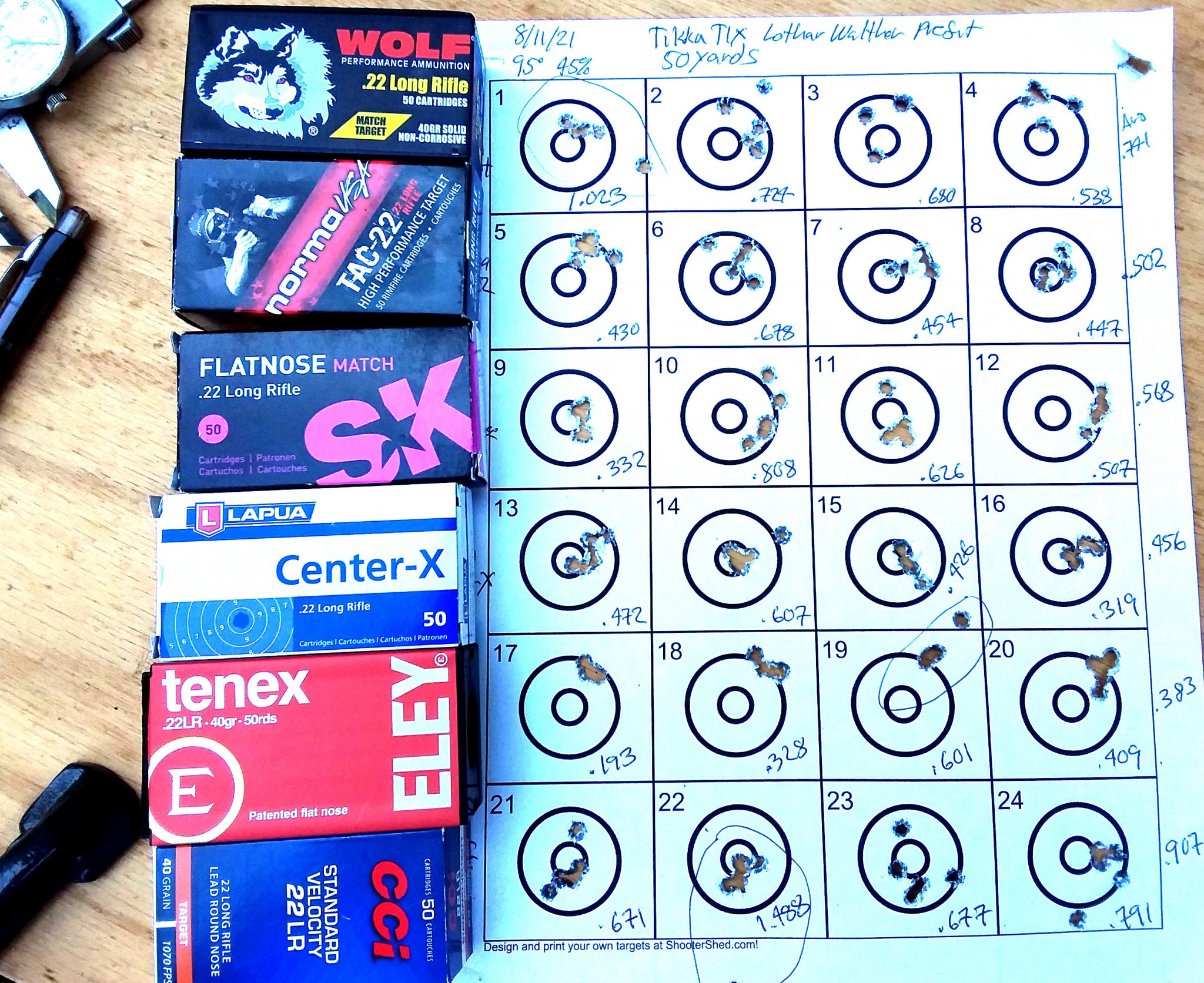

I bought one of these barrels for my 457 and it shoots great. Here is a 10 shot group at 75 yards with Eley match

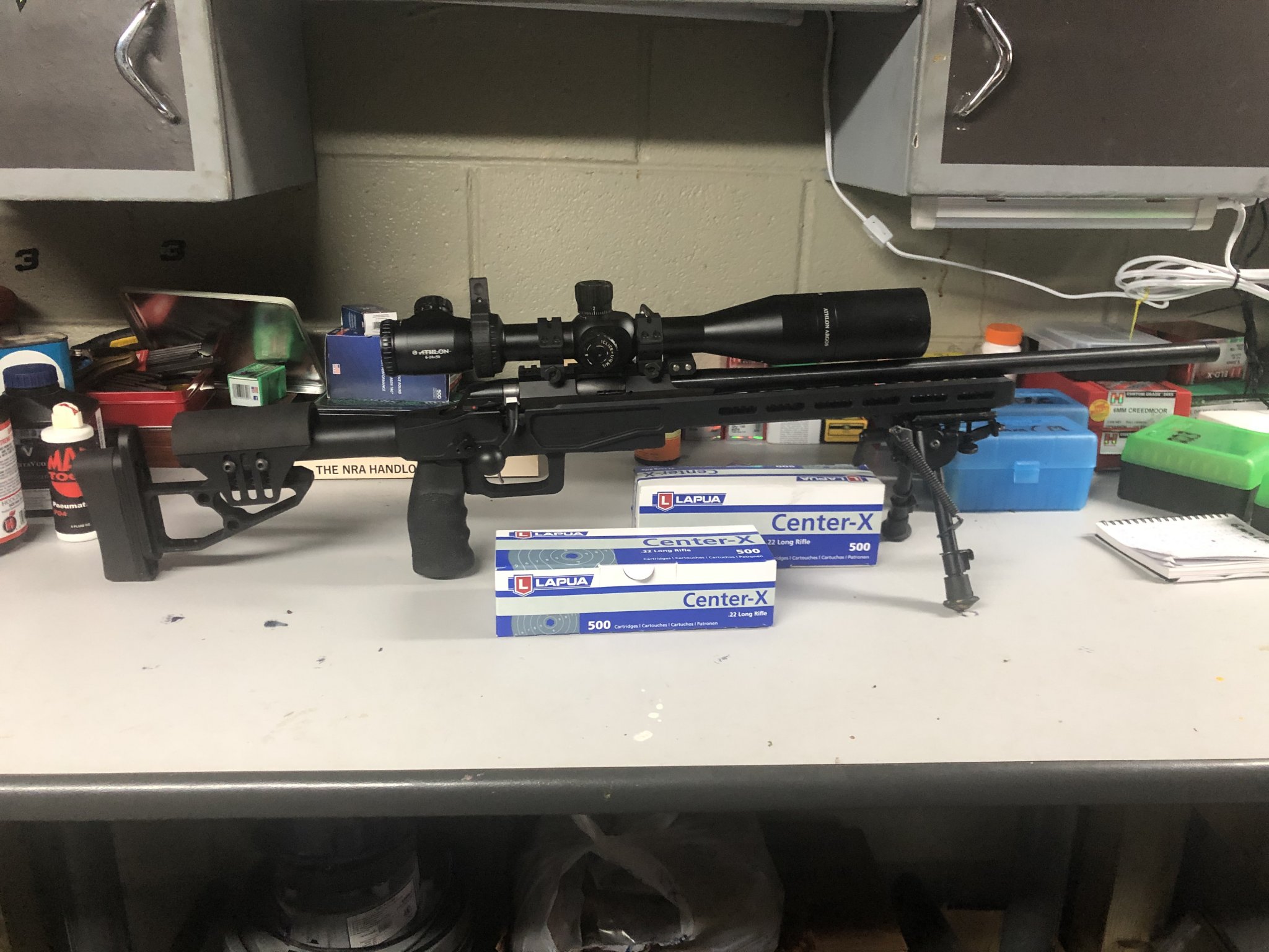

SRT4 please let us know how it shoots. I’m also curious on feeding issues. Mine is in a XLR chassis and shoots good and feeds good. No issues with feeding at all. Like you said I don’t like the profile of the barrel especially since I put it in a chassis. Your future input will be appreciated.

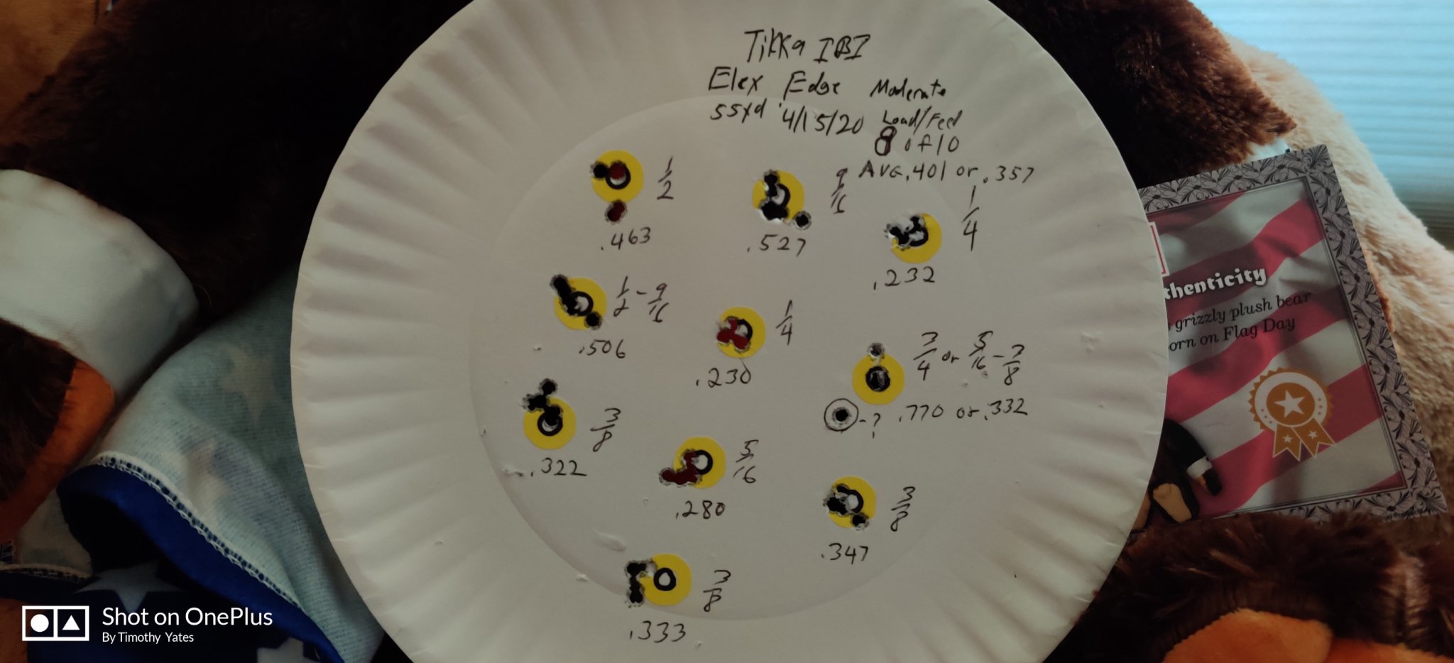

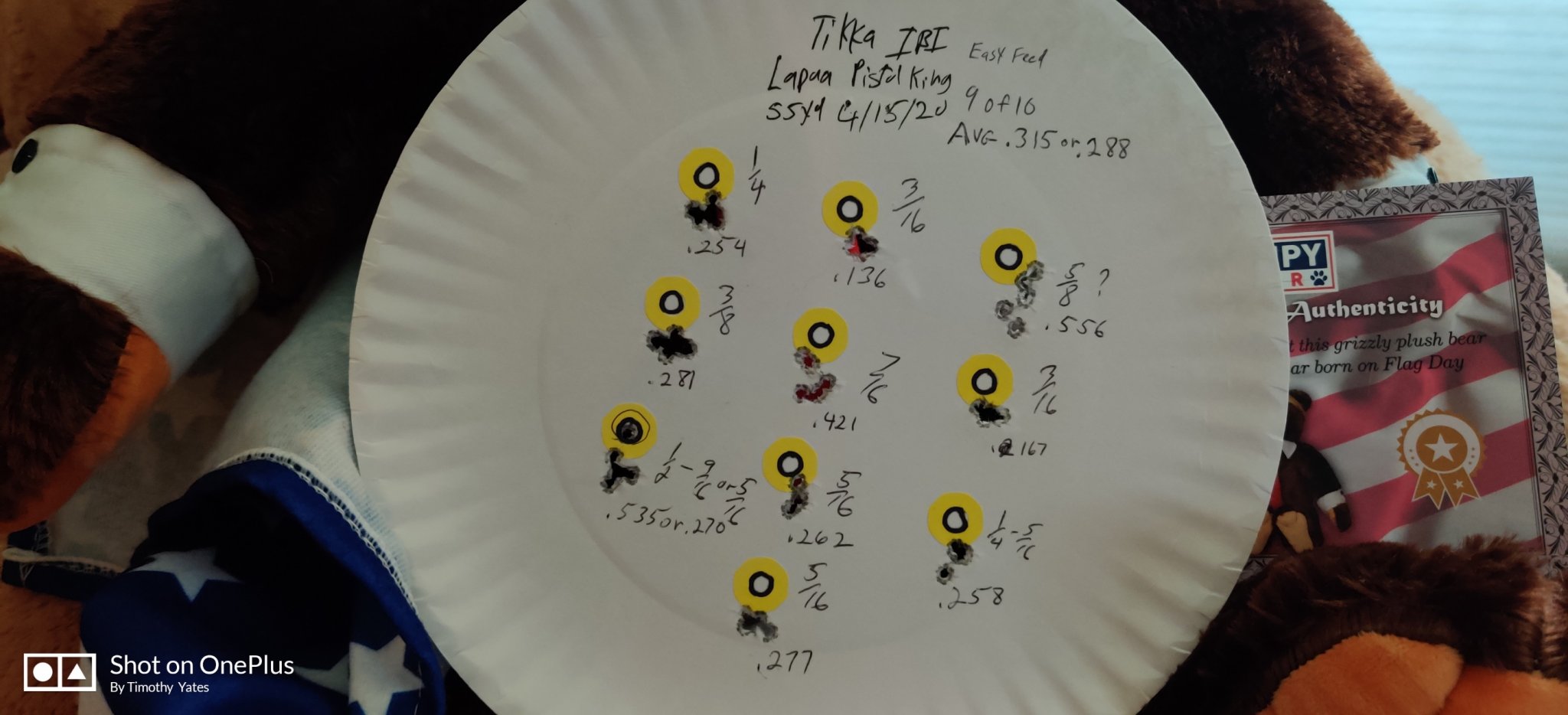

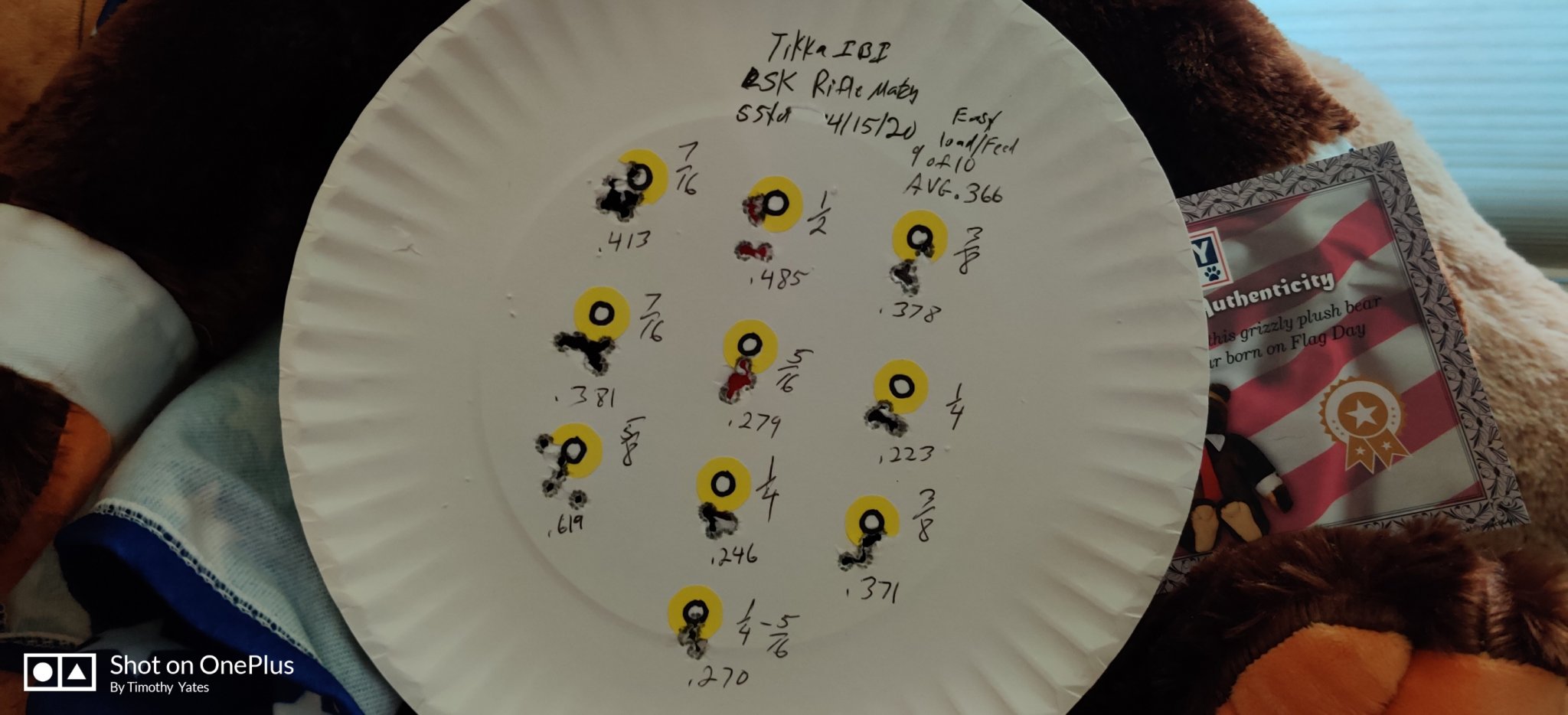

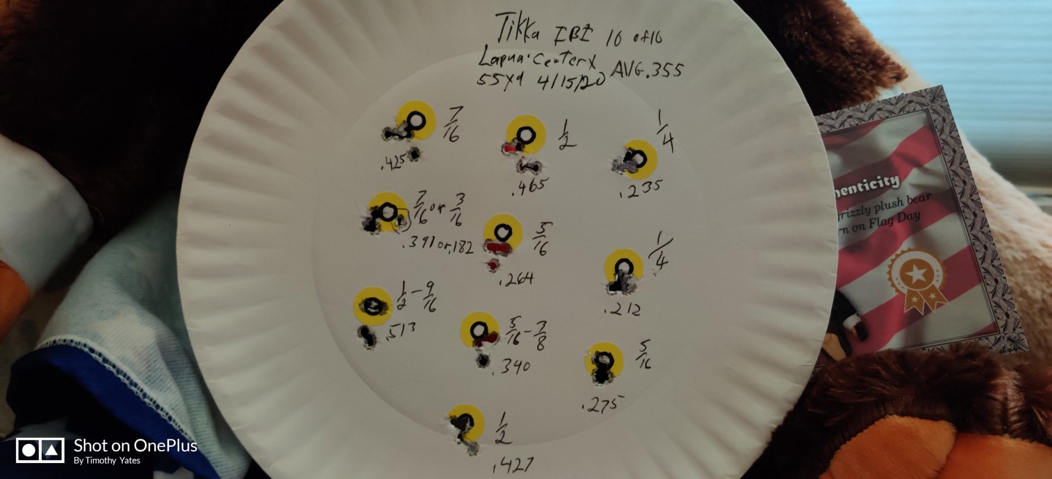

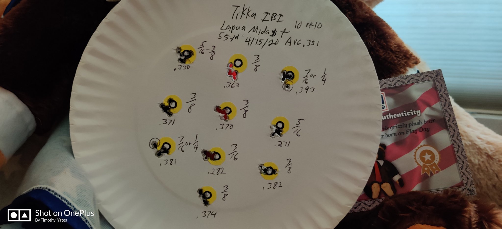

Too bad IBI don't offer the Win 52D chamber any more. Here's performance on 5 different ammo. These were all shot the same day back to back to back without cleaning. All shot at 55 yards, ten 5-shot groups.
  • Wow
Reactions: nakoa01

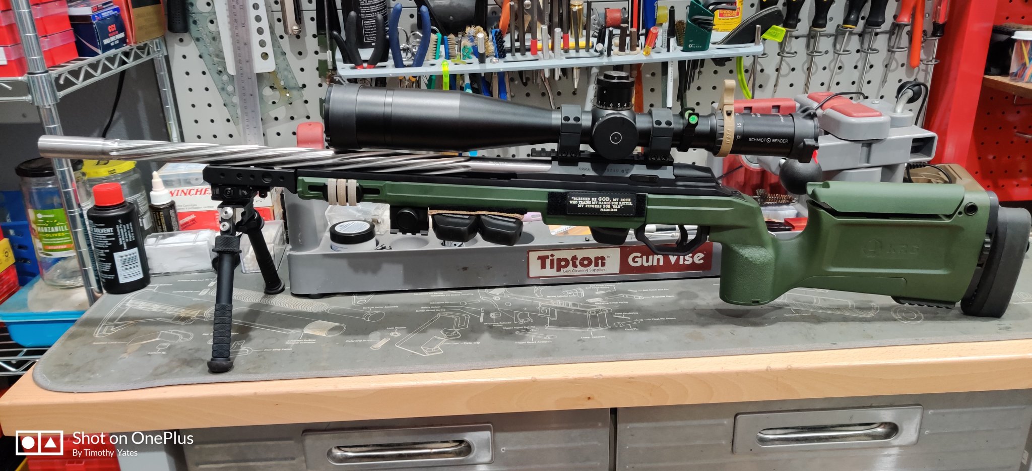

I'm pretty sure I mentioned I was going to replace the stock barrel on my T1X with a Lothar Walther prefit. I don't remember where I mentioned it tho...
Anyway, it took much longer than I expected. I had some good advice on how to remove the stock barrel that wasn't successful, at least not by itself.
Ultimately, I made a strong support for the action out of aluminum billet so as not to mar the action. This plus a 10" piece of cold rolled steel to tap out the barrel worked like a champ in conjunction with ATF/Acetone and gentle taps with a 4 pound sledge (gentle taps).

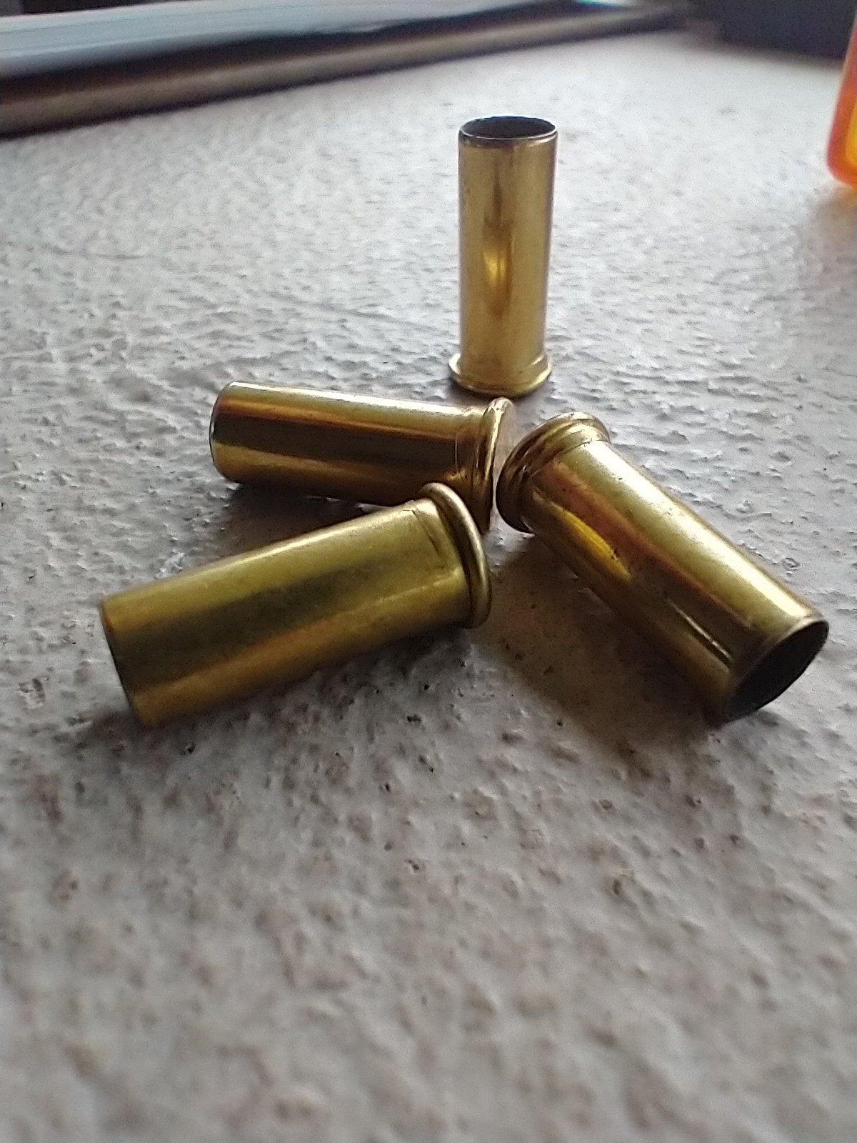

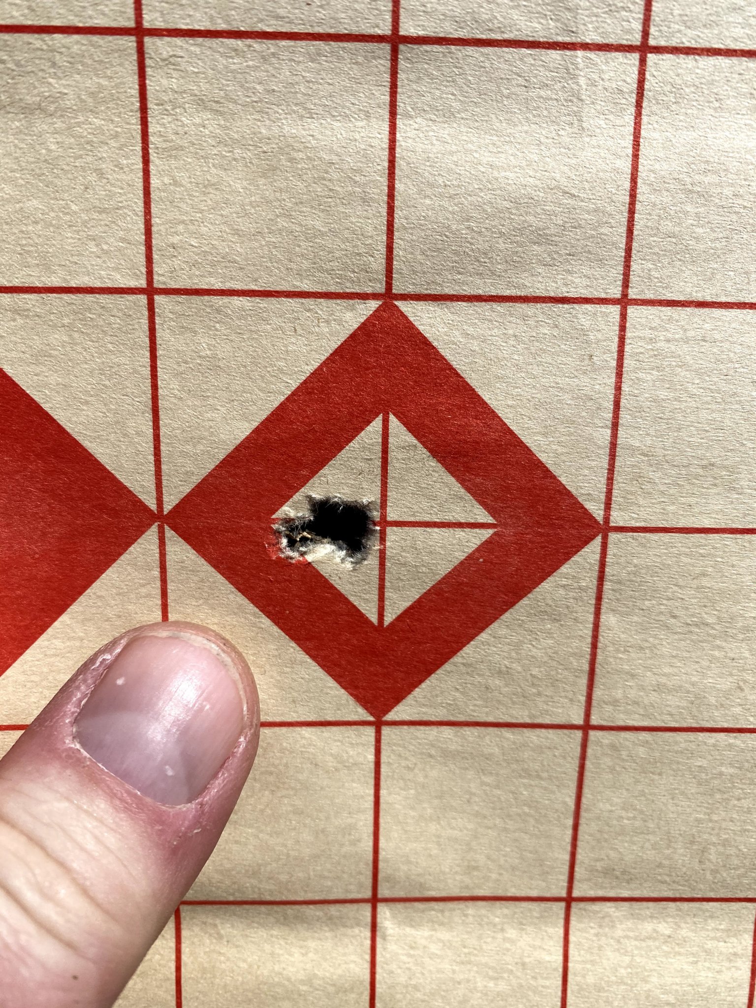

Anyone notice their brass looking like it's about to blow due to the feed ramp cut on the LW barrel? I haven't had a case rupture yet.... Eley ammo, 1066fps
