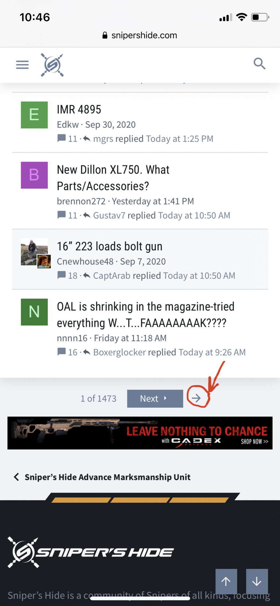

Yeah... if you click the “next” button.
If you click the button I circled I’m red though it takes you to the last page.
Son of a Bitch your right!!
Actually I pulled the number 1,453 out of my ass. Not realizing it was 1,473 to get to the last page.
Either way it’s pretty interesting to see how far things have come when members find these in the archives
