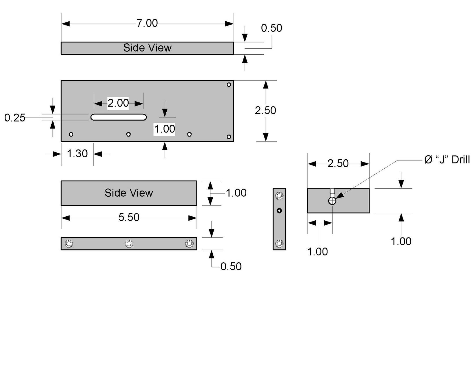

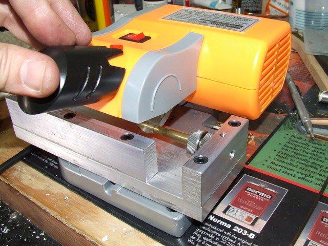

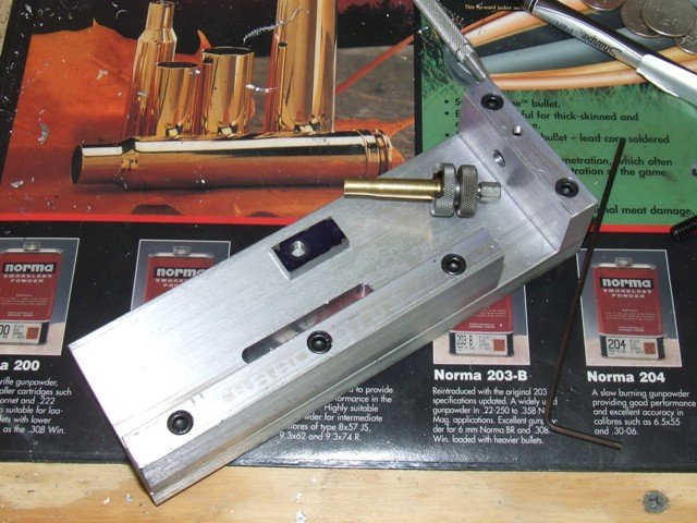

    Here's another option for a jig to hold your cases for that HF mini chop saw. You'll just need to lengthen the slot that is 2.00" long, another .75" to the right.
    Also, I've attached a photo showing it in use (it uses the cheap Lee case trimmer, case holder in the 2.50" fence with the "J" drilled size hole).
    Just drill a hole in the HF saw base plate and use a square nut to lock the jig into place and set the distance form the fence the blade cuts. When drilling the plate, ensure that the rear fence (the one closest to you) of the jig is positioned in enough to act as a stop for the saw.
    Easy peasy...
    And if the BLK case is anywhere close to the 300 Whisper dimensions, then with LC brass, you will need to neck turn. I've typically gone the other route with forming (.223=>.221FB => .300 Whisper/17 Mach IV/.20 Vartarg), basically due to the dies I have and the other cases/rifles that end up needing .221 parent cases...
