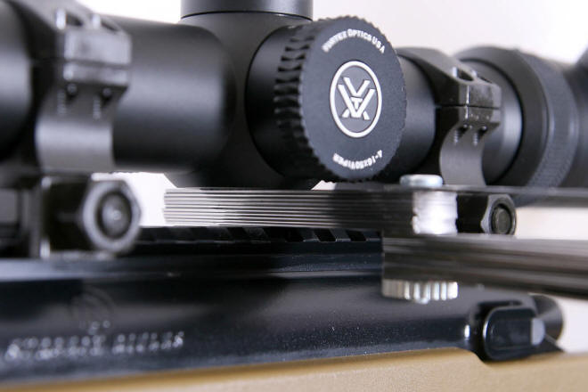

This may seem basic but the results speak for themselves.
Make sure to choose just enough gauges, don't want to compress them when tightening the rings.
A slip fit.
R
