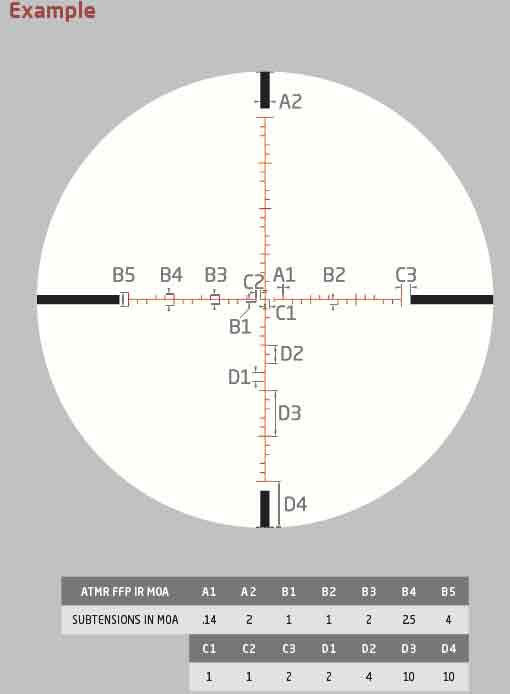

I have a cheaper Athlon Aeros BTR FFP 8-34X56 ATMR. The center lines are 0.14 MOA thick.
That's about 0.88" thick @ 600 yds . The X ring of a F-Class 600yd target is 3" in diameter (7.07sq. in).
The crosshairs cover about 72% of the X ring but it is still quite visible and you can still move around in the X-ring.
Sounds like a lot but it's about eye-of-a-deer :)
Find the reticle data for your scope, here's mine
