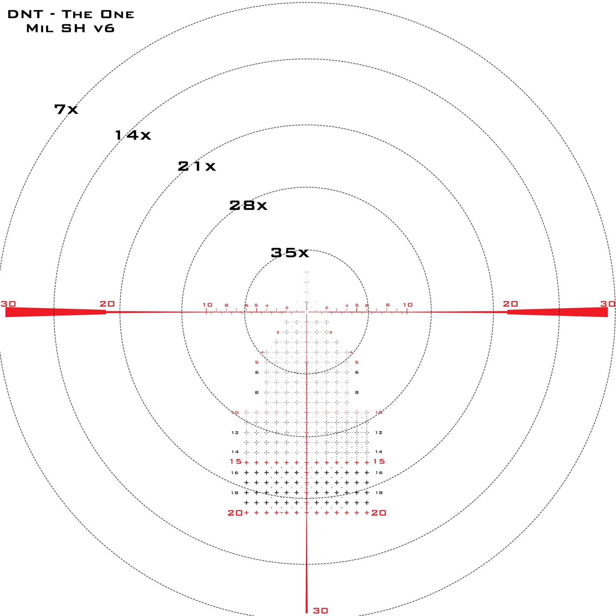

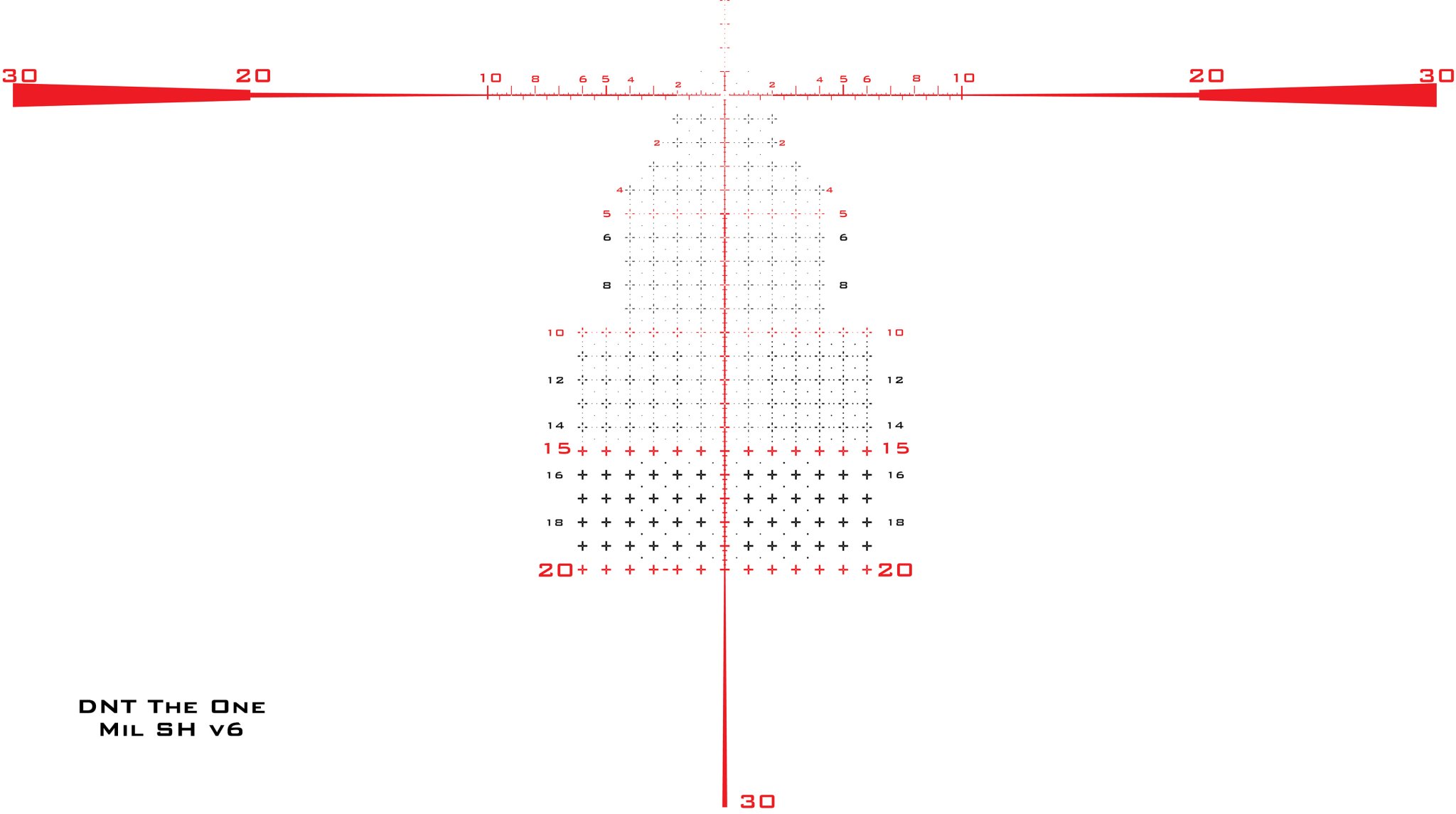

The SFP ranging box is a really cool concept, but I don't think it is relevant to this thread. My understanding is DNT is looking to simply change the etched reticle on an existing scope of theirs, not spec out a completely new optic.
@BigJimFish have you reached out to PA with this idea? It seems right up their alley, could easily apply this idea to their 18/72" acss ranging feature.

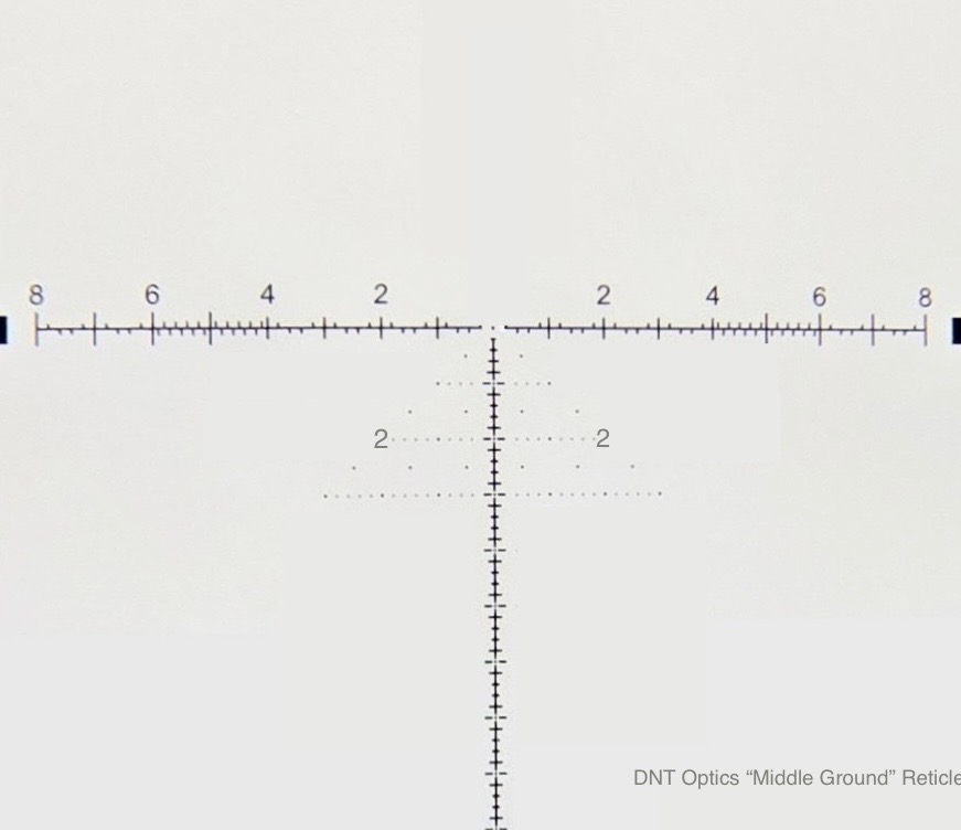

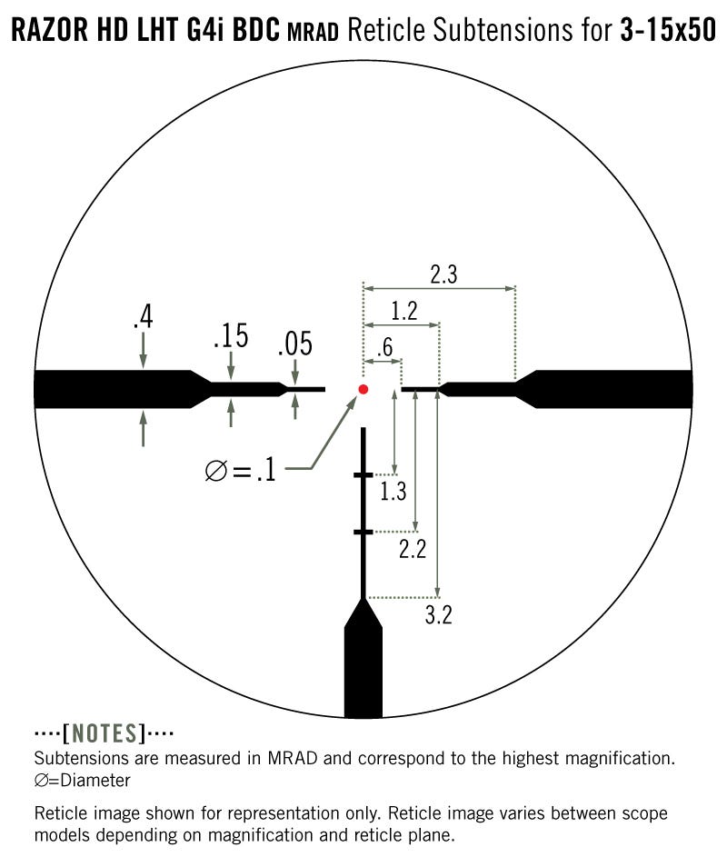

In general it seems to me the reticle designs should try to maximize the usefulness for the ways 90% of potential buyers will be using the optic 95% of the time. because trying to make the optic usable for every niche application demands compromises which makes it less usable in those 90-95% applications.
Examples of such compromises would be, in my opinion, windage marks that extend past 5 mils instead of having nice thick bars up to that point. Or having vertical stadia more than 2mil above the center... Or perhaps having vertical stadia anywhere above the center.
I actually think making these sorts of compromises are a mistake nearly all optic companies make particularly in the long range target shooting market. A reticle design that did away with them could be really strong for the way most of us use these optics.... And let the people shooting niche applications buy something else.
