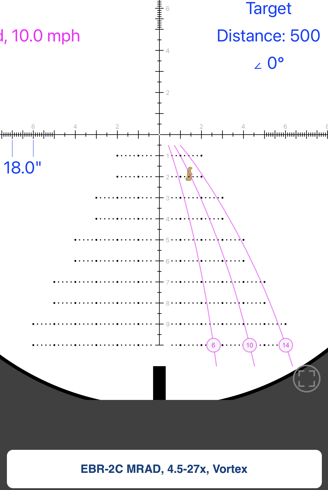

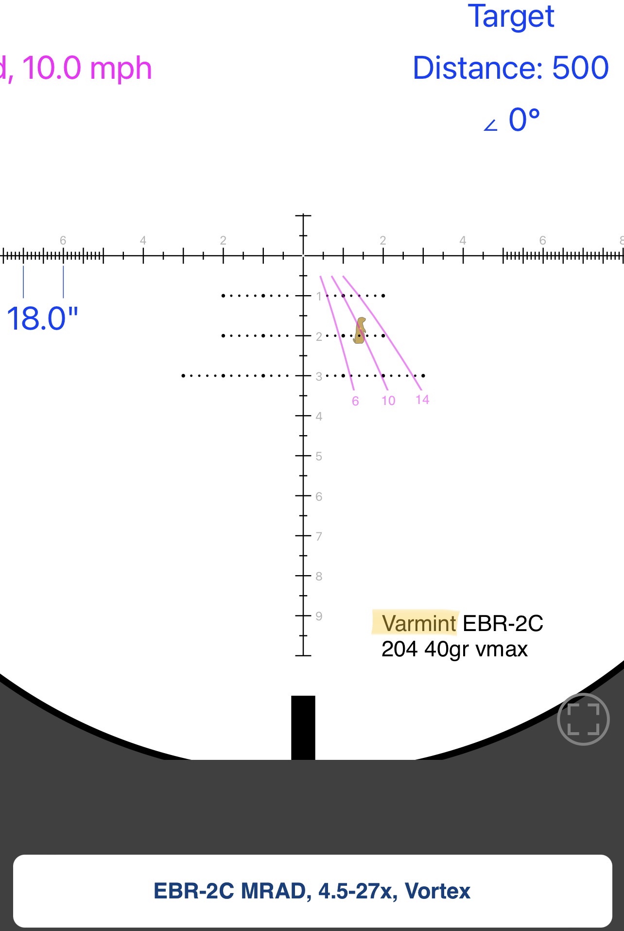

I just have a hard time believing people that suggest this "Tree" reticle has too much information or its distracting or it covers up too much. GTFOOHWTBH :unsure:
20250205_132356-2-jpg.8609684
I think a big issue is a lot of people who only shoot white painted steel targets on nice open ranges don’t get so much the practical aspect of what they’re asking for. Not dissing them at all, but that’s not how everyone shoots.
Right on. Preach brother preach! 😂
I love this reticle, the vortex EBR-2C. While .2 holds might be helpful, what’s great about this thing is the .5mil holds really open the view up.

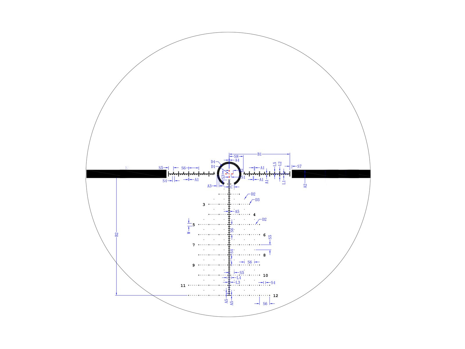

@koshkin designed Meopta reticle pic is attached.
I love my .1 MRAD thick illuminated TMR as I can use the hash marks on 9x.
-Stan
By open center, I mean a center dot and then open space before the windage hashes begin at 0.2 mils. This applies to all magnification ranges. I feel like starting the hashes inside of this crowds my aiming point. I also find it less distracting to keep all .2 mil hashes on one side of the windage cross bar and 0.5 mil hashes on the opposite side.
I don’t see an issue with most reticles in 5-25 and similar zoom ranges. The big miss has been in the 3-18 range, or what I think of as the best compromise for a cross over mag range. But I shoot in the southeast where we have a good mixture of woods and fields and the best hunting has always been in the woods (for me), so reticle visibility at minimum power needs to be optimized.
If I am shooting at a square range then I usually find the 3-18 mag range to be lacking in magnification but the reticle size is fine. When I am hunting and have the scope on 3 power, and it is in the middle of the day when illumination is useless, I find the reticles to be way too fine.
I have a Riton 3-18 on my 22 and while I have mixed feelings about the IQ on minimum power (it suffers from excessive spherical aberration), the T3 reticle is just about the perfect thickness and the illumination is truly daylight bright. Squirrels and tin cans beware.
-Stan

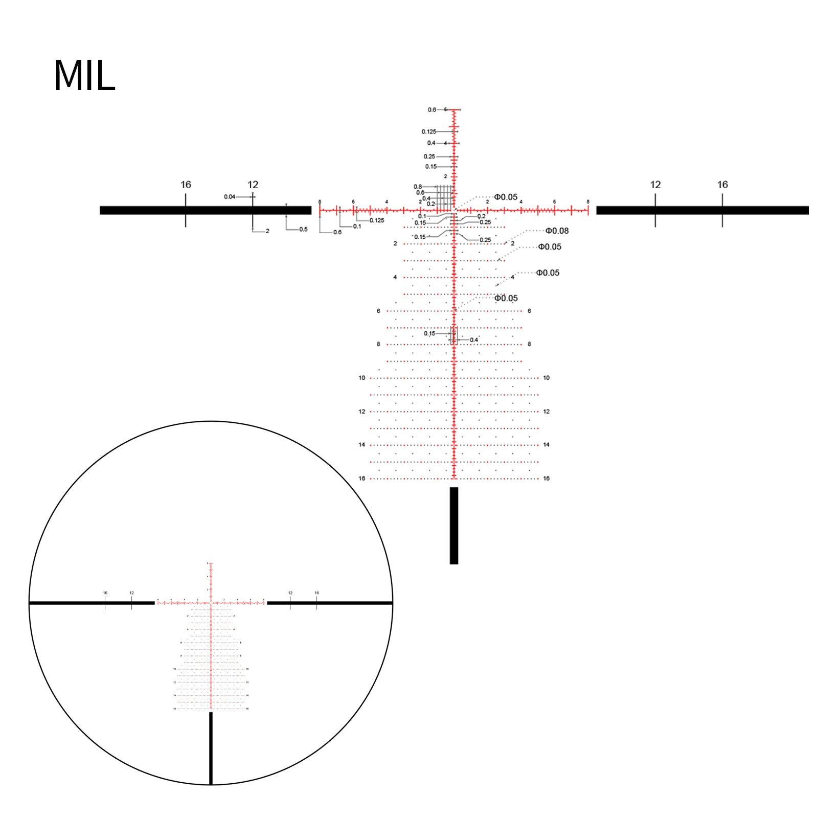

What's the magnification range of each scope and for each reticle?
Edit, I have the Mildot3 .5 mil hash reticle in my Meopta Optika 6 5-30x56. It's on the thicker side for a 5-30 at .05 mil. The center cross is .4 mil, the mildots are .2 mil, and the hashes are .25 mil wide, those make it easier to see vs my H59 which is all .05 mil. I chose it because I wanted to use it on lower power but not fully down to 5x, as well as I wanted a simpler reticle for a change.
Reactions: stanley_white
3-18:
4.5-27:
5-30 with a slightly different reticle:
-Stan
3-18:
4.5-27:
-Stan
I'd be fine using that reticle in a 3-18.
As long as you leave enough space for the floating dot, do not make it too tight.
The dot is the heart of the reticle.
Agreed.
Those center dots with only .01 MRAD to the crosshair infuriate me — .02 minimum please.
I want a distinct center dot not an interrupted crosshair.
-Stan
