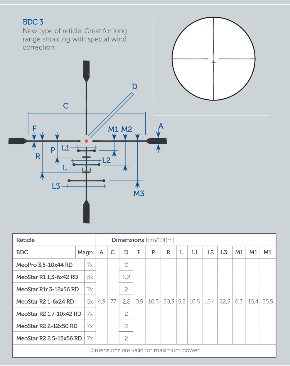

This reticle was designed around the .308 with a 168 gr bullet at 2627 fps and a BC of .442.
Thank you sir for letting us know that. (y)
