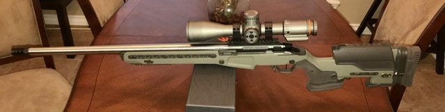

Pmr sunshade arrived and clears easily with this mount. Have room to manipulate bolt as well.
Hopefully get to sight it in tomorrow
