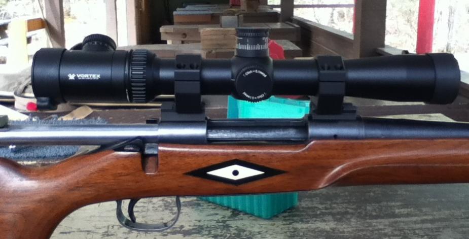

    Here is a picture of it mounted on my 270 Win hunting rifle:
    Another feature I love about this scope is that it has a long enough tube to let me mount it on a two piece base set with a long action rifle. I have had other scopes that too short a tube to allow this, which means needing to use a one piece rail that blocks access to the magazine.
    I mounted this scope up with a NF two piece, 20 MOA picatinny rail and a set of low Vortex rings. Even with low rings there is lots of room between the barrel and the objective. With the butler creek cap, there was just enough room for the bolt to clear and not be in the way. (The objective uses size 13-15 Multiflex and the eyepiece uses size 16). I was able to boresight and get on paper on the first shot, needing only 0.5 mils right and and 1.5 mils down to get right on target. I then did my scope tracking check, and it was dead on at 2, 4, and 9 mils of elevation travel. That was enough for me to confirm the scope's quality and function on a cold (32F) and breezy March day.
