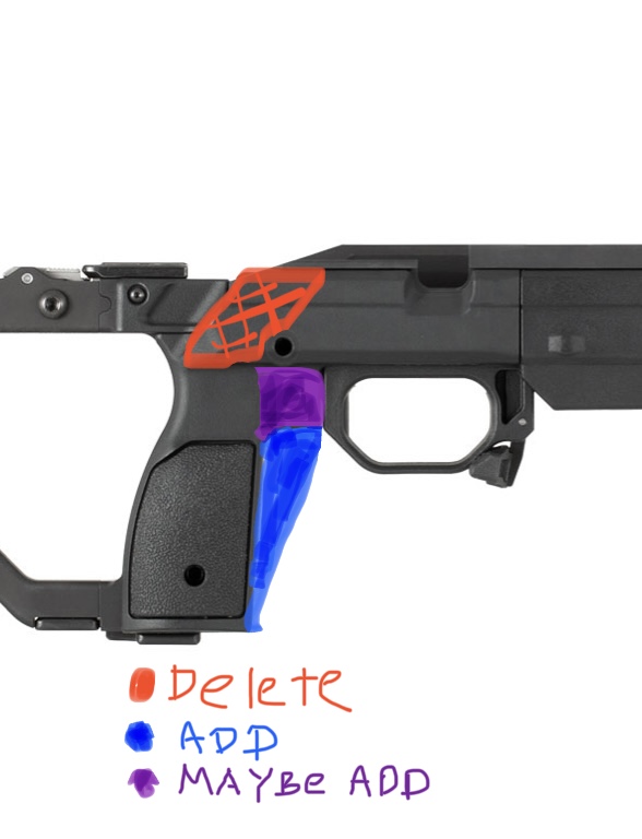

I dwelled upon the design of the MPA trigger finger-bump.
I then penned the thread at the top of this post; Tyler said he just needed somebody to send in a chassis for a 3D scan.
Here's my awesome drawing:
$100 bux later, I UPS'd the chassis in to MKM last April, and Tyler and his team went to work. They are busy, so they just barely got it done for my July prairie dog shoot, but Fedex delivers to the middle of nowhere so all was good.

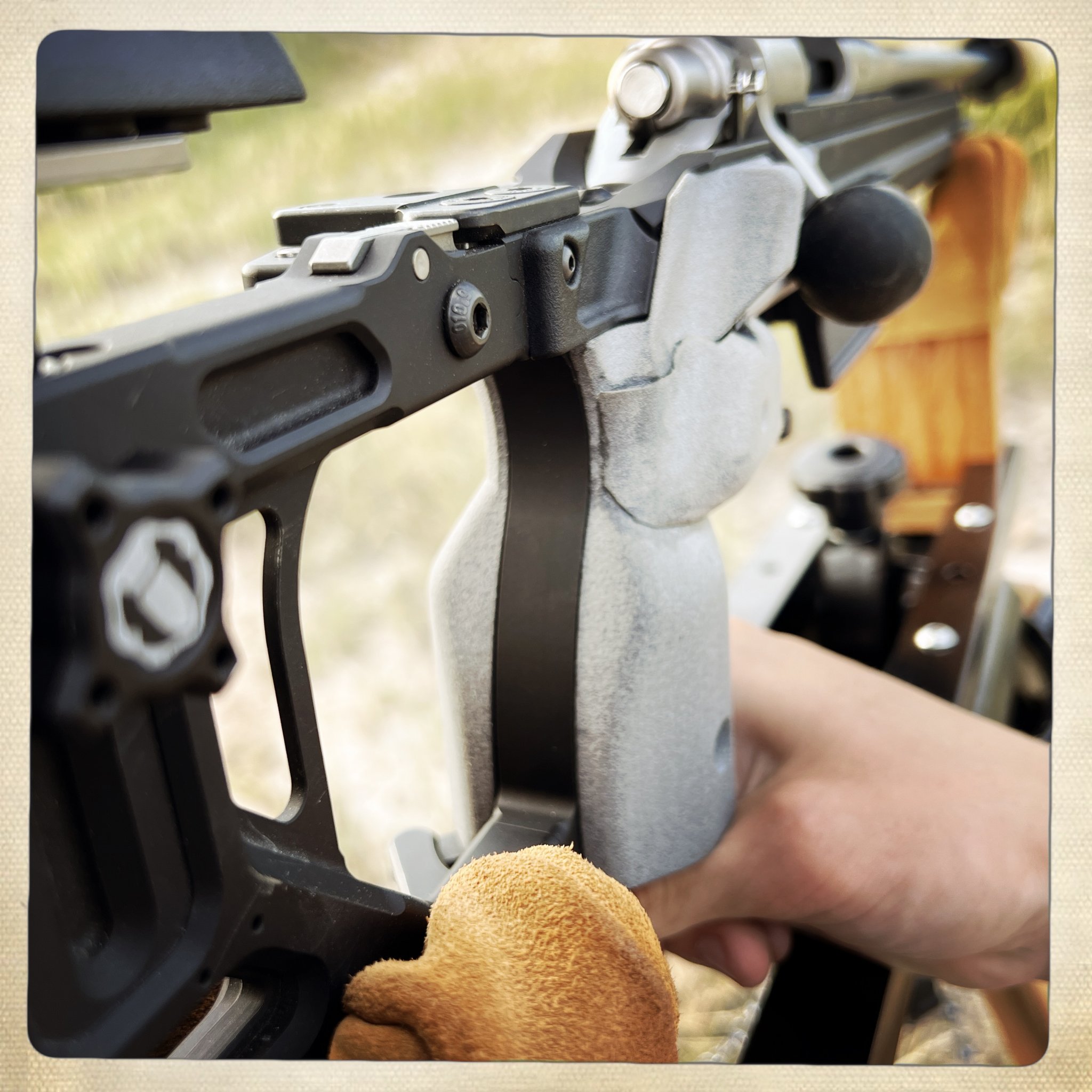

Enough Sniper's Hide inside jokes! Tyler said to lay it out in a review, so here we go. Due to time pressure, I'll add to this review slowly vs all at once.
(>>>REMEMBER THIS IS A PROTOTYPE GRIP<<<)
PICS FIRST DAMNIT

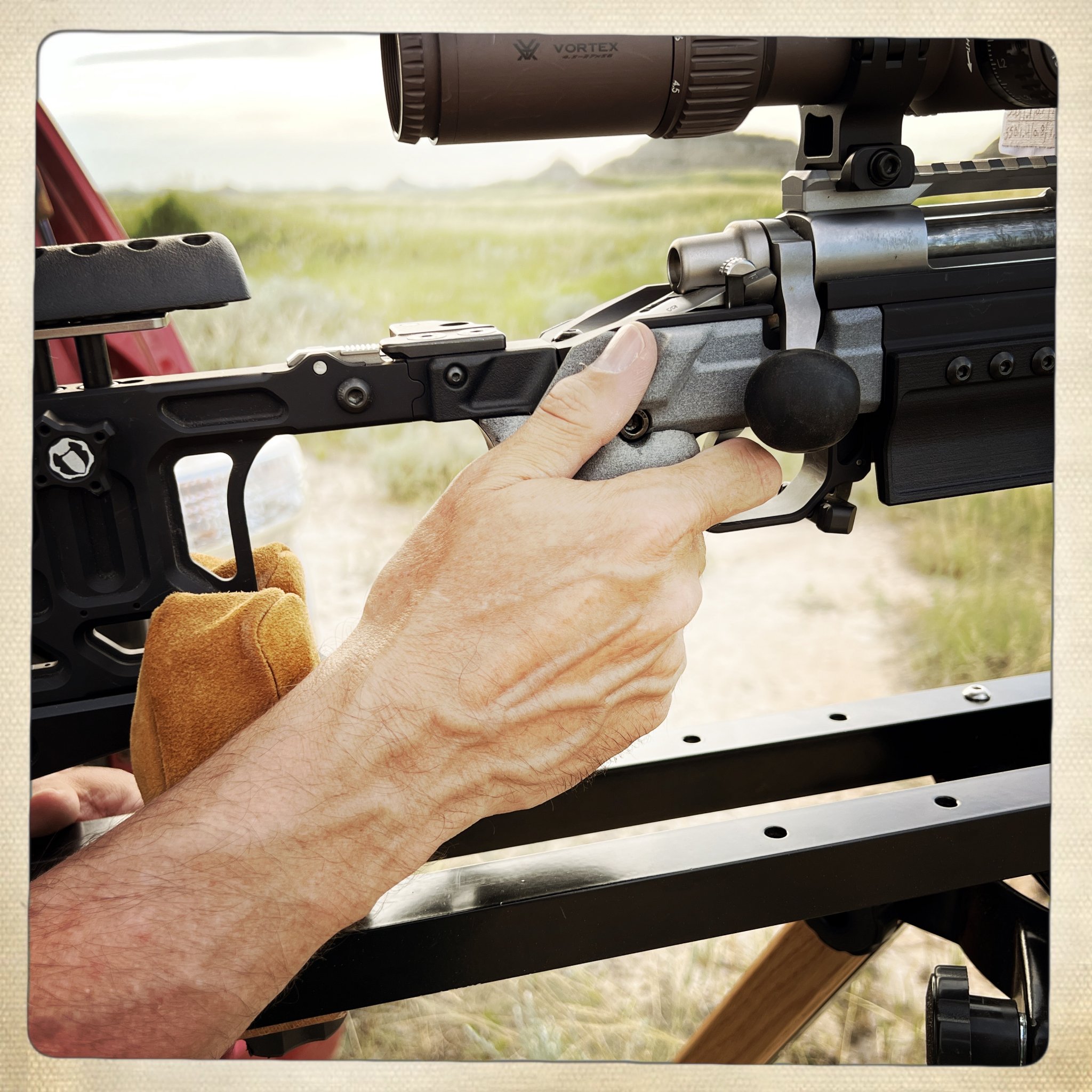

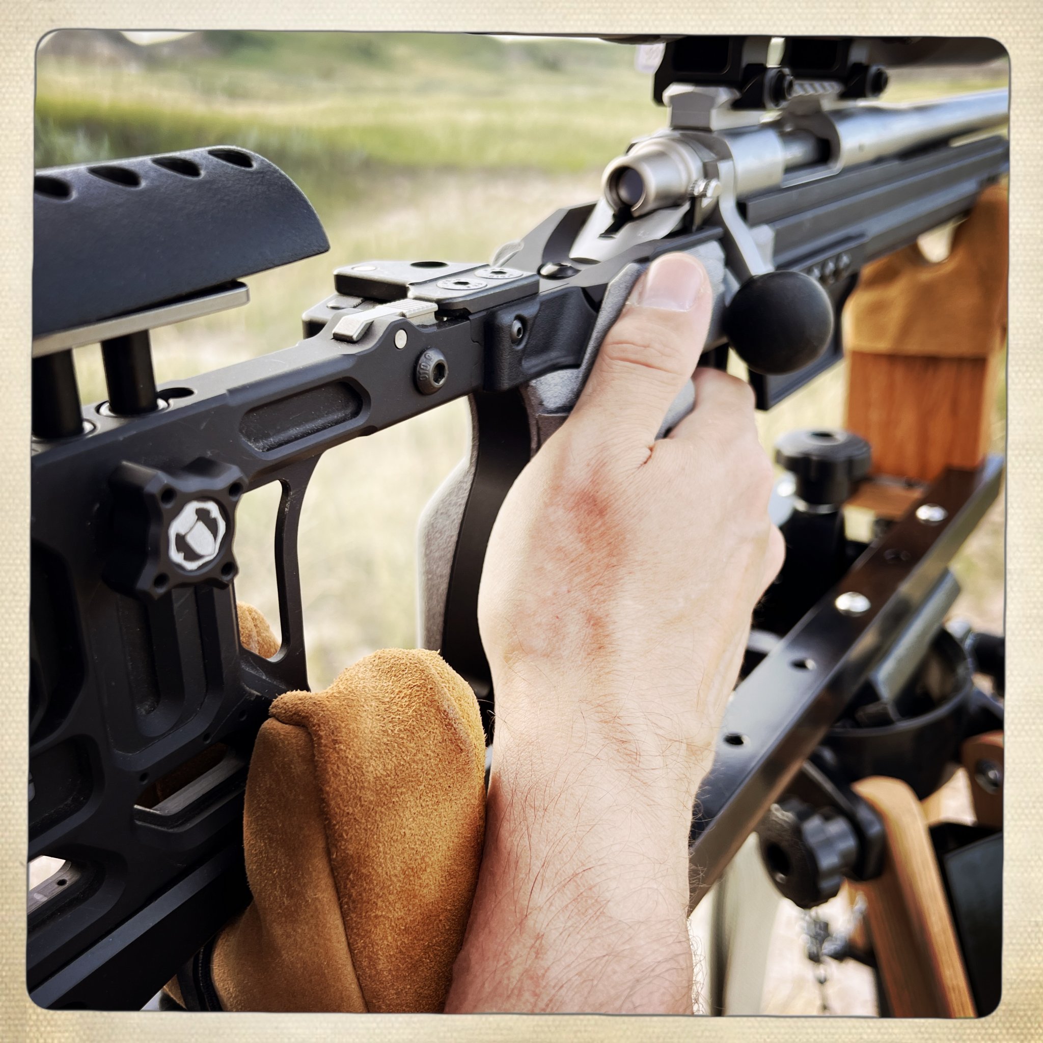

QUICK NOTES, GRIP
  • It's a prototype grip, not finished
  • It's made of some stuff that is super-tough and different than regular 3D printed material

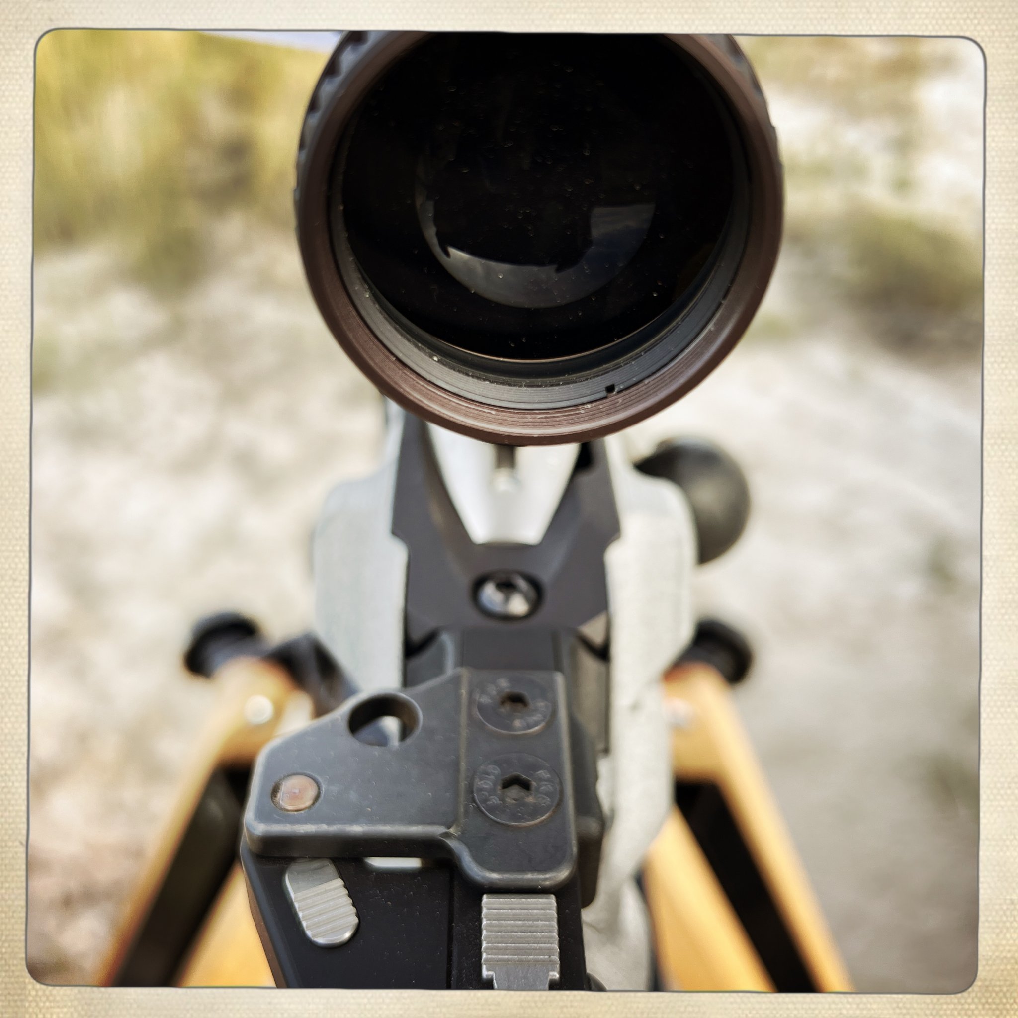

  • The grip adds material on the front, which brings your middle, ring, & pinkie fingers further forward. This helps relax and position your hand to squeeze the trigger at 90º
  • The grip I got was smaller on the left and had a nice palm swell for the right and feels substantial
  • The "index finger bump" is optional* but REALLY helps that 90º squeeze, at least for this fool
  • It allows the thumb to fall way further forward than stock. The stock location always felt like I was thumbing a ride with Cheech and Chong.
  • I sanded down a part of the finger bump for comfort
  • It has a slight texture to it (me like)
  • The fit on the chassis is pretty good, not perfect. It’s a prototype.
  • LOTS OF DETAILS ARE UNDETERMINED for the final production version. Things like texture, etc. But I don't think they'll all have a thumb shelf on both sides.

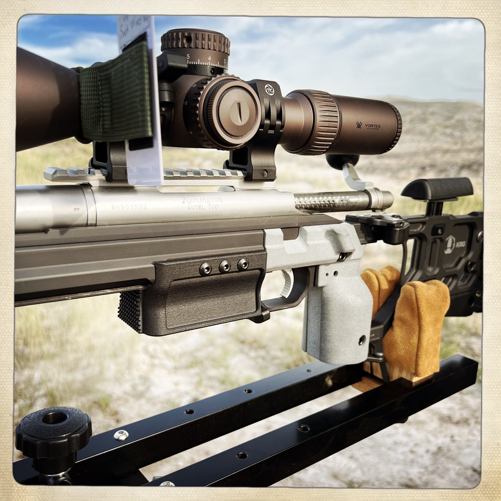

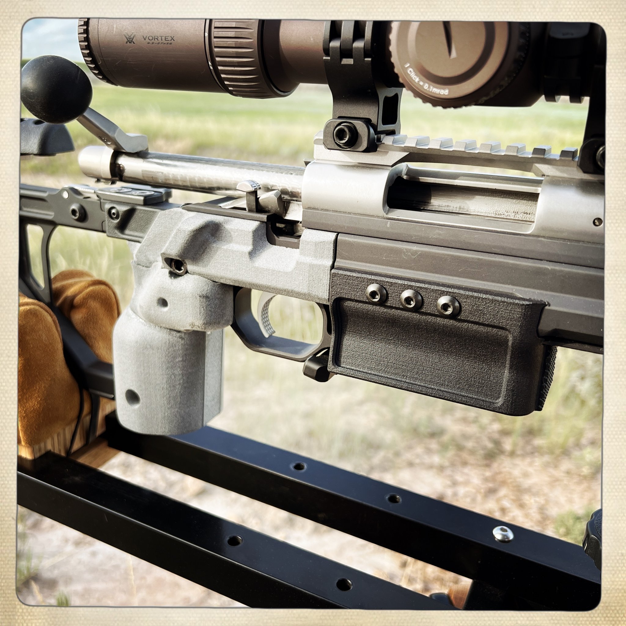

QUICK NOTES, MAGWELL
  • It's a prototype too, I believe**
  • Made of more regular 3D printed-type of material vs the Adamantium-like wonder polymer of the grip
  • Works well and looks cool, serves as a barricade stop (but I have no barricades ha)
  • Turns my W3 into a Vision chassis lookalike, sorta. The W3 should’ve been designed like this from the get-go.

Everything pretty much rocks. Especially after I sanded the bottom of the the index finger bump. Magwell helps guide mags and looks cool. Tyler of MKM does some impeccable work. I told him it has really transformed the chassis for me. Super comfy. So much so that I need to get a thumb rest for my AIAX as now that sort of feels like ass lol. Goddamnit I just had to work in a mention of my AI; I am a sad sad man.
Footnotes
* INDEX FINGER BUMP: The way it's designed is that It's supposed to bolt on, but MKM forgot the bolts, so I bought some epoxy and glued it on there. It's a prototype, remember, and I'm gonna send it back for scanning.
** MAGWELL: MKM forgot the bolts on this one too lol, but they are too awesome for me to care. I used some old KRG bolts I had laying around. It seems to be designed to use smaller bolts that would sit flush.

Ok, so here's the second part of my review.

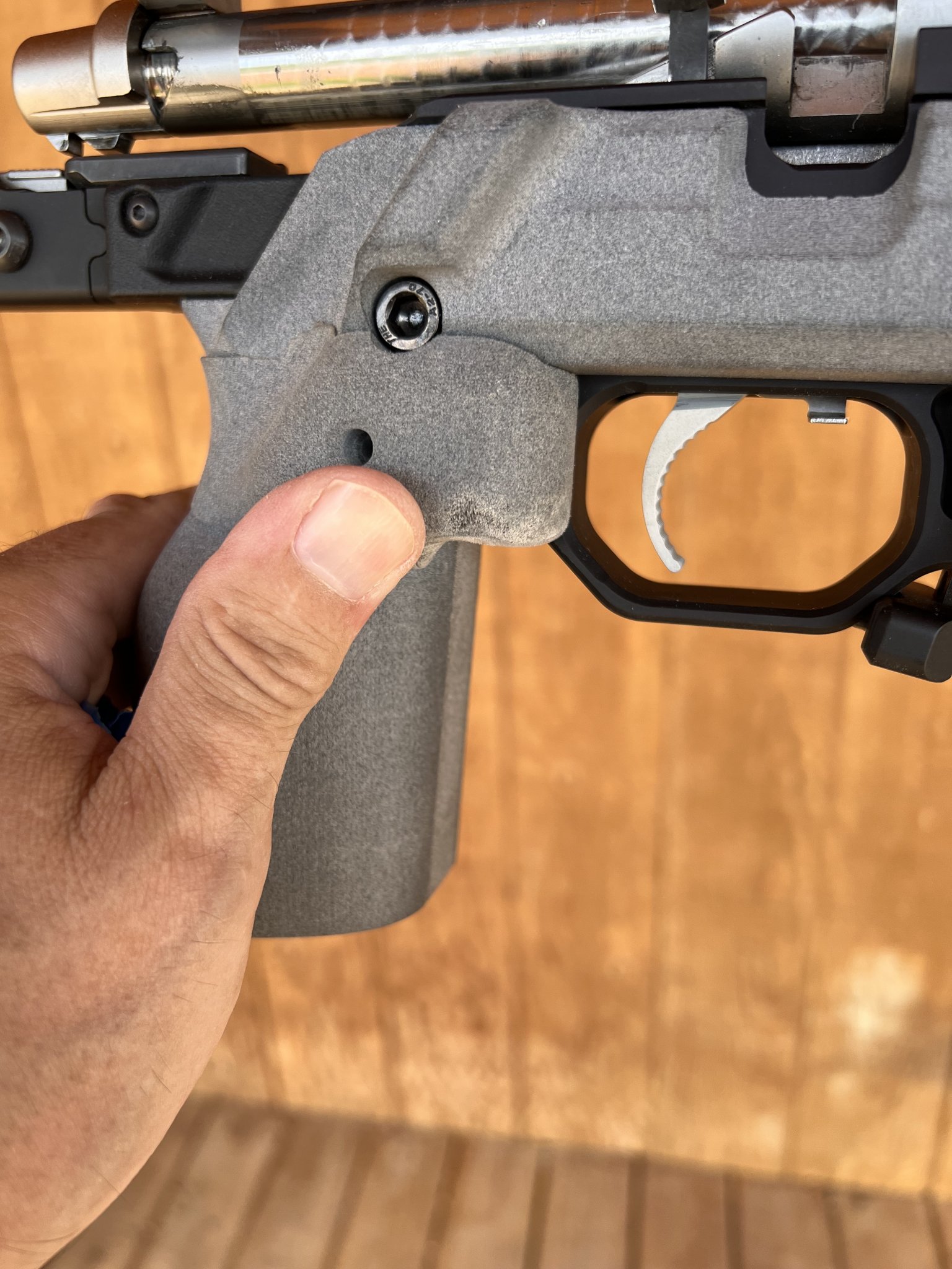

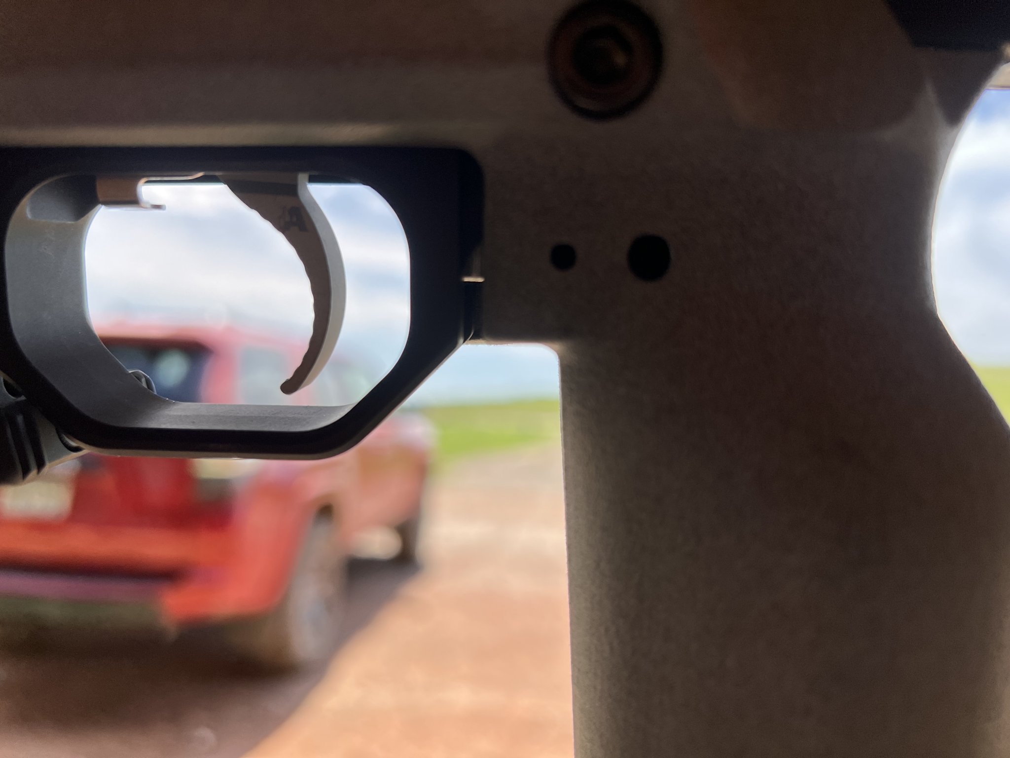

The only thing I didn't like is that the trigger finger bump-out hung down a little too far. So I sanded a part of it off, but I think I may have sanded off a bit too much. A little hanging down is ok as it provides a consistent vertical reference "stop" for your hand.
After sanding…
I think I could've sanded half of what I did and that would've been perfect. As it is now, if I place my hand on the grip as far up as I can my trigger finger is a little too high. I then have to slide my hand down a little bit. Perhaps MKM should leave it long and instruct people to sand to fit???
I was going to expound upon my first post, but I think I've said it all. This grip MADE the chassis for me. I think few manufacturers really think about the index finger-to-trigger interface (especially looking at you, Manners & McMillan lol).

Well hello all, and thank you for this post! We spent quite a bit of time getting the ergonomics to feel "right", and I am pleased with the results.
There are a ton of these chassis out there, and I think it's a no brainer that many folks will be slapping these on.
We've got a bit of "wrapping up" to do for ease of manufacture and aesthetics, but I anticipate selling these in September.
Also did a cheekpiece, magwell (pictured) and modified bag rider for the Whiskey chassis. If there are more requests, I'm all ears for what to make!
