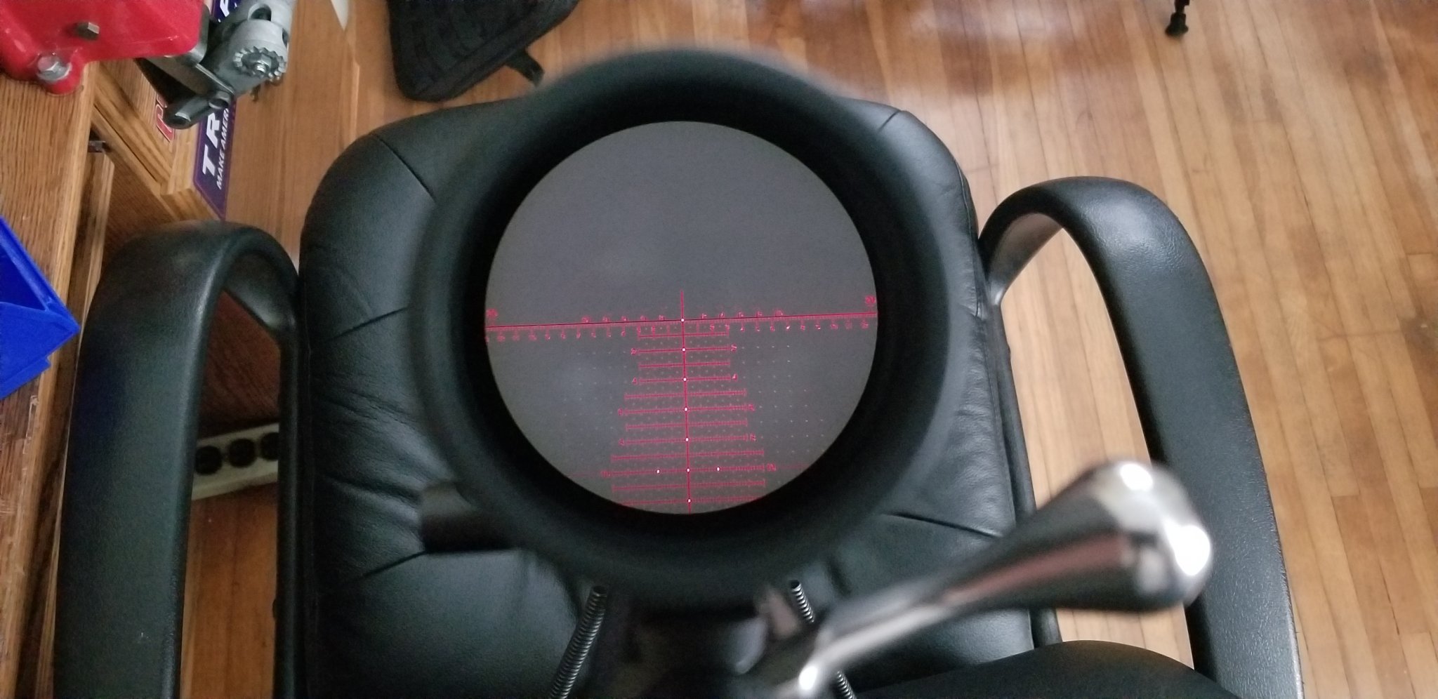

ETA: Good morning. So going back and looking at the image of the illuminated H59 reticle on the previous page (copied below for your convenience), mine does not come near this level of brightness. As stated above, it appears to illuminate as bright as my previously owned H37 equipped S&B, which I was under the impression was quite normal. The center line vertical dots are lit at every even numbered mil increments with horizontal indicators at the 10 mil hash, but the reticle itself is nowhere near as bright as what is shown in the photo (no illumination observed in daylight/morning post-dawn sun). Looks good during hours of darkness and limited visibility (nicely illuminated reticle structure), but that's about it. I don't really use illumination during the day, but just curious to know what others have noticed in theirs. I'll try to see if I can't take a through-the-scope pic today. Not going to return it or contact EOTech if it's a nothing burger, but would like it to work the way it should if what I'm experiencing is not the norm.

Reticle illumination (full on):
ETA: comparing it to the above image, it appears the photo provided by the OP might have been taken with a front scope cap in place? If so, you can expect similar results given dark/nighttime conditions.
Reactions: jet66
I noticed the same thing with the illumination: You have to be looking into near blackness to see it that clearly. Even in normal room lighting only the central dots are nominally 'daylight bright.' Not a deal breaker for me, though. Mine went on a KAC LPR, so the relative reduced size and weight compared to other higher power optics is what enticed me, especially for the price of the Dvor deal.

Good copy, Jett66. I figured that was the case. Like I said previously, pretty much what I expected given my experience with the illuminated H37 on the S&B. Just wanted to confirm since the OP's image threw me. What's been your experience with the elevation and windage click adjustments?
