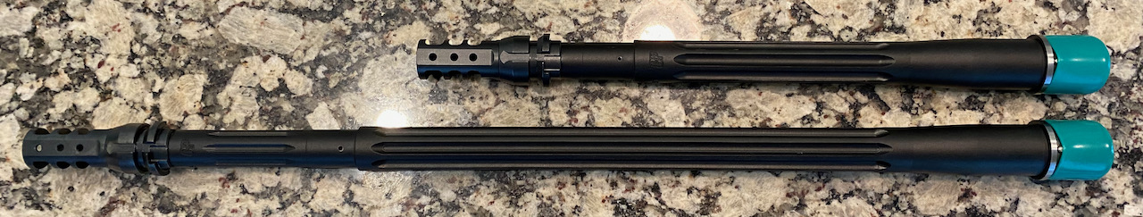

You can do a light rifle, but there are tradeoffs. I would not even attempt with an AR10. @LRRPF52 suggests what I do - stick to an AR15 and do the 6.5G or 6ARC. You can easily build a 10lb all-in AR15 that'll shoot out to 1000yds consistently well. If you want to get down to 6-8lbs, there's many more tradeoffs involved. Going with a bolt gun will get you there with less tradeoffs, but also lacking semi-auto and the modularity. I find an AR15 + one of those two calibers to be about the perfect balance. If I were primarily hunting the largest of the CXP2+ game, with range use secondarily, I'd probably err to the 6.5G. If primarily shooting at the range and hunting deer and pigs or smaller, then the 6ARC. Either will do both relatively well, so there isn't really a bad choice. I'm partial to the 6ARC since I spend more time at the range than out hunting, but I love the Grendel too.
@LRRPF52 do you mind laying out that build? I'm curious about your barrel profile. My 10.5" 6ARC is 6lbs 10oz, and 18" 6ARC is 7lbs 9.6oz without optic, but the barrel profile holds up to long strings of fire. Here's the 10.5" and the 18", at 1lb 6.7oz and 2lb 4.9oz respectively (including the notoriously heavy Keymo brakes). Most of the ultra-light AR15 builds I see are pencil profiles. 0.750" gas block journal for reference.
My Lilja 17.6” build uses one of the Wasp profile barrels, with it being .650” under the handguard, steps up with normal shoulder, down to .750”, then .740” to the muzzle. Very light.
I used an Aero M4 upper without forward assist, standard carrier weight (currently has a Bootleg adjustable gas carrier in it), Midwest Industries lightweight handguard, BCM Gunfighter CH, carbine RET, SPR grip.
