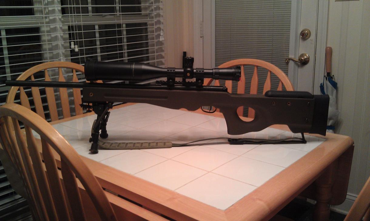

My wife and daughter's Leopard MKII
I put this together for them as they did not like the larger thumbhole of the original stock.
This rig will shoot accurately at 300Y... I may still inlet and bed it; however, it shoots very,very well so for now I will let them just practice and enjoy.
The chassis is very tight.. and there will be some leisurely sanding needed down the barrel side..but a good little project.
Bri
