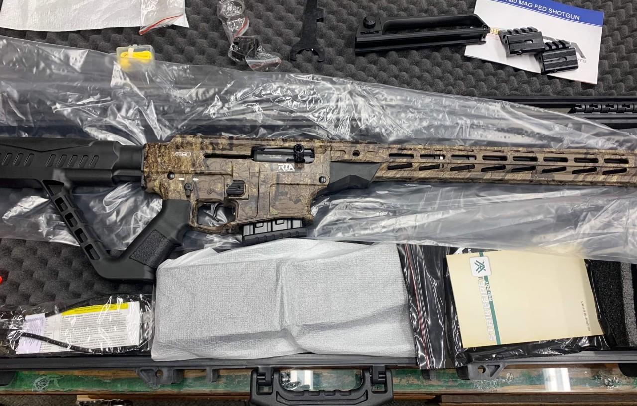

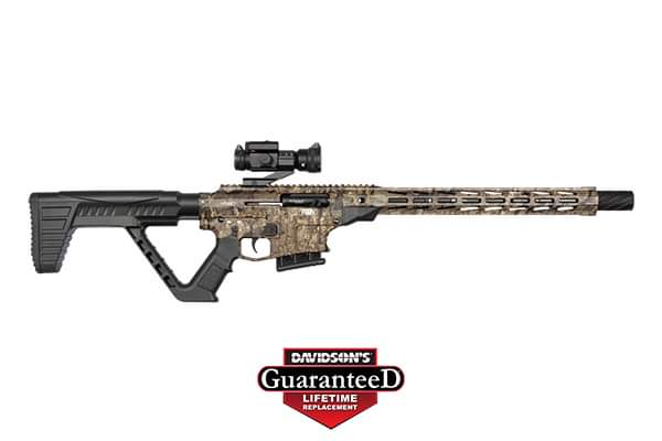

This is the one my son has and mine when I pick it up will be the same
