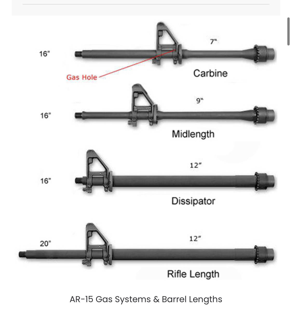

    The dissipator rifle has been around for a long time. Iffin I’m not mistaken, the point of that design was to push the gas system as long as possible to help with dwell time and port pressures.
    I guess my statement was that the idea plus length gas systems is not new. It just seems to have a little more following and aftermarket input than the dissipator style ever got.
    The Dissipator was a carbine length gas system with the A frame sight mounted rifle length.
    The dissy was a 16 inch barrel with a rifle length gas. Essentially a plus length gas system for a carbine length barrel.
    No it wasn't, "Dissipator" was a registered trademark of Bushmaster. It was only ever produced in a carbine length gas system. Your picture is incorrect and isn't a Dissipator, Colt's experimental 605 versions were cut down 20" rifle barrels and would have had lightweight profiles. Colt never sold them though and they weren't Dissipators. In the early '00s companies like CMMG sold Dissipator clones, they were also carbine length gas systems. Since then, who knows but the name Dissipator meant Bushmaster and carbine length gas system.
    The picture I attached came from the same article you posted. It even labels the barrel as a dissipator.
    I have no idea which was first or correct but what he says about the Bushmaster guns is what I remember as well. I've seen barrels set up like your picture but the bushmaster stuff is where I first saw it.
    Could have been bushmaster, or maybe way back Vietnam time when they cut down the colts like he said as well.
    My point was that the concept wasn’t new. They have toyed with reducing dwell time and port pressures since the 60s.
    The article he quoted saying I was wrong is the same article that had the picture of the barrels I posted.
