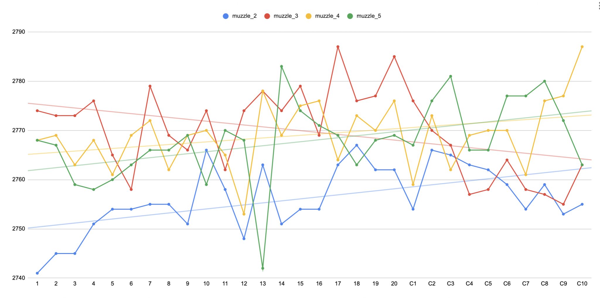

My work is about reducing ammunition performance uncertainty. To that end and with the process I've written about here, I've already seen evidence that there's a measurable effect from case to case. This chart, for example, uses data from a fellow competitive F-Class shooter on the Lapua team. It represents 30 cases (10 "light", 10 "heavy", 10 control/median). He fired each of them 5 times.
Cases 5, 6, 8, 10, 11, 18, 19, C2, C4, C5 all have a velocity spread <= 15 ft/s
Cases 1, 13, 14, C10 all have a velocity spread > 30 ft/s
That's a lot of variability that you can remove to reduce uncertainty and focus on your wind calls instead.
Note: I also have trend lines in this chart to show the velocity increase as the barrel warms up. You'll note that the muzzle_5 group shows a backward trend. That's because he shot that group in a different order for that string -- from least capacity to most.
