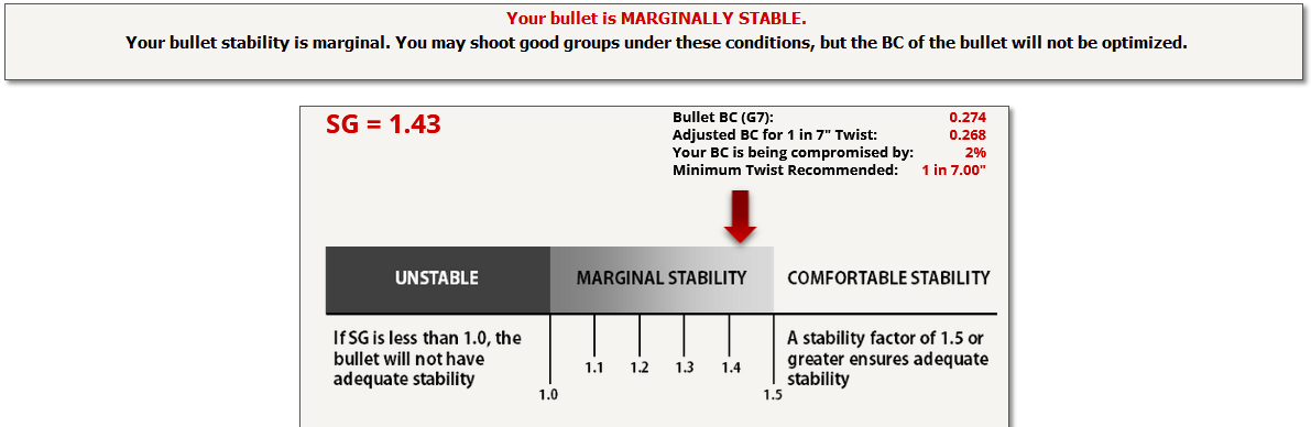

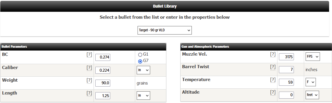

I personally don't think it is stability. An sg of 1.0 will typically shoot a sub half moa group at 200 yards if the gun is chambered well and the barrel blank is good. The bc and stability at distance will suffer.
One thing I do have a fair amount of experience with is bullet failures. I like to shoot 68 grain bullets out of 7 twist 223. It doesn't always go so well when things get hot or dirty. I also like to shoot 105-115 grain bullets from a 243 Ackley. You need a 7.5 twist to stabilize 115s in the cold. 105s at 3200 start to get interesting.
(3200x720)/7.5=307,200 rpm
Anything over 300k can, but won't necessarily create problems.
You sir, are at (3175x720)/7=326,571 rpm.
If you do not scrub the ever living fuck out of your throat to keep it clean, you are in disappearing bullet territory.
Shooting a 243AI I have to clean every 200 rounds or so to keep from having fliers. It is likely you have a large carbon ring if you are not doing something to control it. (You need a borescope to see if you have a clean gun). That, combined with the rpms, is likely the cause of your problem.
Good luck figuring things out. Shooting stupid overbore cartridges with heavy bullets is fun, but it is on the ragged edge of not working with cup and core bullets.

I mean they wouldn’t produce a bullet that’s going to destruct when properly stable. Also it didn’t explode before so something else is causing it.
It is the high velocity that causes the problem. That bullet moving 2900 fps would be fine, likely. (2900x720)/7=298,286 rpm
Slow the load down and the bullet is stable and won't self destruct. The bullet manufacturers can't control every variable.

same issues here with 22gt in 7 twist. 90 SMK at 3150 poof. 85.5 at 3175 - better but goes poof after about 80ish rounds down tube lol. I talked to Berger and Sierra - both said same thing, try to keep it at 300k or less. The 320k mark is where shit goes sideways according to what they have been testing. Probably going to go to a 7.5 twist with the 85.5s and call it a day. And there is a discussion that speaks to this, I think it is in the 22GT thread.

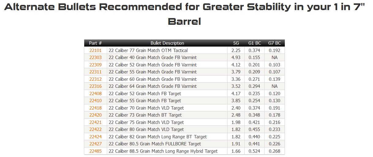

Berger claims BC is suffering at those speeds and twist...?
I knew the math but I wasn't aware that 320k rpm was the danger zone,
I'm just going to do a better job at keeping the rifle clean... if that solves the issue. If not I'll slow the round down, it just shoots so damn good here.
I've got a ton of these bullets so I wanna be able to shoot them.
