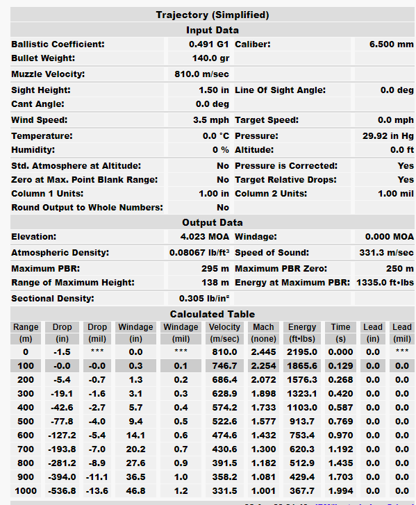

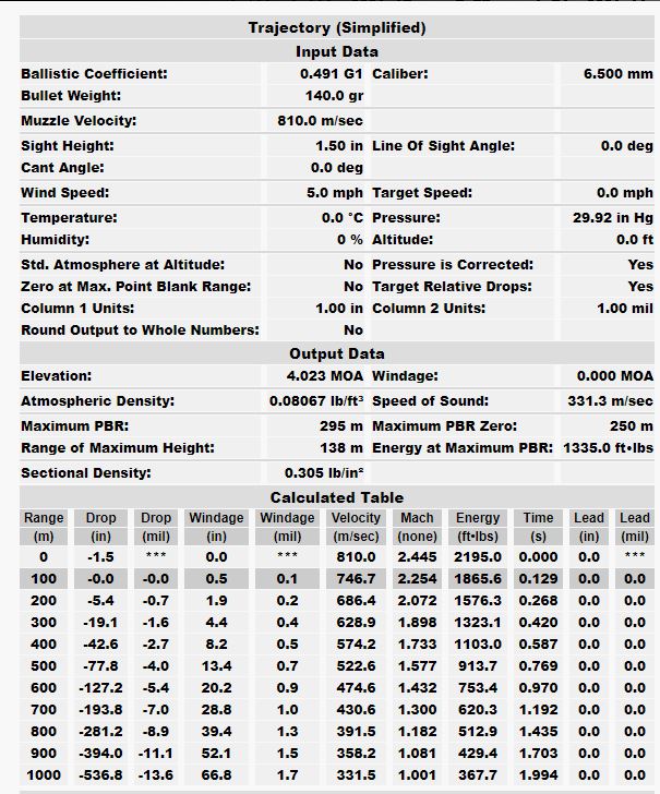

Hey guys,
I've just gotten into the podcast and long range shooting. I've heard over and over about your "rifles MPH" and the simplified math going into your wind calls. While it is now 2020 and I have a phone to do all the math for me. I was wondering if someone could explain this to me. I always seem to find that technology fails when I need it the most. Thank you again for any help.
The idea is to find the wind mph that makes your wind holds line up in 0.1 mil per 100 yards.
For example, my 6.5 creedmoor is a 6 mph gun, shooting 147gr eldms at 2700 fps. This gives me 0.1 mil per 100 yards out to 900 yards.
My 6.5 Grendel is a 4mph gun shooting 123 gr eldms at 2550 fps. This gives me 0.1 mil per 100 yards out to 800 yards.
It simplifies what you need to remember, and makes the math easier.
What's the wind hold in a 10 mph wind at 600 yards for the Grendel? 10 = 4x2.5 so, it is 2.5x0.6 = 1.5 mil.
For the creedmoor? 10= 6 x 1 2/3 so, it is 0.6 + 0.4= 1 mil

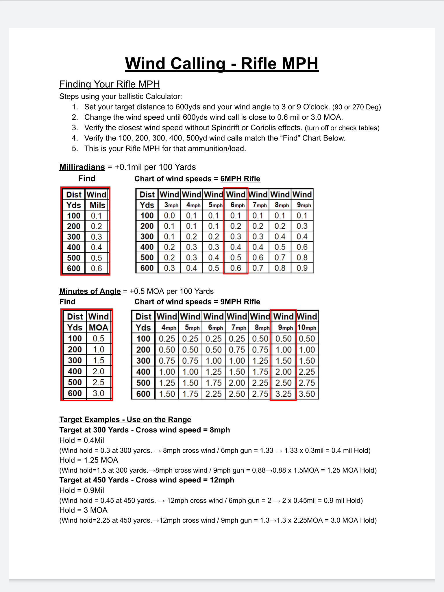

While what hlee wrote is absolutely correct mathematically, the thought process for me goes like this:
Using his 6.5 Creed (a 6mph gun), I would say this to myself:
"The range is 600 yards...so right off the bat I start with 0.6mil wind hold...but the wind is 10mph instead of 6mph...so I double it and back off a bit. So 1.2mil ...back off a bit to 1mil."
With the Grendel (a 4mph gun):
"The range is 600 yards so automatically I think 0.6mil...but it is 10mph, so double it to 1.2mil and add half again 1.5mil."

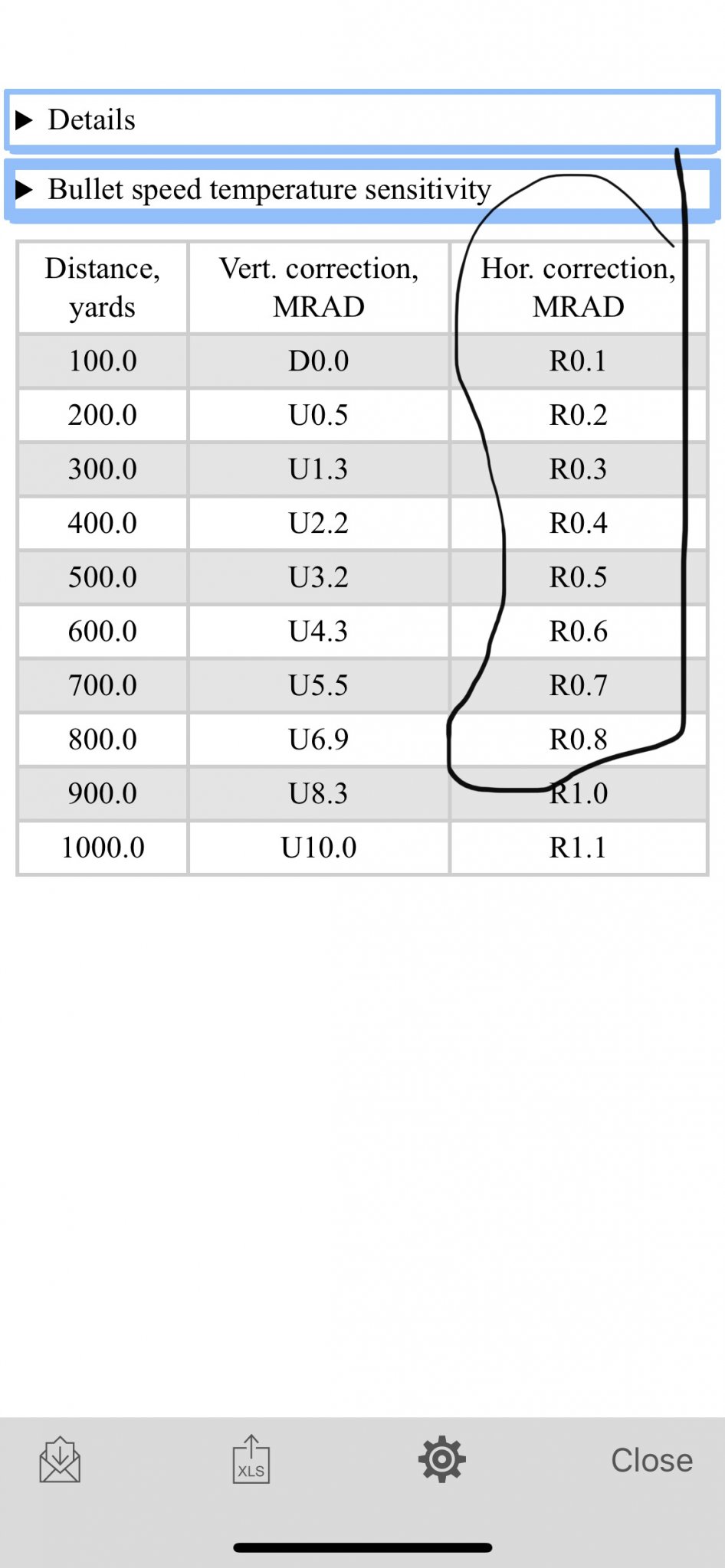

How do you get the formula on if your gun is 4 / 5 / 6/ 7 mph gun?
Where are you getting the other numbers from?
Say say with 10 = 4x2.5
Your saying you divide 10 ÷ 4 = 2.5? So the. 2.5x.6. Wheres the .6 come from?
Just trying to figure this out

The .6 comes from the range being 600 yds. 0.1 per 100 yards, so 600 yards = 0.6 mils.
Using your ballistic app, you find the wind that gives you 0.1 MIL drift per 100 yards. This is the MPH of your gun/ammo combination.
There are a couple ways to do this. Some prefer to line everything up at 600 or 800 yards, realizing that most shots will be within this distance. They then add an extra 0.1 mil at 900 or 1000 yards if the shot is in that range.
The original way was to line this up at 1000 yards, and accept the fact that there will be a minute difference at closer distances, but being closer, matter much less.
You have to figure out what MPH wind your rifle has .1mil per 100yd windage hold
example my 18” .308 shooting a 185gr juggernaut at 2525 FPS is a 5mph gun to 700 yds because 5MPH 90* wind holds are .1@100, .2@200, .3@300, etc, etc to .7@700.
The math comes in after you know what MPH your rifle is and what MPH your wind call is.
if I was shooting at my .308 500yds and have a 10 MPH wind. I know at 500yds for a 5MPH wind I hold .5 so for 10MPH I would hold 1mil. (Double my 5mph hold)
If I were shooting at 700yds with a 3MPH wind My hold would be .4mils because my 5mph hold at 700 is .7 and 3MPH is a little over half of 5MPH so would take half of my 5MPH (.35mils) and round it up to .4mils.

^For a 5mph gun.
Input all of your data into your calculator, turn off spin drift, and adjust your full value wind inputs until your tenth mil hold value is reflective of your distance.
I do it like shown above but others tailor their MPH info for the farther ranges.
if I have a 5MPH wind and I’m shooting at 500yds, I use .5 mils.
If I have a 10mph wind at 500 yds, I use 1 mil.
if I have a 15 mph wind at 800yds, I’ll use 2.4 mils.
All other speeds can be broken down quickly in your head, just as you do when getting change back at a register.
The MPH method, combined with the use of the modern wind rose (that’s floating around here), makes wind calls super fast and effective.
does that make sense? It’s one of those things where you’re like “wtf is this?” But as soon as it clicks you’re like “holy shit why haven’t I been doing this all along?!”

So strelok pro can tell you mil per mph at 100 then just multiply by PHY or PHM?
Not exactly. The mph needs to be done further out to avoid a compounding error. This isn't that exact. When we say 0.1 mil per 100 yards, we are speaking of an average.
Wind deflection is parabolic, just like trajectory is parabolic. However with wind, the difference between that arc and the straight angle while a round is supersonic, is inconsequential enough that we don't notice as long as we are using an average gleaned from distance.

MOA Version.
100yds - 0.50 moa
200yds - 1.00 moa
300yds - 1.50
400yds - 2.00
500yds - 2.50
600yds - 3.00
When on the range this math is quick because it's 1/2 of your target distance.
This moa version will typically have a higher gun mph than the mil system, about 1/3 more mph than the mil version. It's important to recognise this so when someone says they have a 9mph 6.5 creed we know it's in moa.

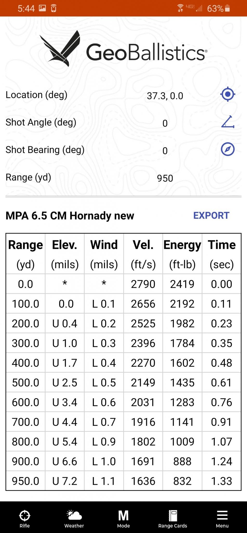

Here is my 6.5 creed in each system.
Mil = 6mph gun
MOA = 9mph gun
If you play with the linear numbers at a target distance you will see this is the same horizontal deflection in inches.
Example: Target at 500yds. Wind is 9 mph
MOA = 2.5moa wind call = 13 inches at 500yds
Mil = 0.75mil wind call = 13.5 inches at 500yds.

So I went to JBM using their calculator got this at 5mph wind.
then I started tweaking the wind speed down to 3.5mph, I got this:
So now, I can say my rifle is a 3.5mph gun. correct?
Yes it will.
