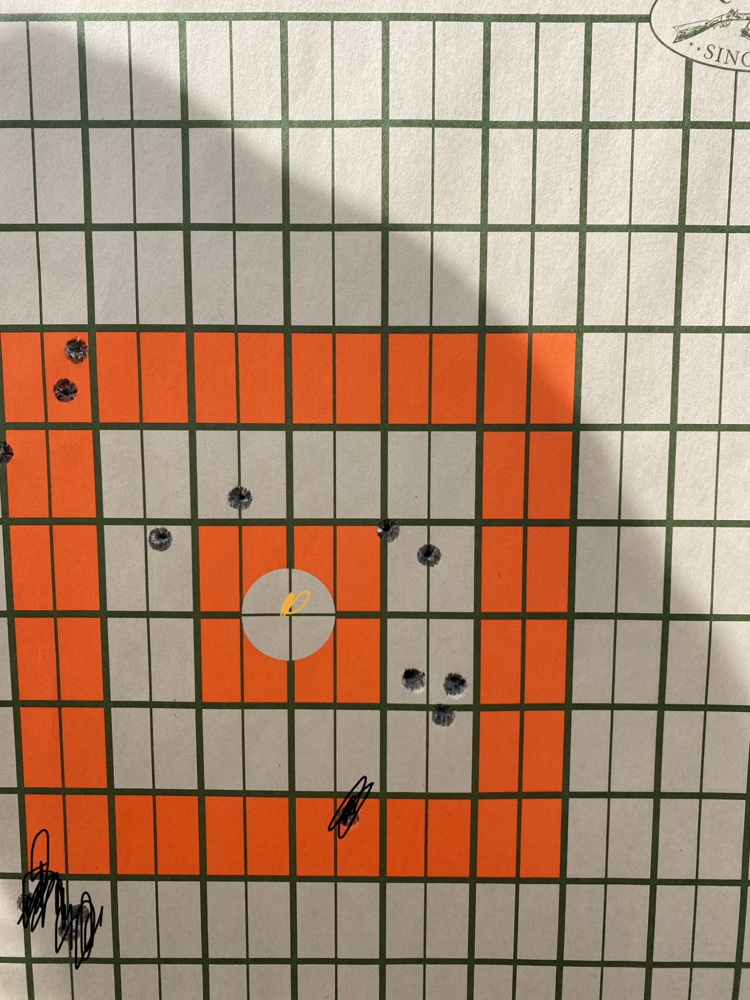

I took my rifle to the range yesterday to get it zeroed and to finish breaking it in. While attempting to zero, I noticed my impacts shifting mysteriously. I shot a couple 5 round groups in a string, and two rounds would group one place and the other three would group in another. I put about 30-40 rounds through trying to figure out what was going on. Some background on the setup: the rifle is a savage action with a PVA barrel nut barrel on it in a savage accustock. The accustock was contacting the nut when I got the barrel, but I opened up the channel to fit it. I thought it was possible rubbing yesterday, so I pulled the barreled action and opened up the channel some more to make certain it was clear. The scope is an Athlon Midas Tac 4-16 I bought lightly used off a member here. I tried my hand at bedding the scope base to the action with epoxy, and the 20 MOA base must have turned into about a 40-50 MOA base due to excess epoxy because I could not adjust down enough to zero the scope with Warne rings last time I took the rifle out. However, I was able to zero at 100 yards 4 mils high. I don't quite remember how many shots I took, but once I had it zeroed I shot at least a 5 shot group with all rounds within an inch. I then took it to 600 yards and was able to consistently hit my 2/3 IPSC plate. After not being able to zero with the Warne rings, I purchased Burris XTR signature rings and mounted the scope in them so that I could add elevation into the scope to get it zeroed. I checked torque on the rings, barreled action, and scope base. Nothing was loose. I am inclined to think this is a scope issue or my base is possible warped, but I am curious what the hide thinks. Below are pictures of the target at 100 yards. When zeroing initially with the Warne rings, I did max the scope out in elevation. I believe it is possible that maxing it out could have loosened something in the optic, and that may be the source of my problems too.
All the rounds not blacked out were shot at the center of the target (orange mark). The groups are top left in orange, top left in white, top right, and bottom right. The spread on the two upper left groups is likely just due to me rushing shots to see what is going on

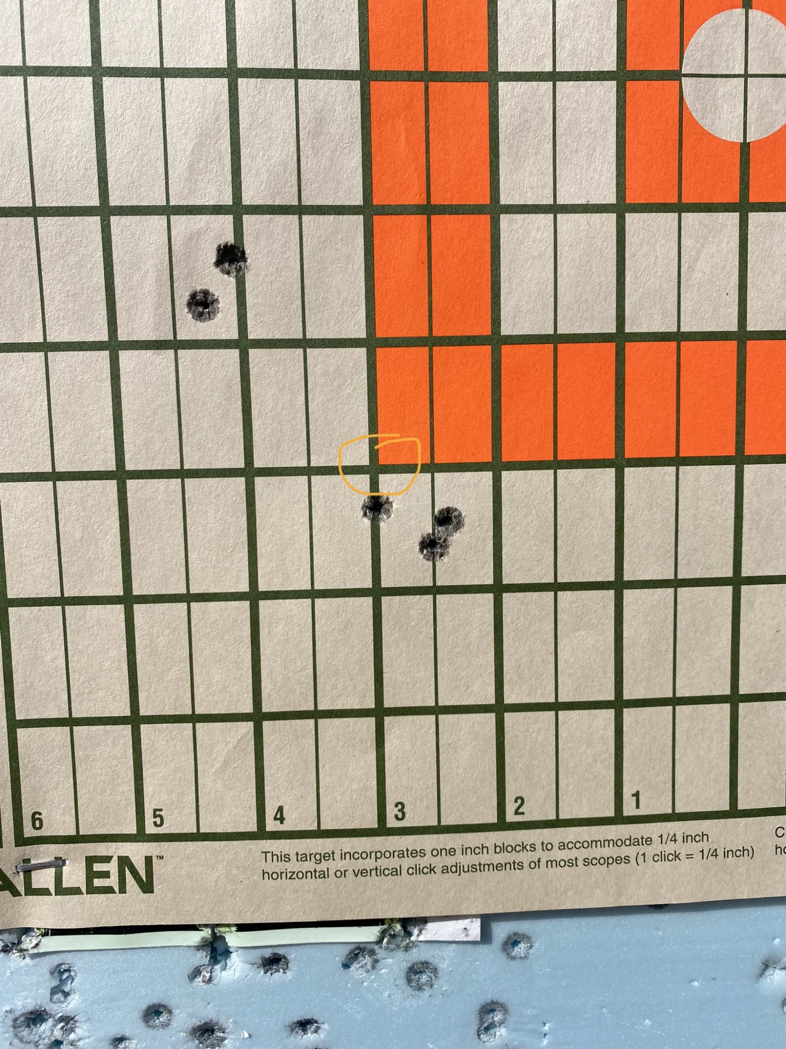

This was a 5 shot group aiming at the corner of the orange.
Make sure your scope isn’t sliding in the rings. I have the same ones and if I remember correctly they have plastic inserts.
Since you checked the torques on the obvious (rings/ring to base/base) also checking to make sure your base isn’t shifting under recoil.
The next thing to do is try a proven optic
Your groups suggest the gun wants to shoot but something is shifting
No every base needs “bedded”.
It’s easy to blame the scope on this one but did you check the parallax? Just because you turned the knob to 100 or 600 doesn’t means it’s actually accurate. I’ve found that even on high quality scopes I’ve needed a little more or a little less than what the knob tells me.
I have a spare scope I can try, so I was planning on doing that next weekend. Very confident scope wasn’t sliding, but it’ll double check that. Parallax seems good too, and I wouldn’t expect that to shift groups that much. When it hit same POI, it was shooting pretty well.
ETA: before bedding, I could press the base flush on the rear of the action and it was floating on the front. Back when I used it as a comp rifle, the zero would shift .2-.3 mil pretty often from range session to range session to range session.
If your parallax being off is causing that much shift then it is a scope problem
I had a 6.5-20 LTR start doing this in a match. Parallax kept a good sight picture but the rifle would suddenly shift 4 MOA right and then back at 600 yards. (No, it was not wind). Turns out the parallax lens was loose and it was shifting the image under recoil. May or may not be your issue but a known good scope should tell you.
