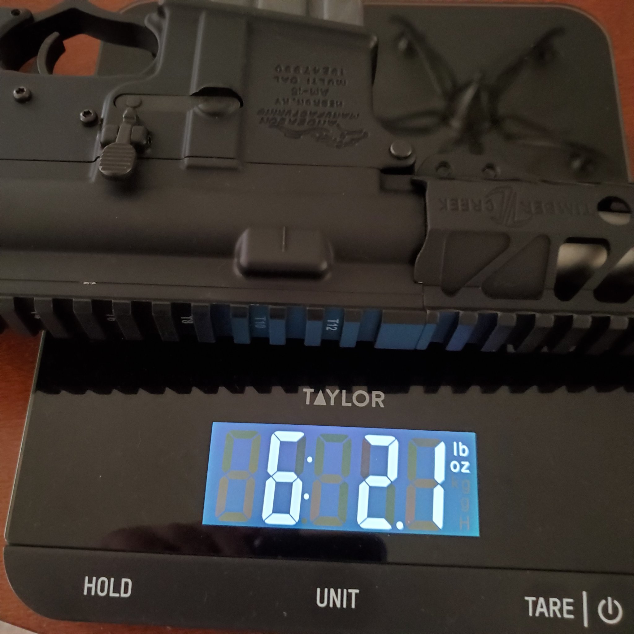

I wanted a lighter AR 10, so I built one, 308 6 lbs 2 oz ...lighter than many AR15s.
It's accurate and light.
It has a titanium bolt carrier, and muzzle brake, carbon fiber hanguard 1 oz, magnesium upper, Wilson Combat fluted 16" Recon barrel, adjustable gas block
Areo lower with 2 lb trigger, minimalist stock.
Shoots 168 ELDM at 2756 fps into 1/2".
Plenty of energy for deer and elk. Or the 208 gr .691 BC at 2442 fps for heavy game. Or 155 gr 2815 to 2900 fps.
And cheap LC brass...
For those who don't want to build their own, Roam has available in complete magnesium upper or complete rifle, with magnesium upper and lower, but they use a pencil barrel, mine has a bit heavier profile and fluted to get close to the pencil barrel weight, and surprisingly accurate over 5 shots...308 power 6 lbs, check them out, or build your own. One of my favorite rifles.

308 AR 10 ultra light 16" barrel 6 lbs 2 oz.
338 RCM AR 10 special build 18" light fluted barrel 7 lbs 11 0z
AR 15 6 mm ARC 18" Proof rifle stock 8 lbs 14 oz
AR 15 6mm ARC 18" Proof carbine stock, 8 lbs 2 oz.
AR 15 300 Blkout 16" barrel 7 lbs 3 oz.
So AR 10 can be built lighter than many standard build AR 15s by alot.
