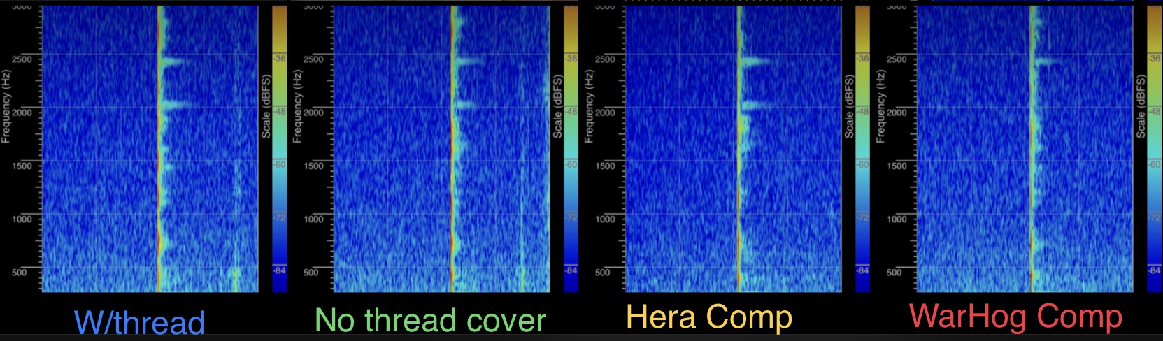

With all the apps and devices (LabRadar, Magnetospeed, Garmen, etc…), plus the barrel tuners available to the masses, exotic stock materials, ballistic apps, etc. has anyone tried tuning their rifle itself with any acoustic devices?
These are sound recordings of my B14-R dryfired on a spent casing. Left to Right are
1. With action screws torque tuned to best groups and any distance with multiple ammo.
2. With muzzle thread cover removed (haven’t tested groups).
3. Hera forward blow compensator (3” long steel).
4. WarHog compensator.
With compensators installed, there are huge amounts of vertical stringing.
All rounds fired were recorded from chronograph to correlate disparity with grouping and velocity variations.
Thoughts?

Looks interesting but I'd be curious on the following:
1.) Is the recording at a sensitive enough metric to see discrepancies and patterns?
2.) Is there too much "noise" that correlates to nothing that shows up on the graphs and confuses the results?
3.) Deciphering WHAT exactly you're looking for that correlates to accuracy or positive compensation

So back history:
I have proven that Torque Tuning action screws works on my chassis. It works with 3 different brands of ammo, and at 50 and 100 yards on paper, although I use this rimfire in monthly matches from 25-400+ yards.
The app is called SpectrumView, and gives the same image whether in contact with the rifle (resting on the scope rail), sitting 1/2” inline with the muzzle, or on the carpet below the rifle. These repeatable results show promise for when I started screwing around with adding different muzzle devices.
The gun is on bipod and bag, held as though firing through the recording. I made many recordings this weekend, constantly tweaking the adjustments in the app to get as much “visibility” in the harmonics.
Since I’m starting with a “known” pinnacle in this combo’s accuracy, and can obviously (on target) make it worse, I’m wondering if the information could be used as a tool to make things even better.
Maybe this is useless, but will trigger someone to try something else that will improve accuracy.

Interesting stuff. Once you get far enough along, you'll need to be able to isolate BC/bullet difference/deformation.
As in, you'll need to be able to confidently say the vertical stringing isn't due to something the compensators are change other than the harmonics.
Reactions: obx22
1. Are the results repeatable? If you repeat the "same" thing do you get the same results, do you know the typical error bounds?
2. Do the results correlate?
3. Do the inputs cause the outputs?
4. Can you reliably manipulate the inputs to get desired outputs?

This data is useless because there is neither a bullet nor a gas volume traveling down the bore
Reactions: iceng
Are you using a phone app?
What microphone?
I'd think some sort of vibration tester attached to the barrel would be the only way to get good accurate results.
Dry firing is not firing. You'll need to be able to see what the pressure does as it travels down the barrel.
What microphone?
You also need to map out what the barrel is doing in 4D.
How is the barrel moving in 3 dimensions, over the time frame from when the ignition system is engaged to when the projectile leaves the barrel.

Yes but the pressure and moving mass of the bullet are going to be constants from setup to setup...
Are they? One would think so but data has a way of sometimes making our assumption invalid.
First off ammunition will never be as repeatable on its effect on the system as the drop of a firing pin on a spent case. It's the nature of chemical vs mechanical reactions.
So if you notice your barreled action give you a mode at 1000hz and it shoots better than a setup that gives you a node at 3000 hz....and it's repeatable and trending data, the effect of the bullet on the freq response is
But see you're now talking about data collected during live fire.
All I'm saying is that the data presented here, while interesting, it's not enough to make any decisions on.

All excellent replies.
How about if I adjust the torque to where the gun groups terribly (and yes, that is repeatable, as is retorquing to tightest grouping). Then get a pic of that resonance?
Perhaps the bad could reveal just as much if not more than the good?
As to the excellent question of whether the sound comes from firing pin spring, scope, etc. I can relay another interesting experience (with a different rifle).

Based on my understanding of what you are trying to do, I would do the following
1) remove the bolt and scope
2) torque action to 40, 45, 50,55,60,65,ECT in-lbs and record the resonance for each.
3) see if there is any mode shift that correlates to torque settings
4) using the same lot of ammo, shoot several groups at each torque setting and come to an "average"group size for each torque.
5) see if you have any trend lines that correlate torque/mode to group size.
From there you can see if different settings/ configs alter model response...tune your action to known "good shooting modes" via torque...and see if the gun is still shooting good groups, and use the mode response ad a method of tuning
Ok, and understand I’m speaking humbly cause I’m genuinely interested in grasping what you are saying. I’ve torque tested my rifle with 3 different types and brands of ammo, at 2 different ranges (50 and 100yds) at 5 in/lb increments from 30 to 55. I then went 4 inch lbs higher and lower of tight “nodes” or areas of tighter grouping till I determined that 38 was the magic number for this set-up. Since then the rifle has been torn down multiple times and cleaned following particularly dirty matches, torqued back to spec, and not only returns to its tight groups, but also to zero. This means I can switch to 45 in/lbs (a particularly horrible setting), then return to 38 and the gun resumes shooting well.
I’m just throwing experience out there, I don’t know what conclusions to draw yet. If a given resonance could be used to “predict” what would do well in a given set-up, that would definitely be useful.
How is what I’ve already done any different?
