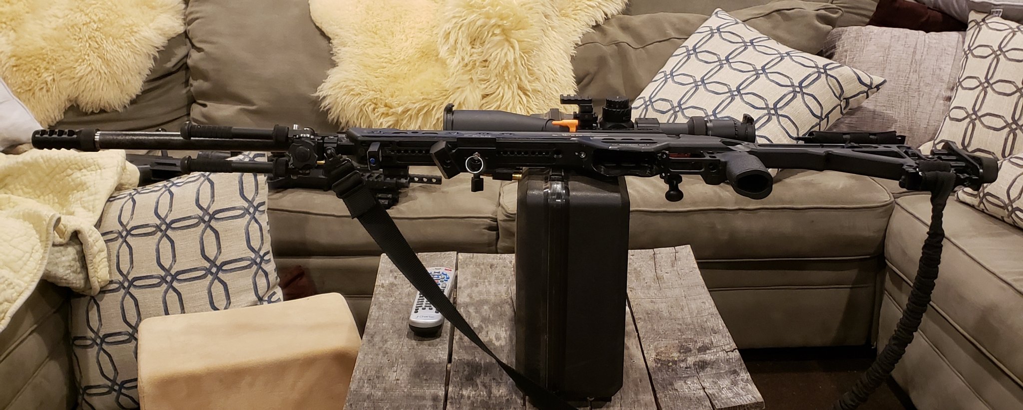

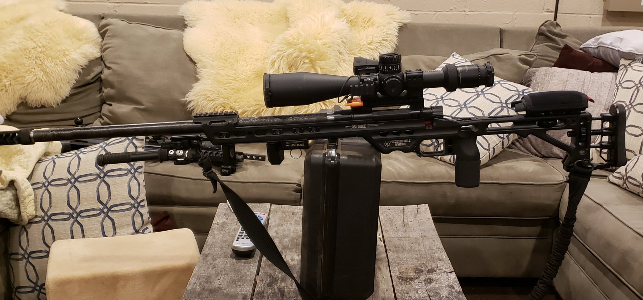

Just wondering how most guys and girls feel about a heavy rifle vs a balanced rifle if you had to pick one or the other...whats more important to you?
Today I took off my weighted bag rider and secondary rearward weights off my MPA chassis. I love the gun now because it is very balanced, but I did fall below 17lbs. I'm at 15.8 lbs (no mag).
Would you prefer a balanced rifle or would you take the extra weight so you can keep weight at 18lbs. I ask because cals "what the pros use" article about weight brings most top PRS shooters at between 18 and 20. I was able to keep the extra weights in the forward part of chassis and under my proof carbon barrel, but rear weight was removed to balance the rifle.
you need to put your gun on your shooting bag on a barricade then see how it balances. i don't think laying it on that case or whatever is a good test.
usually the balance point is a few inches forward of the magwell.
i USED to think i needed my gun to balance right in the middle right in front of the magwell. but when you put your gun on a bag on a barricade - the center of gravity needs to be further forward or else the gun will want to tip back toward the rear.
personally i think you can find a happy medium of both. balance and weight. but i'd lean towards a balanced rifle over a super heavy rifle.
having said that - my gun is around 20-21lbs. which is light compared to some guys. but it balances perfectly with a 28" heavy contour barrel.
