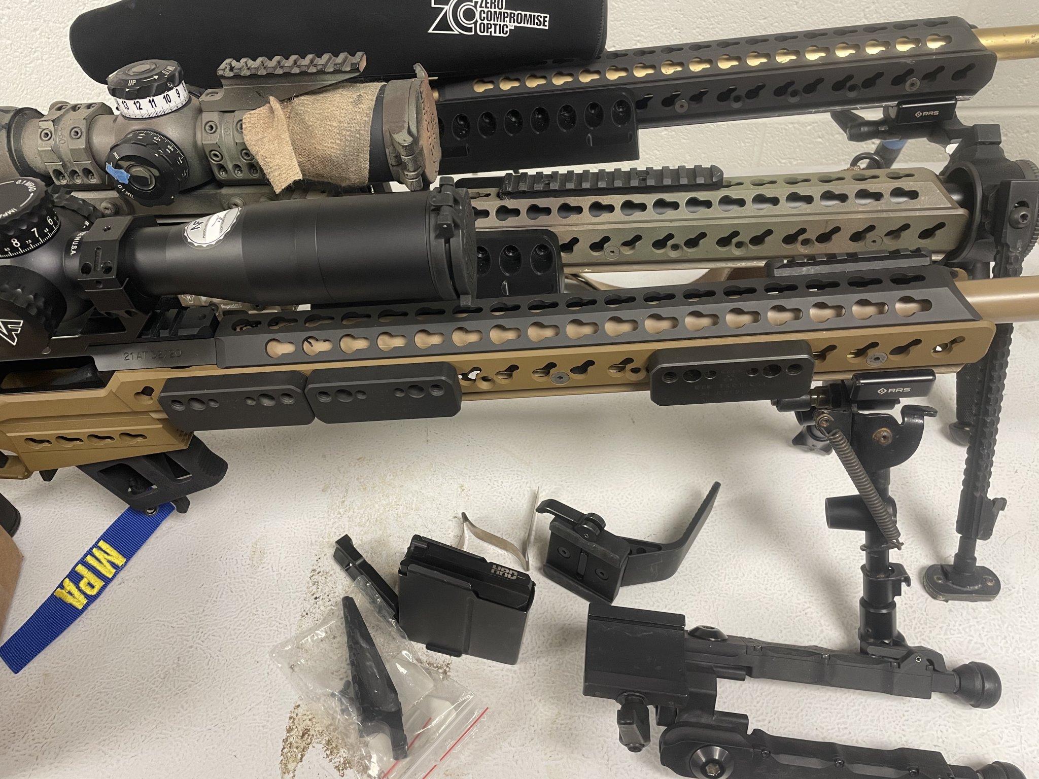

    What does your PRS gun weigh ?
    Picked this one up that came with some weights and it is substantially heavier than the one I’ve been running for years bare

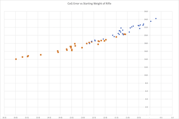

    It’s all about balance point. If you can balance with 18-19 do it. I like mine around 5” in front of the bottom metal.

    Every year, it seems like there is a trend to move the “balance point” forward. I have not seen a reversal of this trend since field style precision rifle competitions first started when people would attempt to “balance” the rifle as close to the mag well as possible. Every year it continues moving forward.
    As mentioned above, the center of the bag is where you want the balance point.
    The original just in front of the magazine was due to the way we built positions at the time with limited types of bags. The first few min of this video is a good example:
