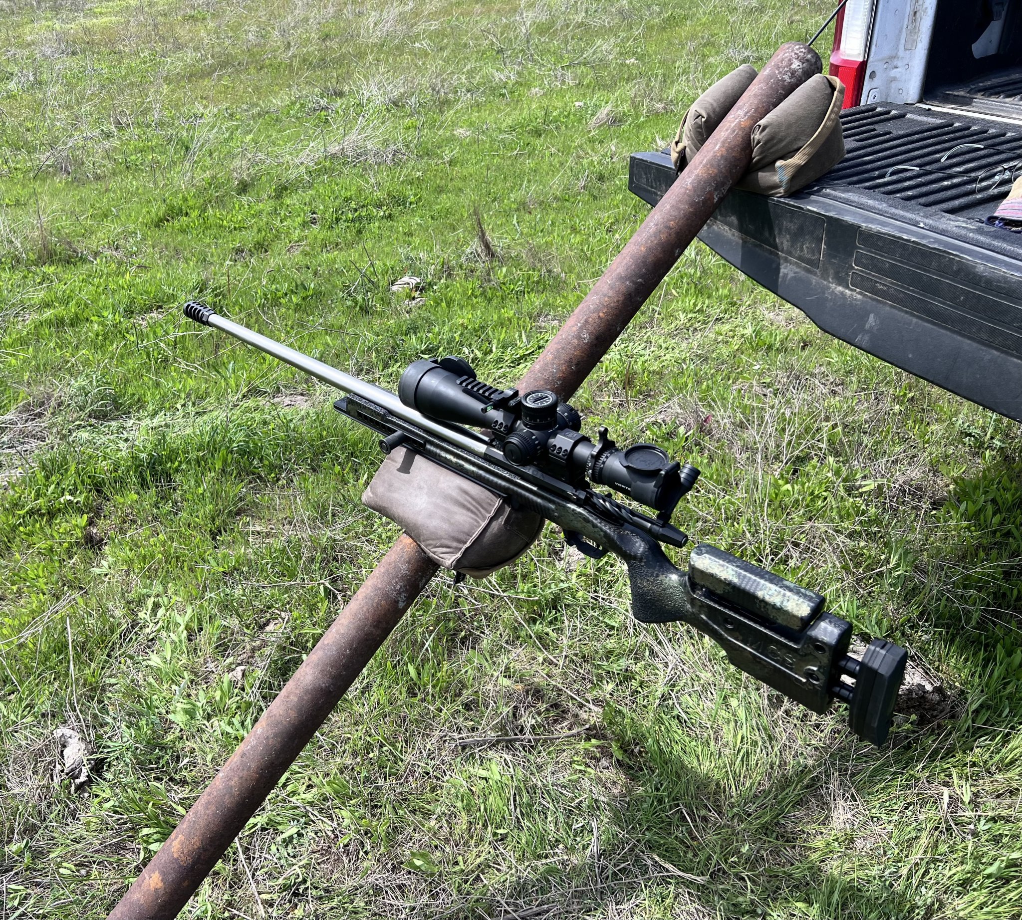

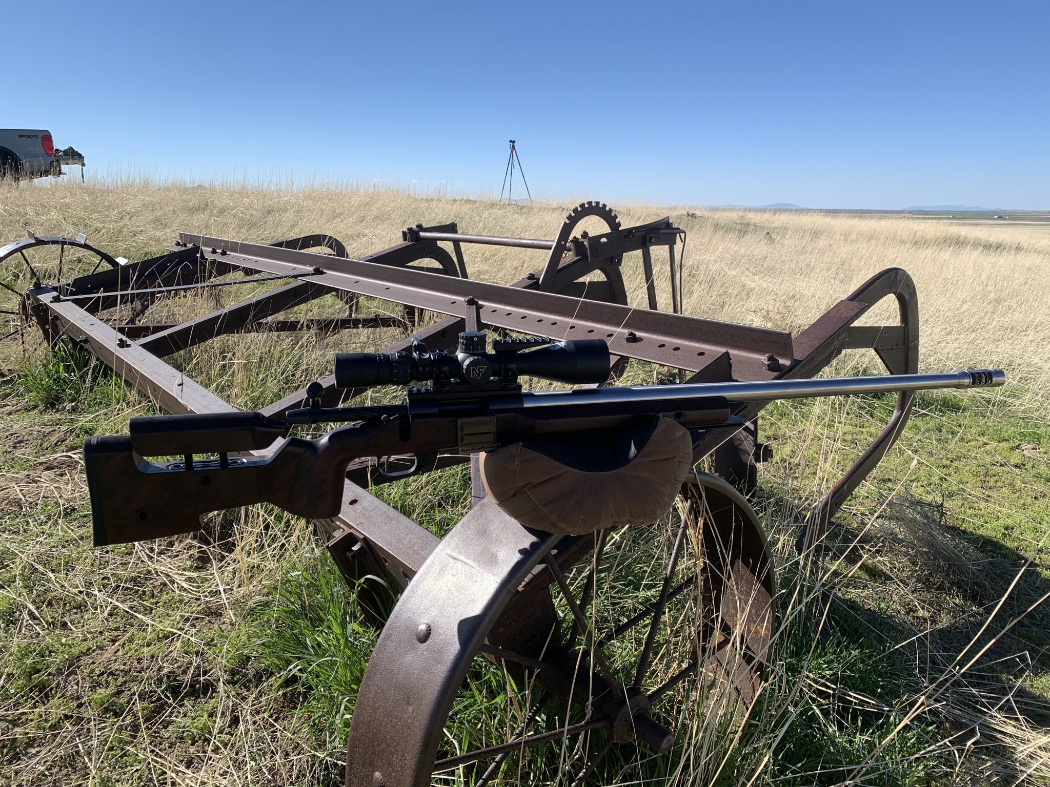

I didn't find that. Below is a pic of a Vudoo with a 22" MTU barrel, which is not a true heavy MTU, and it balances fine. Even if I took the bipod off. If you notice though I adjusted the rear weight by taking out the one large weight that comes with the stock. Just a little adjustment but it's possible without a straight contour barrel. I have my M24 contour 6.5 Creedmoor in one now and it balances fine also.
My Vudoo wears a 20" 1.25" contour Krieger, and sits in a TCS (in fact, it's the one I have that has the latest style rail and weights we've been discussing). It doesn't have any rear weights in it, and the rear pair of rail weights are removed, as well. Even with a bipod on it, it's still tail heavy. Yeah, sure, it'll balance on the 3.5" side of a 2x4, flat on the wood, just like yours - but put it on a cattle gate rail on a bag (or not on a bag), or other such narrow prop, and you see it right away. Meanwhile, the guys I shoot with can pop their rifles on a cattle gate with no bag and walk away from them (Foundations, MPA Matrix Pros, ACC Elites....). Like it or not, proper balance makes a difference to positional shooting.
I've considered adding a bloop tube to put some more weight out front, or (as I alluded to above) having some replacement rail weights made in tungsten (they'd weight 2.5x what the steel ones weigh, and a couple of those out front should help shift balance a bit). I'm at least a little married to this TCS, because it's been bedded (blah blah blah, doesn't need bedding, blah blah blah - this isn't the thread to explain it, but post-bedding it was easy to diagnose the issue - the lug was only touching the mini-chassis at the very corners). So, solving the balance equation is near and dear to my heart...
Not sure what to tell you but mine will sit on a bad on a prop just fine. Not rear heavy. I am wondering if it's a new rail and weight thing as the newer TCS have different arca rails and weights.

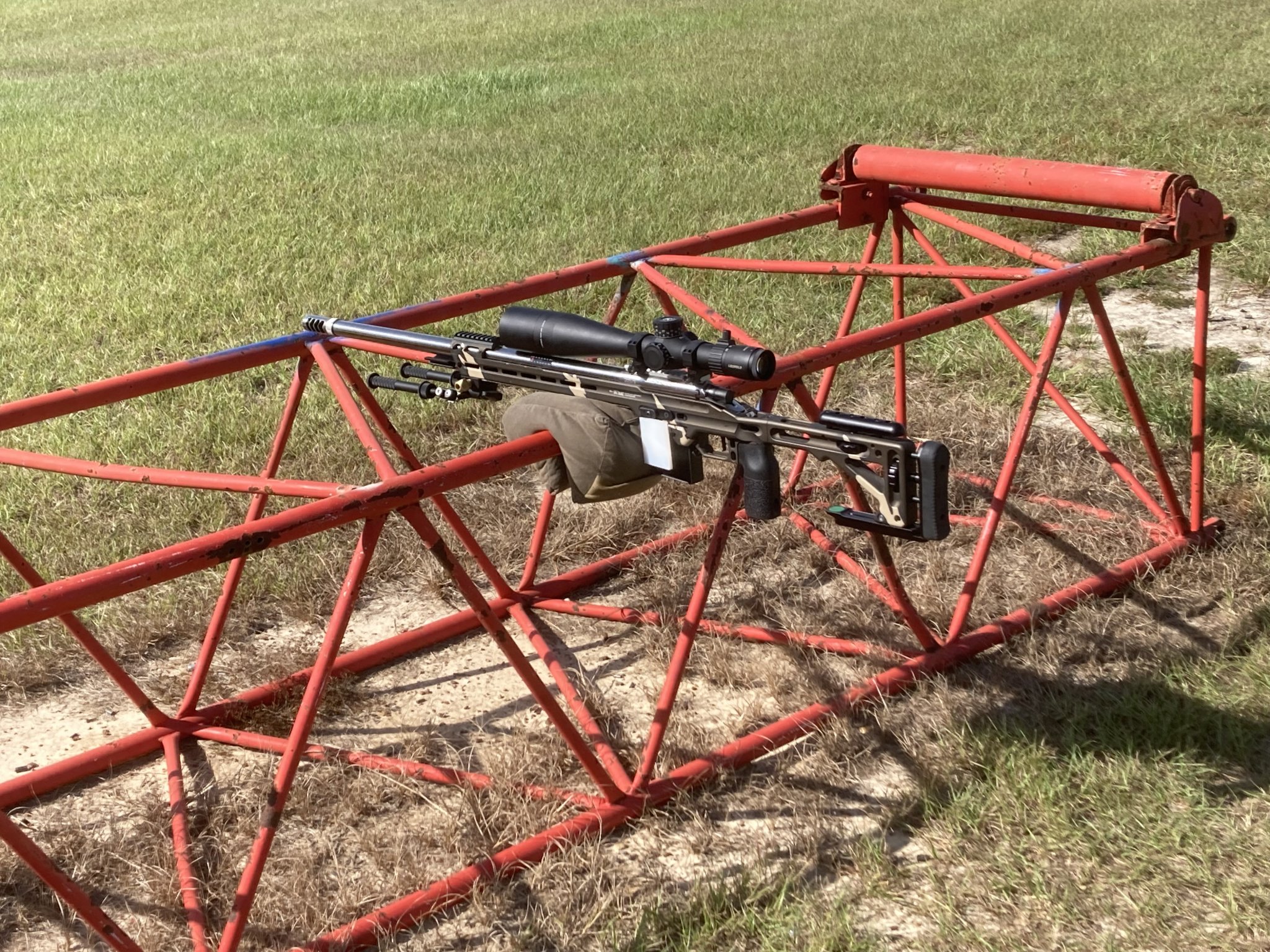

My rifles balance well and I use a MTU or MTU+ with all the front weights and one rear weight. If I go to a 1.25” then I need to add a second rear weight. That is balanced about 5” ahead of the magwell.
Hope this helps

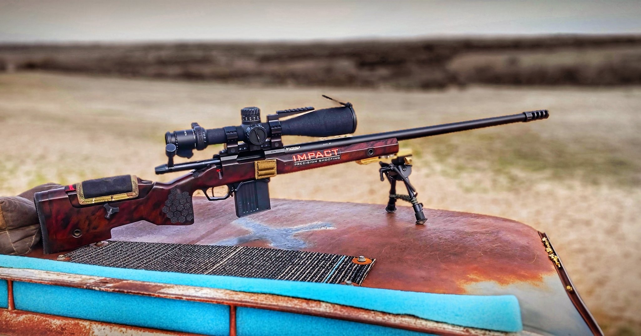

Old man’s rifle. 18 pound, 11 once’s. Balances perfectly. Why old man‘s. A little less weight for a 75 year old to pick up and move in stages, and less to carry from stage to stage.
If we are lucky we are all going to get there. Some of us are scouting ahead.

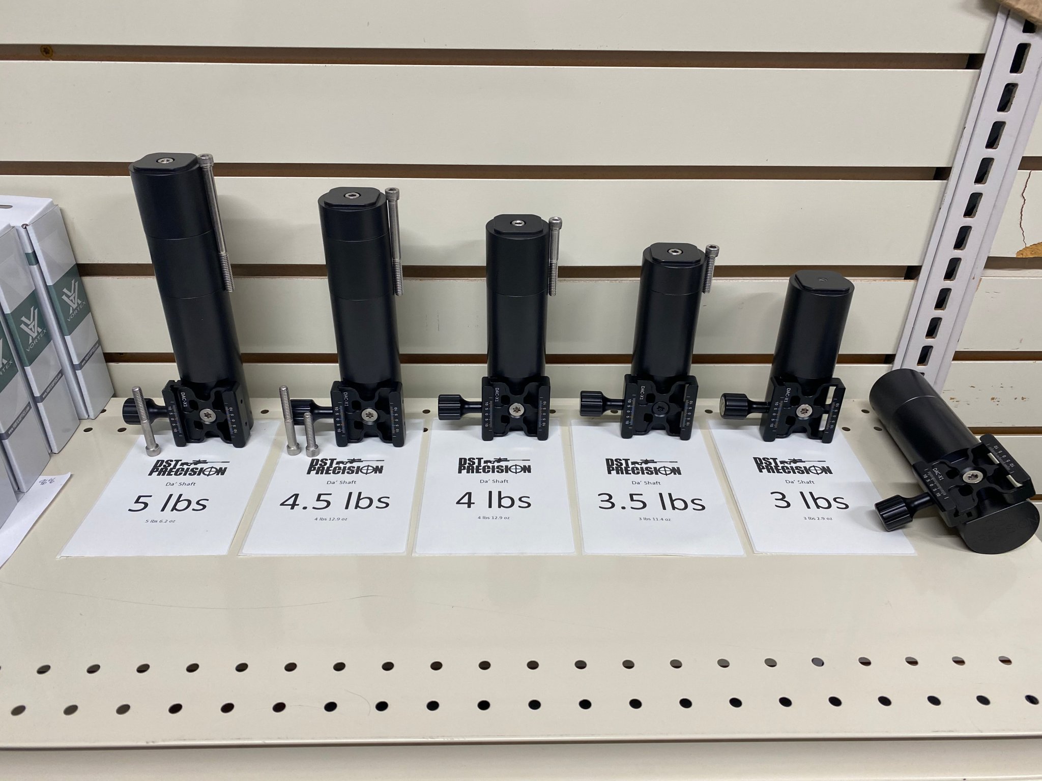

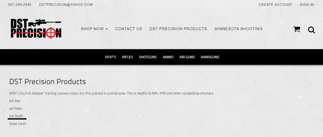

That "da'shaft" thing is weird. Not bad, but takes up forward realestate.
I make a chassis which is 3.5kg - 5kg before you put external weights on it. (7.5 - 11lbs). Has a internal weight system on it.
I dont get it, but people asked for it, so i did it. Not a huge fan of overly heavy rifles, i go for balance.

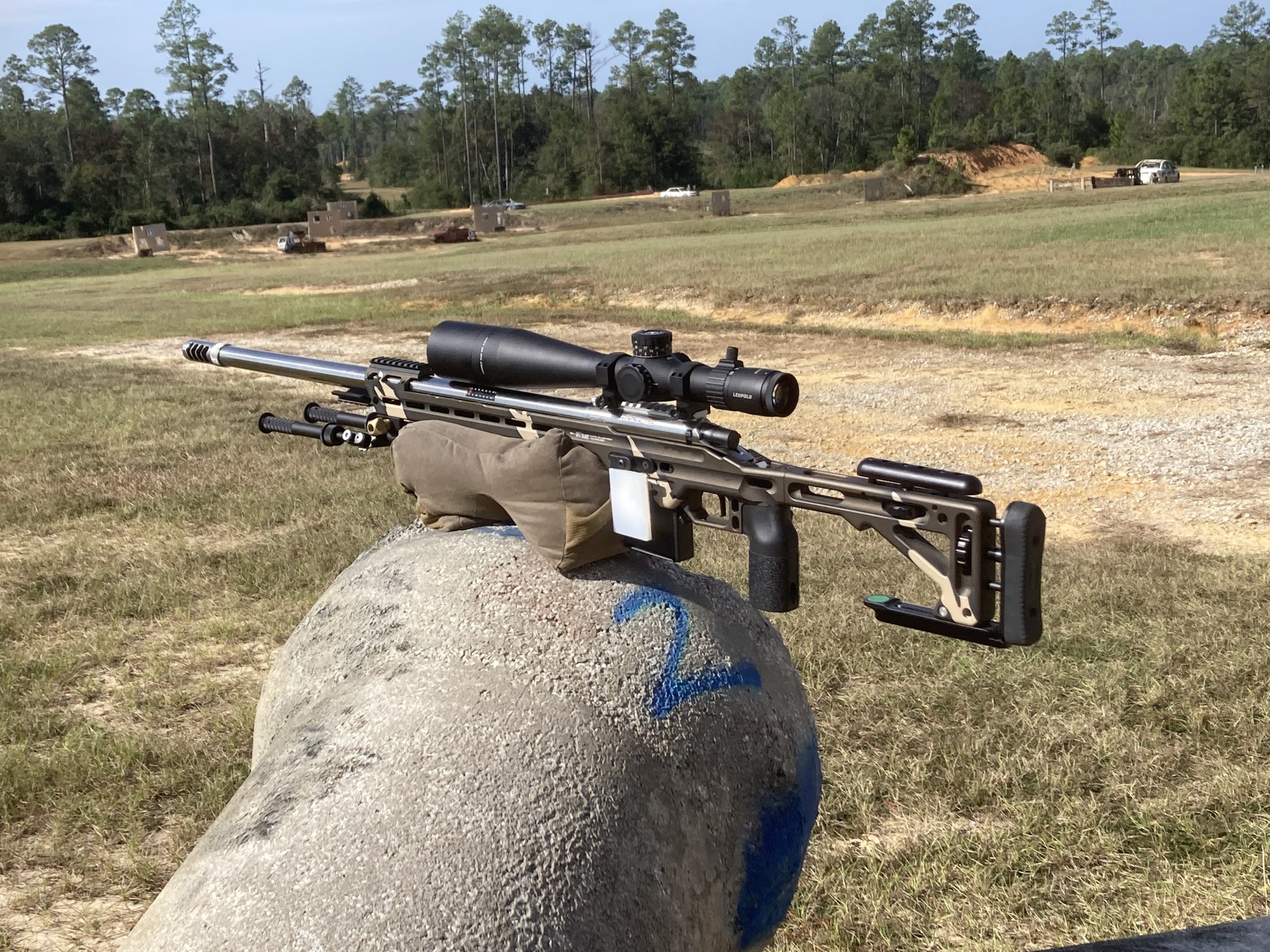

I run mine at ~22lbs, balanced center of a Shmedium ~4.5" in front of the magwell, and see 99% of my shots.
I would probably try a bit heavier if I could (just to see)... there's a guy in the top 10 who shoots at my local club and his rig is easily 26lbs or more. :oops:
Like i mentioned seen these at Rimfire worlds last year in Italy, at the time, not many rifles ran 26' 1.2' straight contours, lots of 'outboard' weights were in action , team USA had bunch of ''da shafts''

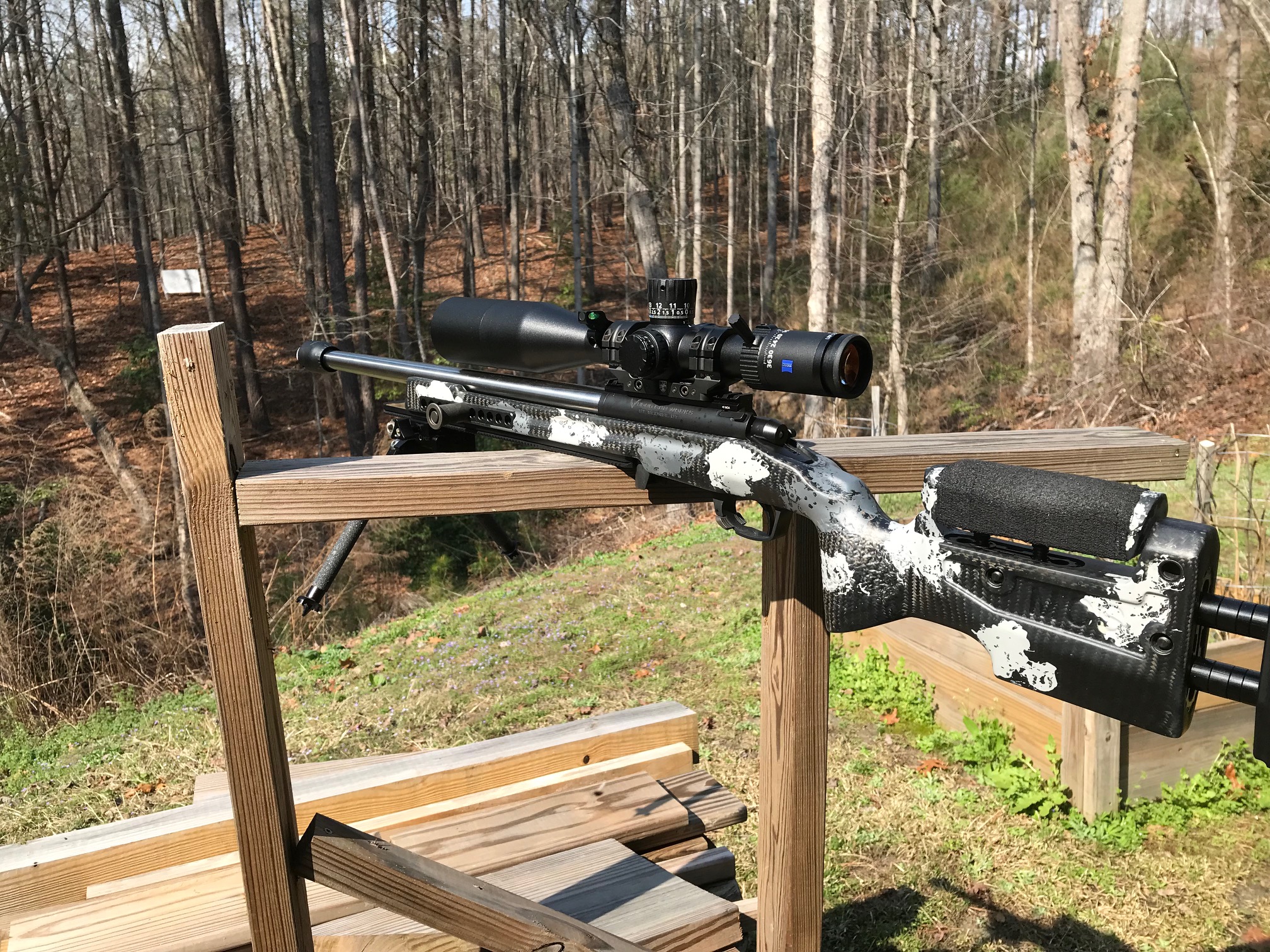

Added a 360 Precision steel ARCA, should be just shy of 21lb? Definitely can’t move quite as fast. I believe I would prefer the weight to be on the end of the barrel & not the rail.
28” m24, Razor, steel ARCA, no other weights, no mag barely balances on a GC 1+1 (pictured), but is ready to tip rearwards. Does better on a Fortune Cookie or schmedium
Black razor gen III hell yeah!
