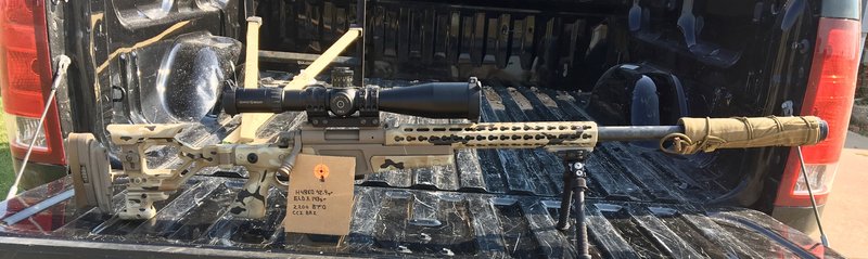

I just had a version built by a local smith on a TL3 action in an XLR chassis. The only special tooling was two flats milled into the Barrel just behind the suppressor adapter for an 11/16 crowsfoot. 30ftlbs and return to zero. Right now I have a .223 Wylde Barrel chambered. I have a 308 Palma barrel and a 6mm 1:7 Barrel waiting on the reamer to be chambered. I purchased a .223 BF bolt head from Zermatt and I can swap Barrels on the range without having to remove the Action from the chassis or any complex tools beyond a torque wrench.

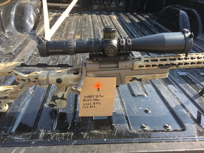

Just finished up load development on my WTO Switchlug 6.5 Creedmoor. So far really liking this setup. After deer season is over I'll test it by shooting a group and removing the barrel and reinstalling it and shooting another group.

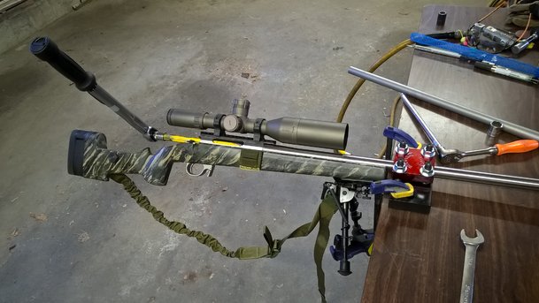

reubenski I am doing the TL3 range swap too, but on a Viper vise mounted to my hitch. Always thought ya needed 65-75 ft-lbs torque on these barrels, but sounds like you're running significantly less in order to break it while holding between your legs!
I like this idea better than removing scope and chassis. Only takes me 10-15 min depending on my hustle now, but...
