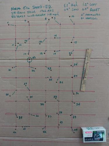

Obx, I finally came up with a way to test if sorting will improve results. :oops:
Seriously.....but you ain't gonna like it. :cool:
In fact anyone who claims "submoa all day long" might need to rethink the idea. :unsure:
Groups are not how to test for improvement by sorting. o_O
Use the Grid...you won't like what you see. :cry:
Sorted or not, the Grid will not lie the way groups will.
Groups can make you feel good about y'erself,
but the Grid will point out just how bad those bulk cartridges are straying.
Hem and haw all ya' want, but you can't argue when those bullets hit everywhere but where y'er aiming. :sick:
AM-JKLXzLu0m8JEuMJzEwEjTcuC2mminAYlTUYyxWPPNASkc6g_Rgq1qpcOg-v5HyKMkqBeNqBtCt0p8hVAwiZZ9zXuWK7p2Z8E1p9pKT6Kej-W3-DU5Aifvujyt1ZUkgWAgLy9B6Gxpz-9BZOJE5DihaPq4=w426-h643-no

This is where you and I diverge in our assessment of data.
I consider the grid, or 25 bulls card testing as more a test of the entire system,-shooter included.
The grid introduces a couple of more variables, rifle reset to a completely different aiming point, different tilt, different target, different grip, different set in the rest, etc.etc.
Group shooting is more a “same-same” shot to shot until the mag empties. Less variables equals more conclusive results?

I’m gonna also add, that we both know poop ammo isn’t gonna hit the grid, but sorted ammo imho is gonna hit closer, and group shooting will give a more graphic impression of the improvement (less fliers).
I wonder what would happen if'n ya' built the group aggregates?
Do you think the resulting overall spread would be better or worse than the overall spread from the Grid?
Hint....I've done just that. :D
Just for giggles, give it a try.
Shoot ten 5 shot groups, then measure the overall spread, relative to point of aim.
Then shoot a Grid, 50 shots at 50 separate aim points, then measure the overall spread.
My results with the Grid produced a smaller aggregate than the groups did.
Those worries about shifting positions and different aimpoints turned out to be "insignificant". ;)

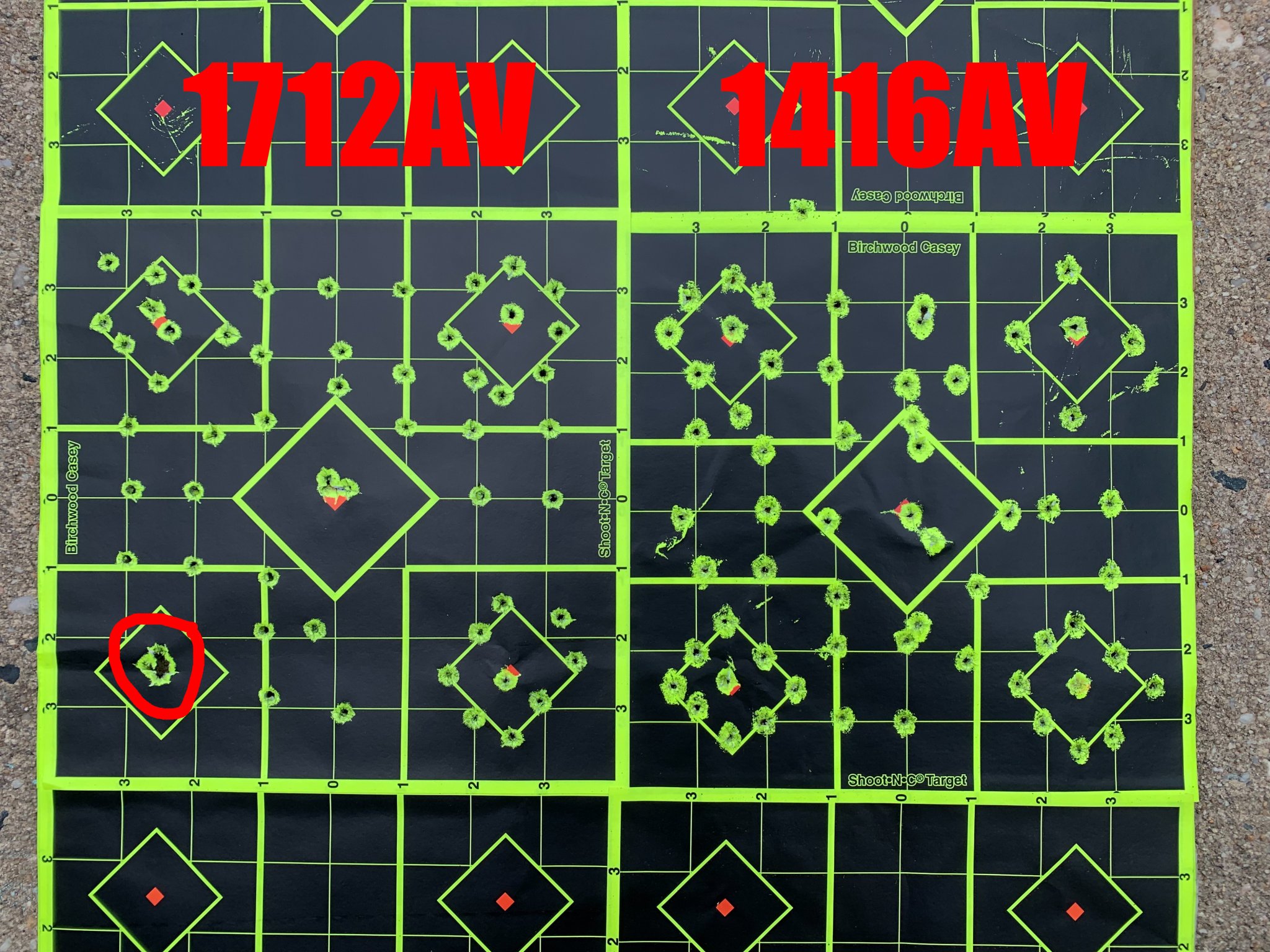

Had to go looking to find the post with groups compared to grid...
Reactions: obx22
The Birchwood Casey 8" shoot-n-see targets have a lot of aiming points. I could have done better, some was sighting in both rifles, some was good shooting, some was me. I buy these in packs of 15 for less than $7 usually...a lot less work than drawing a grid yourself...perfect 1" grids.
ETA: that red circle bottom left is a 10 round group, it defiantly should have been better than that...it was shooter, not the ammo or equipment.
