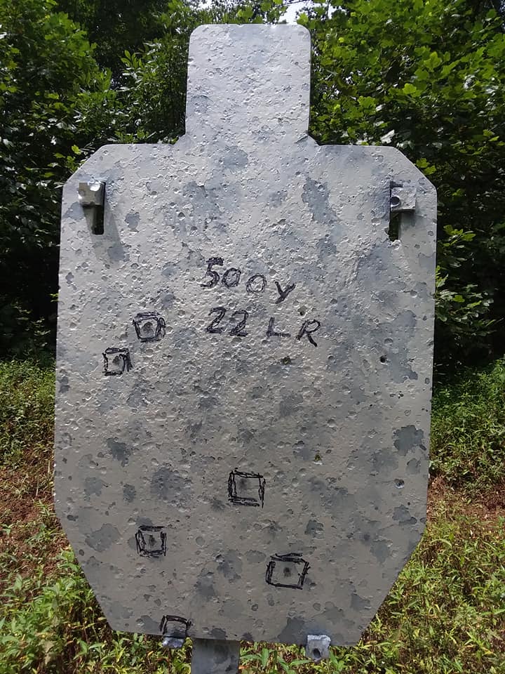

Wind training all day today.
Custom 22LR based off a CZ 452.
500 Lazered yards. Lapua Center-X , subsonic match ammo.
10 shots for 7 hits, this string. (shot # 7 not marked. It's just below the "L" in the photo.)
Man sized shiloutte. (however you spell it.)
102 MOA elevation. (44.5 ft./ 13.6 M) 6 MOA for wind. (2.6' / .8 M ) [Average condition, but variable and gusty.]
1.85 second flight time.38 ft.lb. on target.
For reference: 102 MOA of elevation would zero my 7mm extreme long range rifle @ 2250 yards.

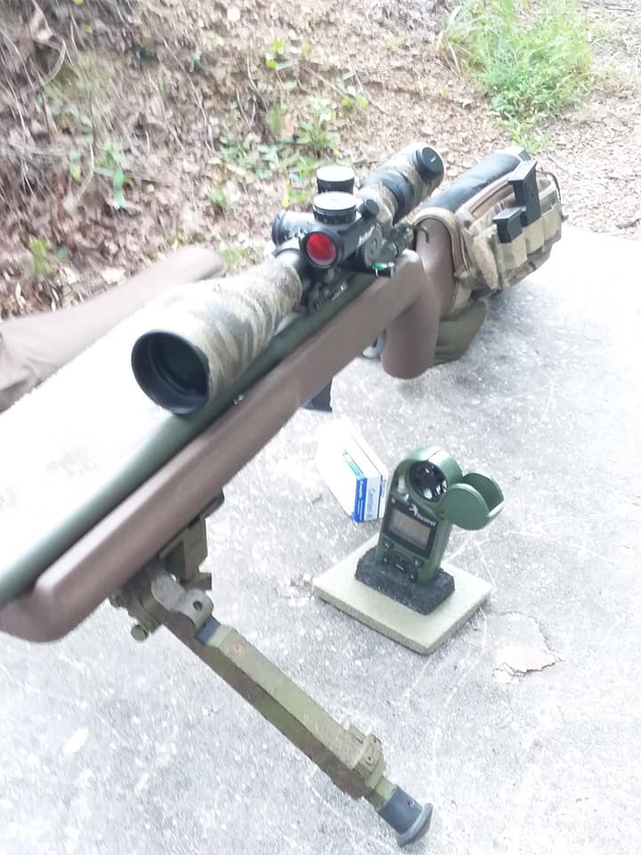

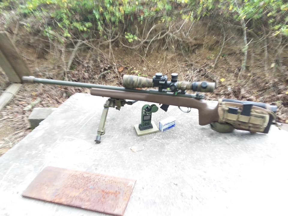

Manners Stock
Cz 452 action with 3rd action screw added. Bolt shimmed to squeeze rim for a bit more rim preload.
DIP bottom metal.
BenchMark 26", 2 groove, choked bore, reverse tapered barrel. Winchester '52 chamber. Bostrum Gunsmithing Tuner/Brake.
Trigger job, 20 oz.
DIP 20 moa scope base. Burris Zee rings, with max offset inserts for more MOA.
Vortex PST, FFP, MOA scope.
Busnell red dot, 45 deg. mounted. (for close range squirrel hunting ; ] )
Sinclair Tactical bipod
Lapua Center-X ammo

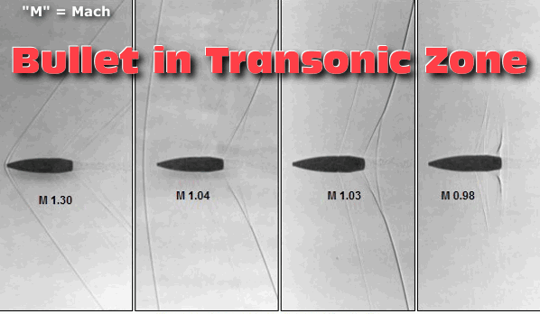

Might be a dumb question, but what was the reasoning behind using sub-sonic ammo?
Great question. It's way more accurate, and FAR more consistent. You see a lead Rimfire bullet is shaped more like a pistol bullet rather than a rifle bullet. And this shape does not do well in the *transonic region at all. So if the bullet starts sub sonic, it never has to deal with the destabilizing effect of going transonic.
*Transonic means an object ("missile") is neither moving at super, nor subsonic velocity. It's in-between.
A super sonic bullet has the (primary) shockwave at the meplat. (tip of bullet.) As the bullet enters, goes through and drops into the subsonic region, the primary shock wave moves rearward on the bullet and eventually disappears. This moving of the shockwave down the bullet works hard to destabilize the bullets balanced, spiral flight. Nearly all Spitzer ("pointed") rifle bullets do fine in the transonic region. Most pistol bullets do not. Worse case scenario, the transonic region causes a bullet to tumble- flip end over end. And a tumbling bullet has no predictability regarding path.
See pic:
Reactions: Jjviperzar1
That's where I was going in my thoughts, to eliminate going transonic. I thought most .22 was barely supersonic to begin with. We always used subsonic when I was shooting 25m rimfire waaay back in high school.
Reactions: TresMon
Yep... "high velocity" long rifle ammo hits the transonic region really quickly/not far down range.
