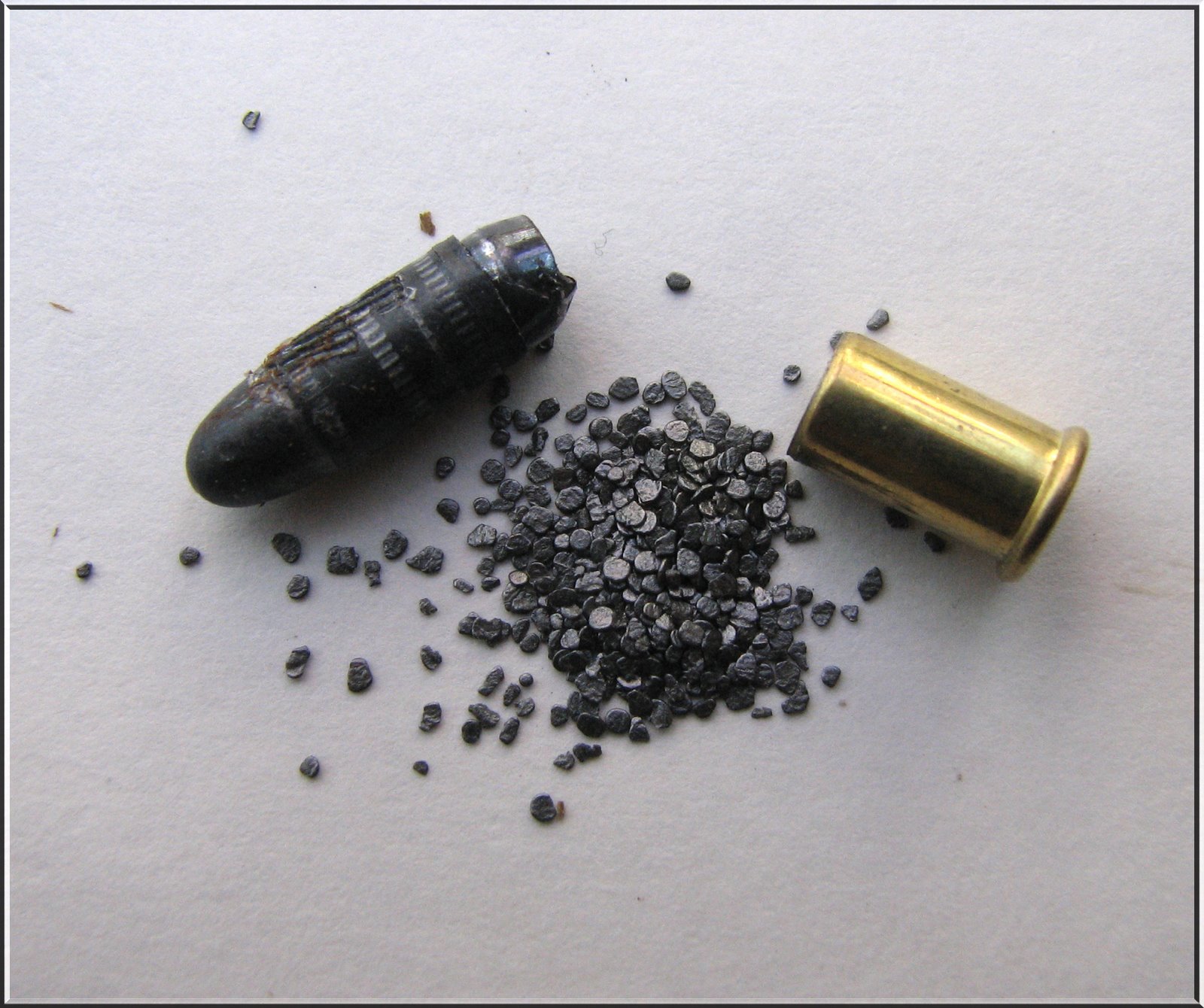

    At present 60g bullet could add better BC to same MV , at present only such ammo is Aguila 60g subsonic sniper ,designed for use in silenced firearms , the big issue is needing a faster twist rate to stabilise making the round not very usefull in miriyad of standard .22LR rifles.
    Making quality rifmire ammo is near voodo magic in comparison with making good centerfire ammo so don't expect any moves ,except some crazy dude handloading something in his shed.
