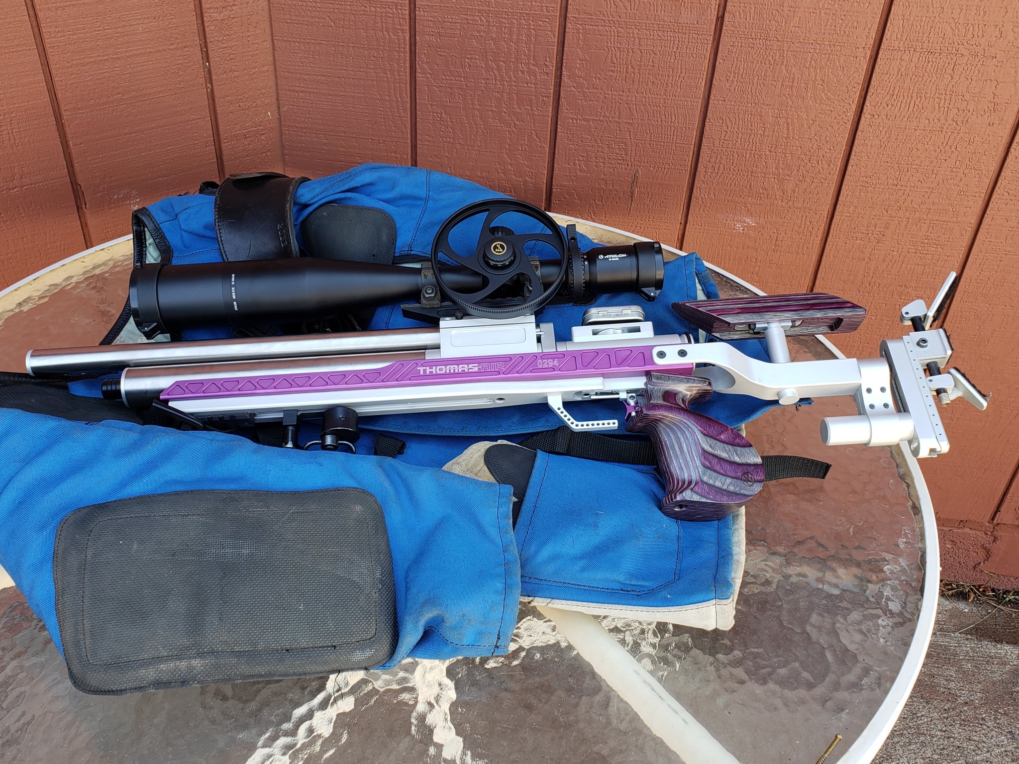

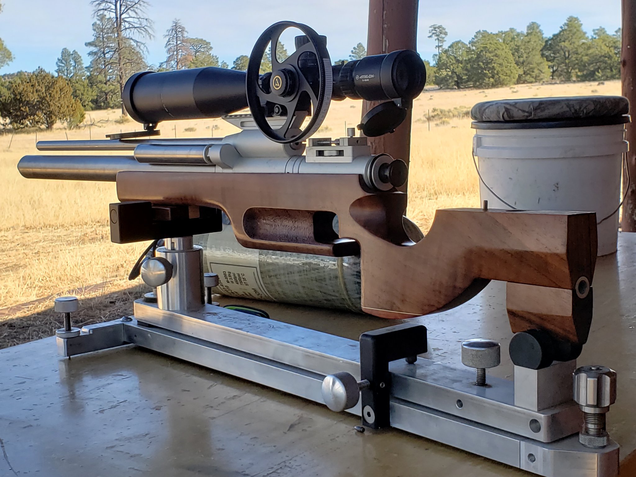

The Athlon Ares ETR 15-60x56 is more of a target scope because its SFP. And it only comes in MOA with half MOA hashes and a daylight bright small center dot. MOA is correct on 40x. I was surprised when I compared it to my FFP G2 Cronus because this ETR, which could be considered a G3 Athlon scope, has superior Image Quality. It doesn't start to dim until 42x or so. A very impressive target scope regardless of price.
For paper and self spotting its a great choice.
Nope its not a scope for dynamic shooting.
Here's mine.
