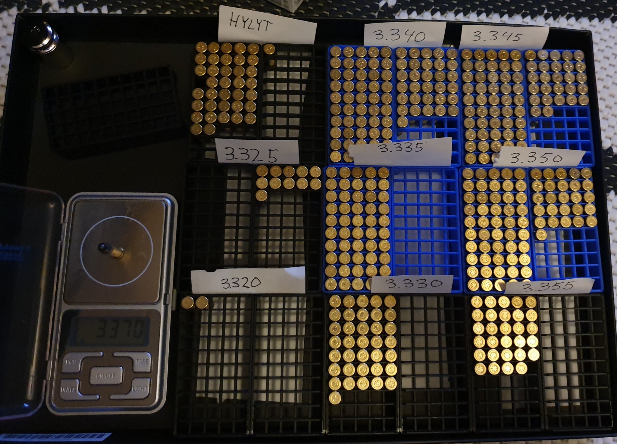

    We will test weight and rim measured ammo. A topic which I have found to have info with big variety of conclusions and I have never run into test results with good background data.

    I have now sorted 400 SK Biathlons into weight classes of the smallest degree I can get (0.7gr) I started to sort them by rim but facing challenges.
    I measure rim by putting them inside 223 casing and then measuring the end that does not fit in but could not find a casing that had an even enough bottom.
    I will try to sand one even.
    I also have a tool to measure the rim but it gives analog results and is prone to give erranous readings if too much force is applied. I do not like analog as it is not an absolute value and it is hard to categorize small variations. For my personal use it is fine. I learned to use it quite well and figured I can do one test run of one weight class to test tomorrow since I have still few of them left.
    When weighing the rounds I tested the calibration every 20ish rounds or when I restarted the scale.
    All in all I did maybe only 3-5 recalibrations, it did quite well. I was not very interested in recording the weight class overall variance but the overall weight varied from 3.315g (51.12gr) to 3.375g (52.04gr).
    I can still make full variance study but the outliers are so scarce that there are not enough rounds of the same weight to make anything useful of them. But maybe a statistic calculation on an excel would be neat as it could be used to determine the average quality of lots when compared to future lots to be tested.

    @justin amateur what is your rejection rate with SK products? What about Lapua?
    Do you test how tight the bullet is crimped or any other qualities?
    @rth1800 Do you have any habits of sorting?
    I could not perform rim/weigh sorted test yet, I need more time to test reliable ways of rim-sorting.
    A tool to test rim to ogive could be the best, but lets get this test out of the way first.
    I have tried weight, visual inspection and rim thickness sorting. It was tedious and my results indicated in cheaper ammo, I ended up with one round lots that always shot one hole groups.?
    Eley Match and Eley Tenex I could not tell a difference.
