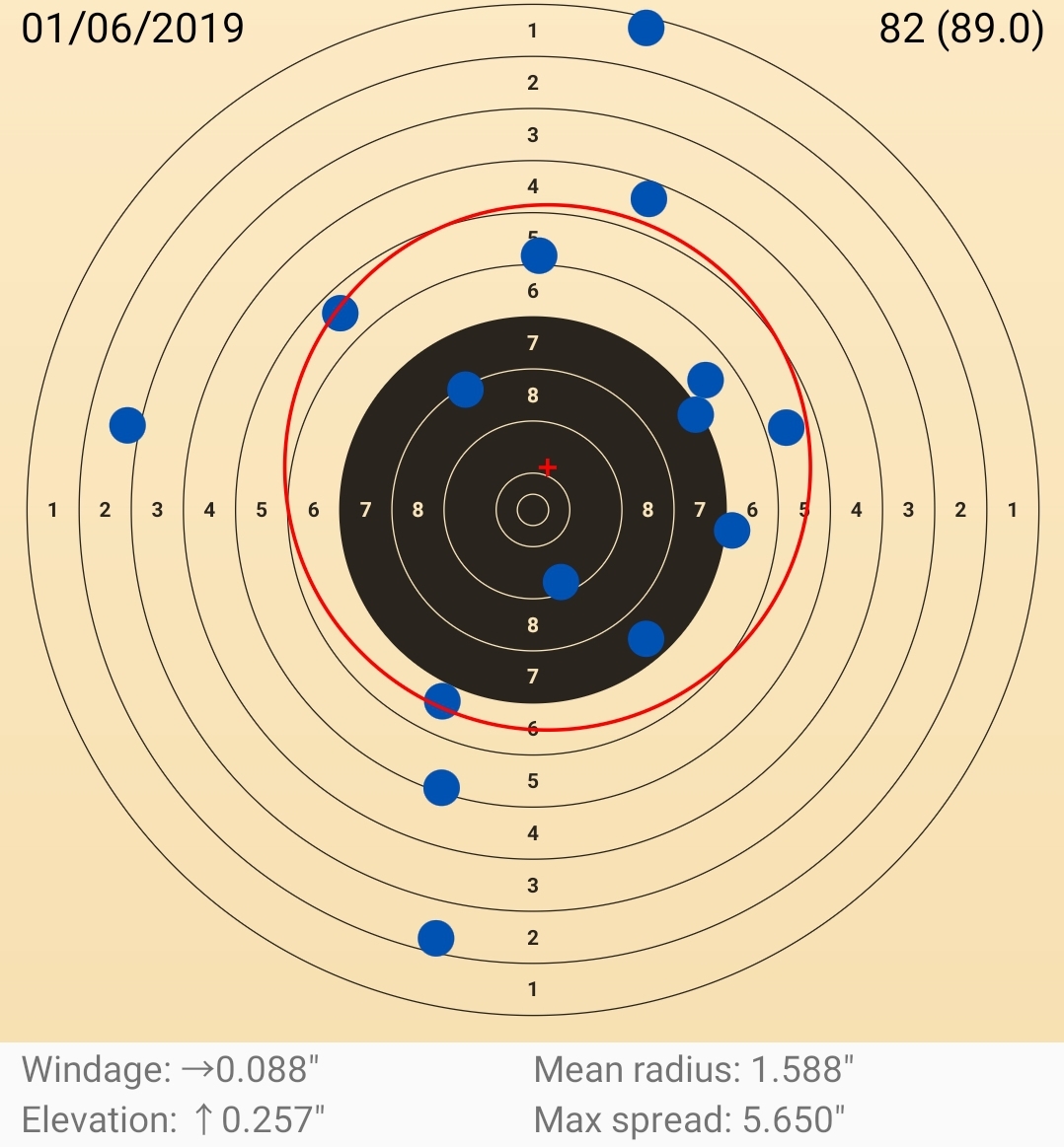

Rick, I hunt with rimfire.
The rest of what I do is explore the limits of the cartridges.
I push it well beyond it's intended usage.
When I order a new case of 22lr, I take 3 or 4 boxes from the order
and use this target to determine the limitations of the batch.
I set up on the bench and at 25 yards, see what happens for 30 shots.
All 1's and 2's means it's good enough for small game out to that distance.
If it produces 3's it's crap ammo useful only for my single six with iron sights.
I'll repeat at 5 yard increments until 3's start showing up.
That informs me of the limits at which I can trust the ammo to hit where I'm aiming.
If I get a batch that hits inside the 2 ring at 50 yards for 30 shots,
it gets saved for use during friendly competition at the local range.
Doesn't happen often. :(
