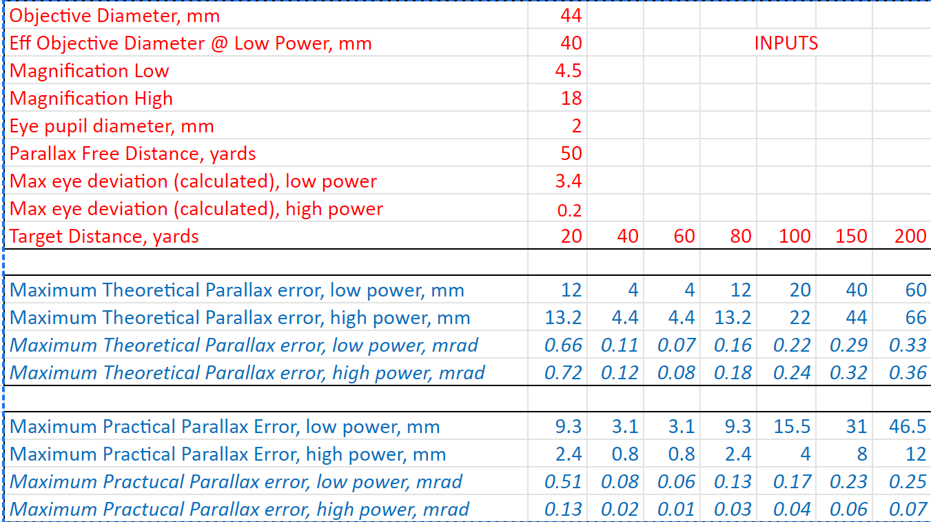

Years ago I made a somewhat crude parallax calculator. I dug it up and made this snapshot. This is for a 4.5-18x44 riflescope set up to be parallax free at 50 yards and assuming a 2mm eye pupil (broad daylight):
7059413
Keep in mind that I made this a long time ago, so I do not remember offhand all the assumptions I made. It should be fairly close, but do not take it as gospel.

Thank you ILya, the amount of genuinely useful information on tap here never ceases to amaze me.
Ah, I see how reducing magnification could reduce parallax error due to "effective" objective size, thanks!
