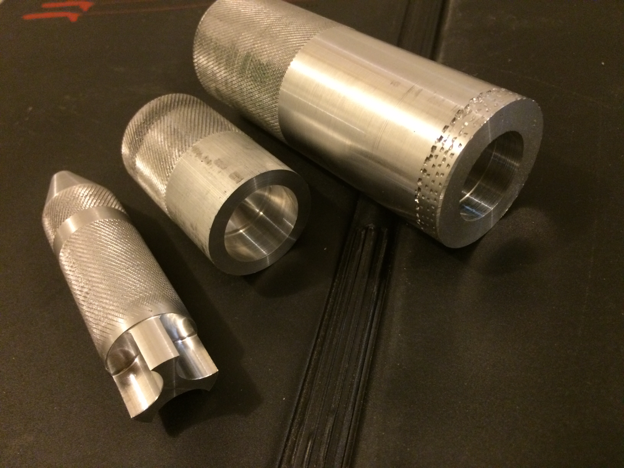

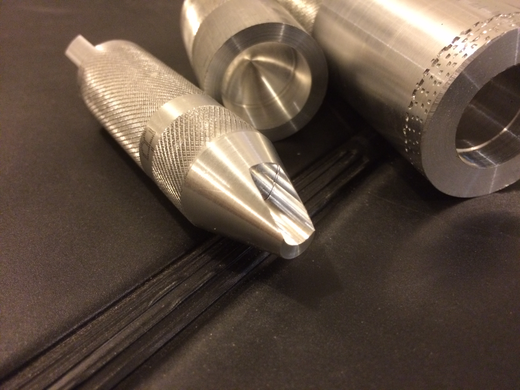

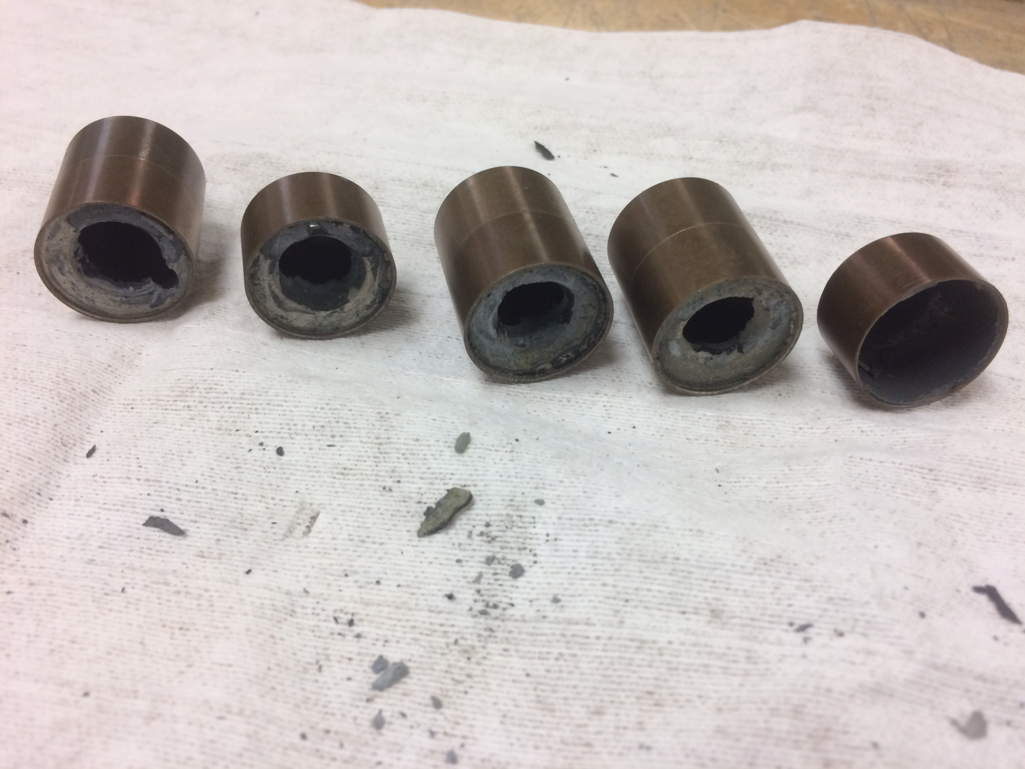

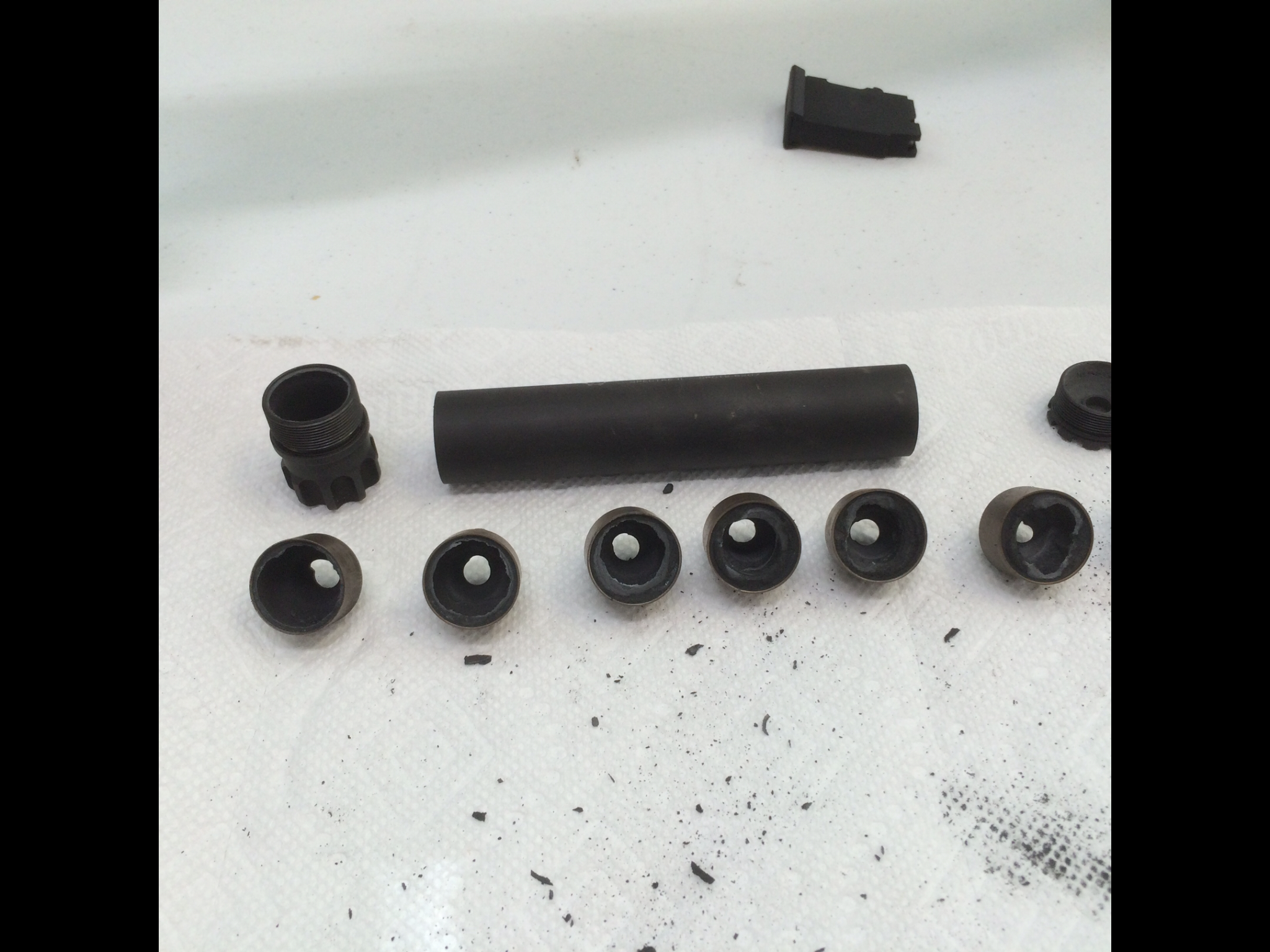

Spectre II internals at around 1800-2000 rounds. This was a bitch to clean and pissed me off enough to fabricate some hand held mirror image aluminum scrapers and holders for future cleanings. I am not a believer in the “dip” or boiling in vinegar as lead acetate is a toxic hazard I don’t want to be exposed to.

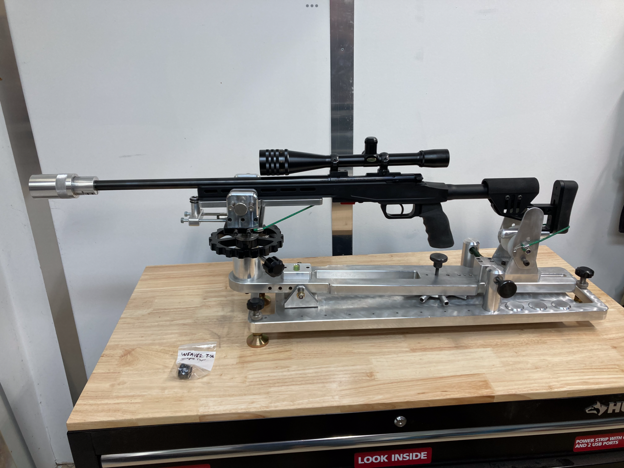

Tuned anschutz 1710 results at 50 yards indoor shot off one piece rest setup, final tune. Documented in @jbell 6x5 rimfire thread. Groups are 5 round groups and took about 3 hours and around 350 rounds of testing as I did neither the purdy or hopewell methods and just ran every setting on the tuner. Amazing what moving the tuner weight .030” will do to group size.

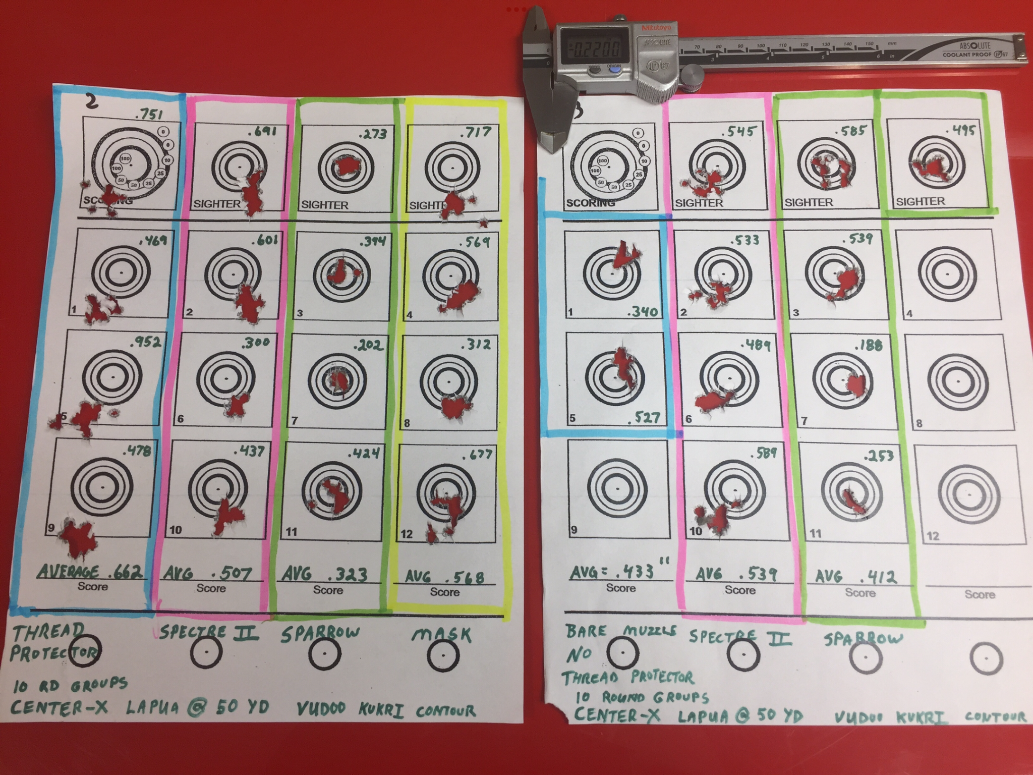

Suppressor tests off same rest and indoor range but with a kukri contour vudoo. Groups are 10 rounds. As in the previous picture the measuring calipers are set with a .220” zero. Thread protector, bare muzzle, and 3 different can results grouped by color. Not a particularly good batch of center x ammo for that rifle, but was what I had at the time. That rifle liked eley force a lot better. However, you can draw your own conclusions.

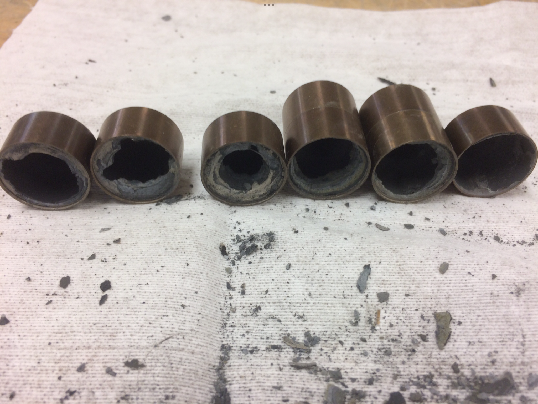

Apparently I’m in a yappy mood tonight. A couple more pictures of the one piece rest used for these tests for both the anschutz and vudoo. And a couple more of just how much crap accumulates in a rimfire suppressor and the tools I made to hold and scrape the spectre baffles. These are to show the precision used and just how much your can is going to change in weight. If .030” of an inch made that big of a difference in the previous post, imagine what all this lead carbon crap is doing to your harmonics.
Those are some fancy tools! Ever thought about selling a set? I have switchback and sprectre 2 I use most often. Usually after a couple hundred rounds I put them in the wet tumbler with ss pins. It cleans them up pretty good but I don't let them get that bad. I have quit wet cleaning aluminum baffles in the tumbler with pins as it removes aluminum too.

I do clean mine, and I don't wait for thousands of rounds - if you clean it every 3-5 hundred it is easy as you don't have a ton of build up.
